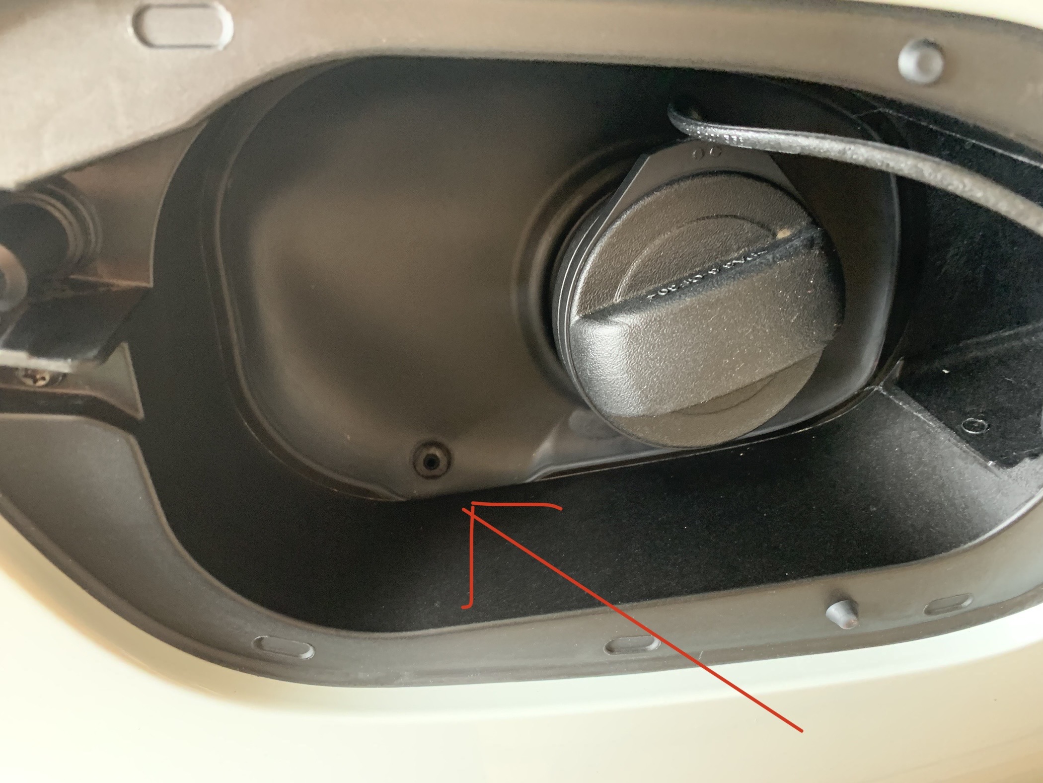

Hi Guys
my recently acquired 2020 Polo has decided to accomadate rain water inside the fuel filler flap area. I have not looked at this fully yet - but notice that other models in the VW range apparently have a drain hole that often gets blocked. Is there such a hole on the Mk 6 Polo? Or is there a 'mod' that needs to be done?

Yes, there’s a drain hole - see picture below.
Any water in the filler flap area should drain to the outside of the car down a flexible plastic tube that’s attached to the reverse side of the drain hole. As far as I’m aware, the tube runs from the drain hole, down in the void space between the right hand rear wheel arch liner and wheel arch, and it exits behind the rear wheel. It’d be worth checking the exit end of the drain tube as well to ensure it’s not blocked.
If you’re planning on using some type of probe and inserting it into the drain hole in the fuel filler cap compartment to clear any blockage, be careful the drain tube doesn’t become detached!

Yes mk6 does have hole in this compartment and by my experience it gets blocked way too often. I have trimmer string (used for cutting grass, made from plastic, about 0,75mm thick) in car and once in while I poke through until I see it belove car :)

thanks Guys, checked and found hole. It was completely filled with crud, level to plastic case. Have done the necessary and BINGO.
