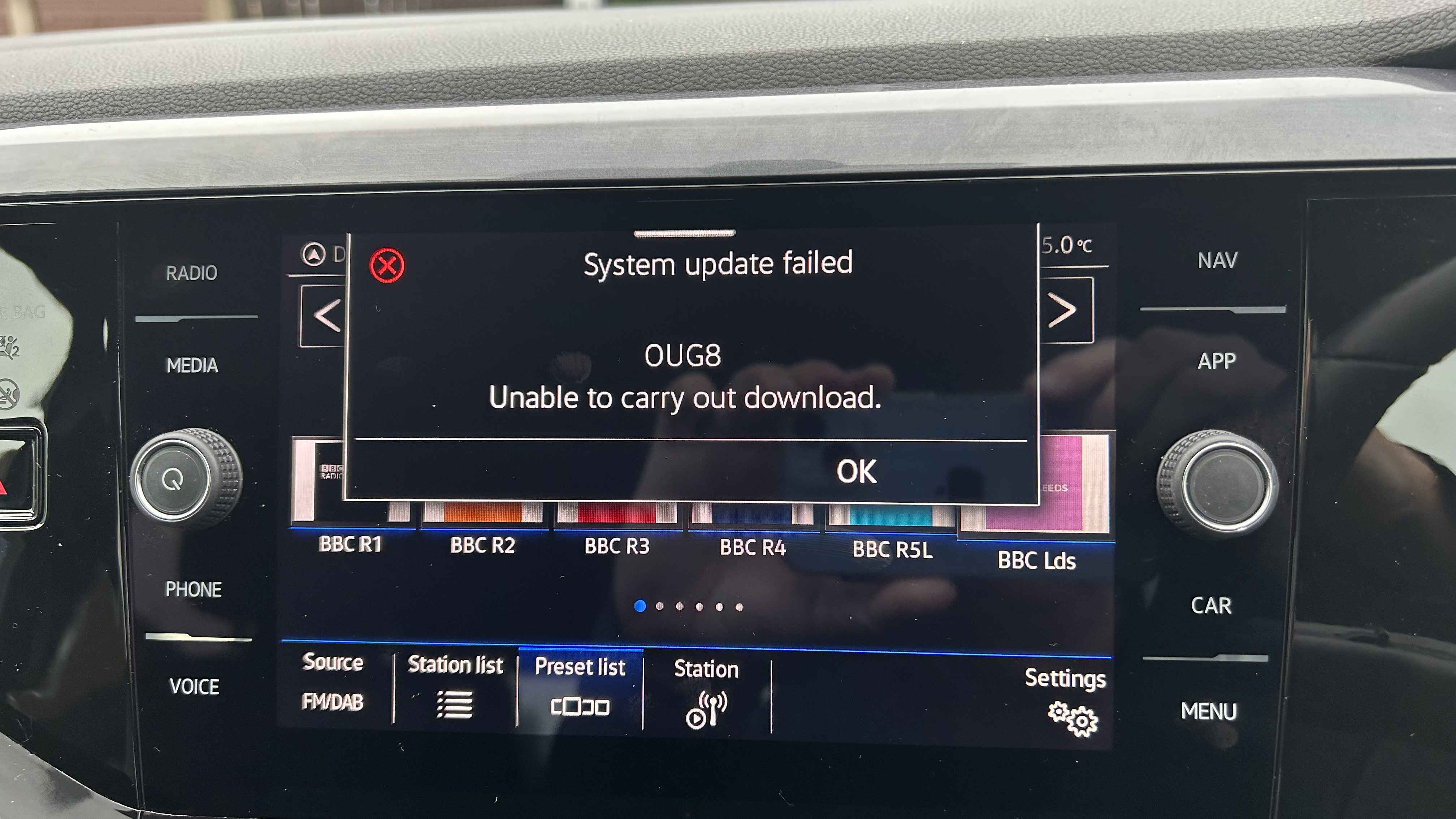

This morning I received this message…
- IMG_6109.jpeg (2.03 MiB) Viewed 11245 times

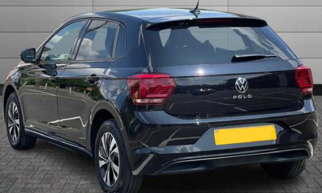

I think the last of the pre-facelift cars may have got some of the tech of the facelift model. If so, then that might explain why @RealInsky’s 2021 pre-facelift Polo gets OTA updates.
The last of the pre-facelift Polos cars can be identified by the position of the ‘Polo’ badge (or for the GTI, the GTI badge) on the tailgate; centrally positioned under the VW emblem on the hatch release handle rather than in the bottom left corner. The font used for the badge is also the current style used by VW; see picture below.
The last of the pre-facelift Polo GTI’s also got the facelift GTI’s 7 speed DSG rather than the 6 speed DSG, and the facelift car’s engine power uplift from 200ps to 207ps.
