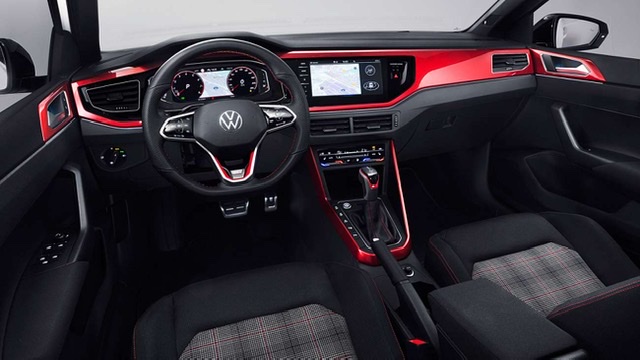

OomStu_ZA wrote: Sun Jul 30, 2023 1:48 pm I agree with your last comment re IQ headlights but still find the rear lights (now stretched over the tailgate) fugly. The haptic feedback is also a no no from me as well as that clown steering wheel. Once you see it you cant unsee it :P
Agree; VW clown face steering wheel (with the instrumentation dials being the eyes);
