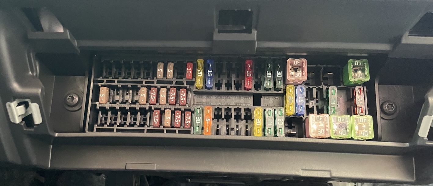

I have the same issue with my 2017 Polo.
The front windscreen wipers won't shut off, even in the stalk 'off' position. When I stop at traffic lights, they mysteriously stop, only to start up again when I set off!
Can someone please identify which relay (under the steering wheel) relates to the front wipers?

- Posts: 9037
Re: Windscreen wipers won't turn off
The problem is usually caused by premature wear of the Integrated Circuit tracks where the lever switches slide.
Thank you.
Just going through a process of elimination. It's an annoying problem!
