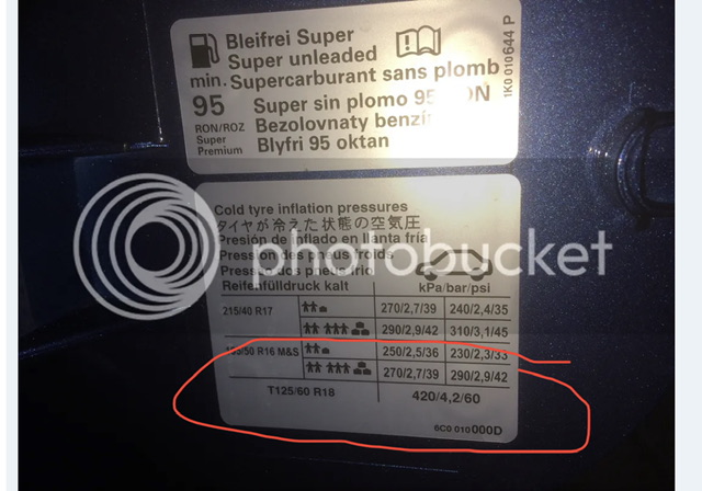

Tyre pressure for the spare tyre should be shown on the tyre pressure label on the inside of your car’s fuel filler flap.
This is the tyre pressure sticker that was on my previous Polo - a GTI. Pressure is likely to be different for your car as the wheels / tyres are a different size. The space saver spare tyre pressure is at the bottom of the sticker;

Not on mine, checked there first.

Also check the lower section of the driver’s side B pillar; that’s the location of the sticker in the AW / BZ Polo.
Try an internet search on ‘VW Tyre Pressure Sticker’ and you’ll see from the images that the tyre pressure for a VW space saver spare irrespective of car or space saver size seems to be 4.2 bar / 60-61 psi.
60-61 psi sounds very high but it’s probably that high as I dare say few owners regularly check the tyre pressure of the space saver spare, and over time there’s a good chance it’ll lose some pressure. If it’s inflated to 60/61 psi then it reduces the risk of it having lost too much air over time to render it unusable when it’s needed. If it has, then if you carry a 12v portable mini tyre inflator / compressor in the boot of your car and a tyre pressure gauge, you’ll always have the means to re-inflate it if necessary.

I'd stay away from using 61psi on "smaller than fitted spare tyre", I have noted down 40 > 42psi for the spare on my wife's 2015 VW Polo 1.2TSI 110PS SEL, the 61psi is only used on the proper space saver type tyres, ie the really slip ones with very little thread depth.

Ans yes, VW didn't seem to bother to include the pressure for the spare tyre on the pressures label on the inside of the filler cover.

B pillar label only references the TPMS, no pressures there.
I guess VW were just too cheap to provide the correct size spare for the SEL (16") & probably the GTI (17") too. The 185/60/15 being standard for the rest of the range, there was no need for additional pressures as it would be a like-for-like replacement using default pressure.
I agree that 60 PSI would be way excessive.

Maybe I should have been a bit clearer when I said what pressure to use with that "smaller than fitted" spare wheel, the pressure I gave would be a safe storage pressure, ie to get checked every year at service time, and when actually needing to use that spare wheel, ideally only on the rear of the car, adjust the pressure down to what you normally use at that point on the car.
