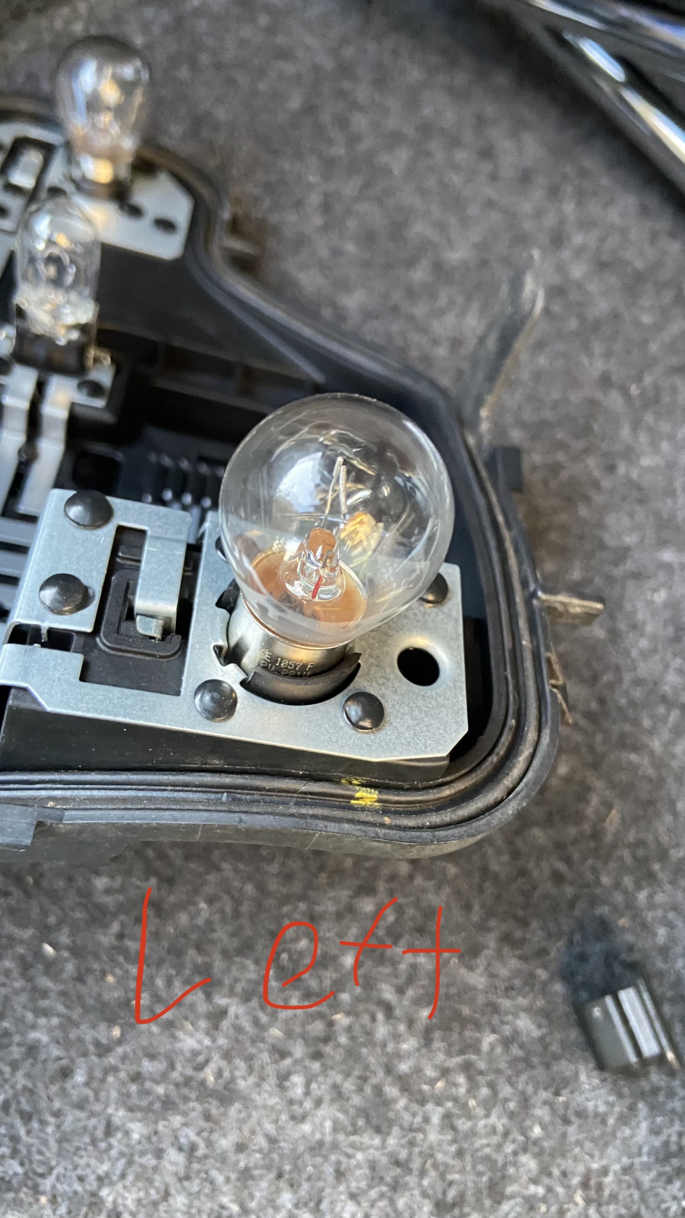

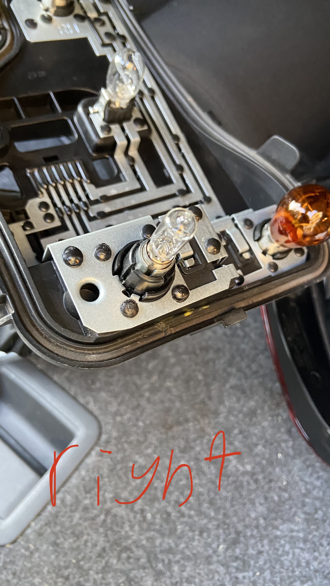

I’ve got a bit of a weird issue. My rear right fog light (the one next to the indicator) isn’t working, whilst the rear left fog light works fine. I have replaced the bulb, but this hasn’t worked. I haven’t checked the fuses, but I can only find a reference to the rear fog lights being on the same fuse line, so the fuse wouldn’t be blown if one of them (the left one) still works.

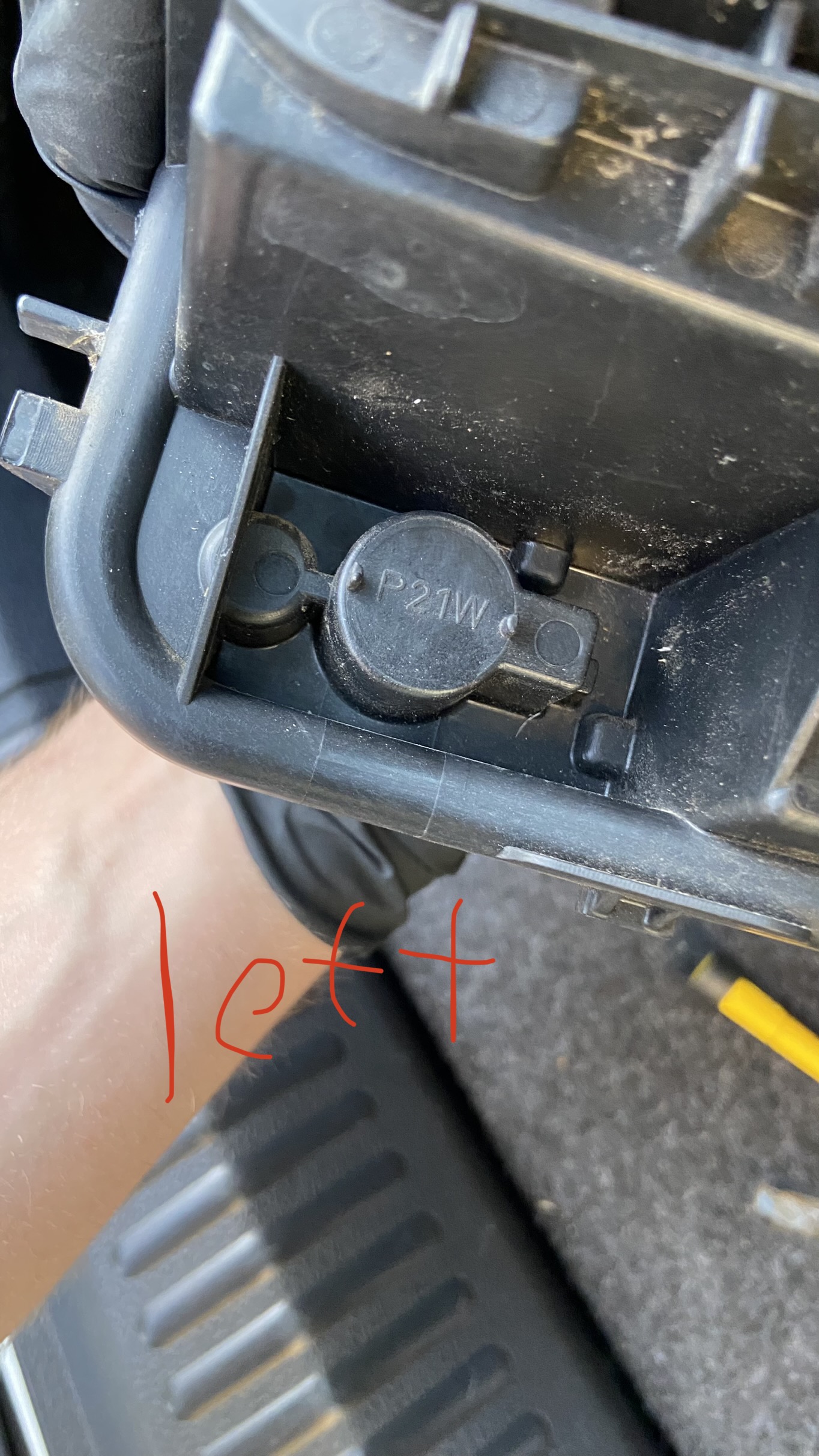

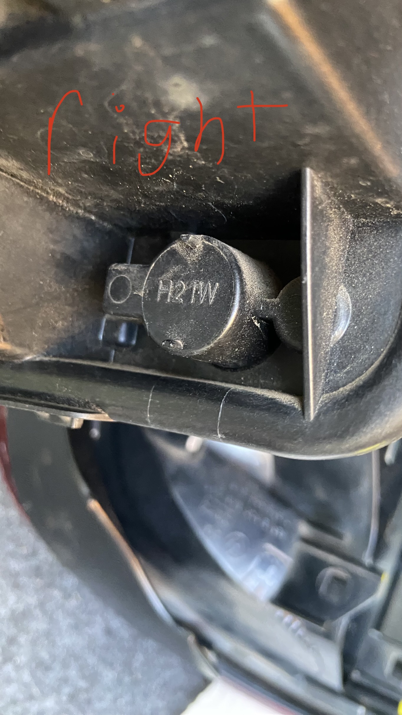

I’ve noticed that the rear right fog lighting is a completely different bulb H21W whereas the rear left fog light is P21W… which I think is weird. The H21W bulb (on the right side - the broken side) has a weird plastic seat that the bulb sits in which itself is sitting in the bulb socket.
I’ve attached some photos. Does anyone have any idea of what’s going on here?

what do you mean, rear left fog light?
if you're RHD, assuming you're in australia, it should be:
left side (passenger side) is the reverse light
right side (driver side) is the rear fog light
unless you modified something, you'll only have one reverse light and one rear fog light
did you ever mess with the lights or changed the light clusters?

Oh what! I am in Australia. I didn’t know that was even a thing… so that’s why the bulbs are different. I haven’t changed anything inside the light clusters besides cleaning them and replacing the rear right fog light bulb, which I assumed was broken. I was testing if the lights worked in reverse mode so that’s maybe why the rear right fog light wasn’t lighting up (whereas the rear left reverse light did work - which makes sense because you say it is a reverse light). I’ll try and enable the fog lights tomorrow and see if I can get that rear right fog light to work.
