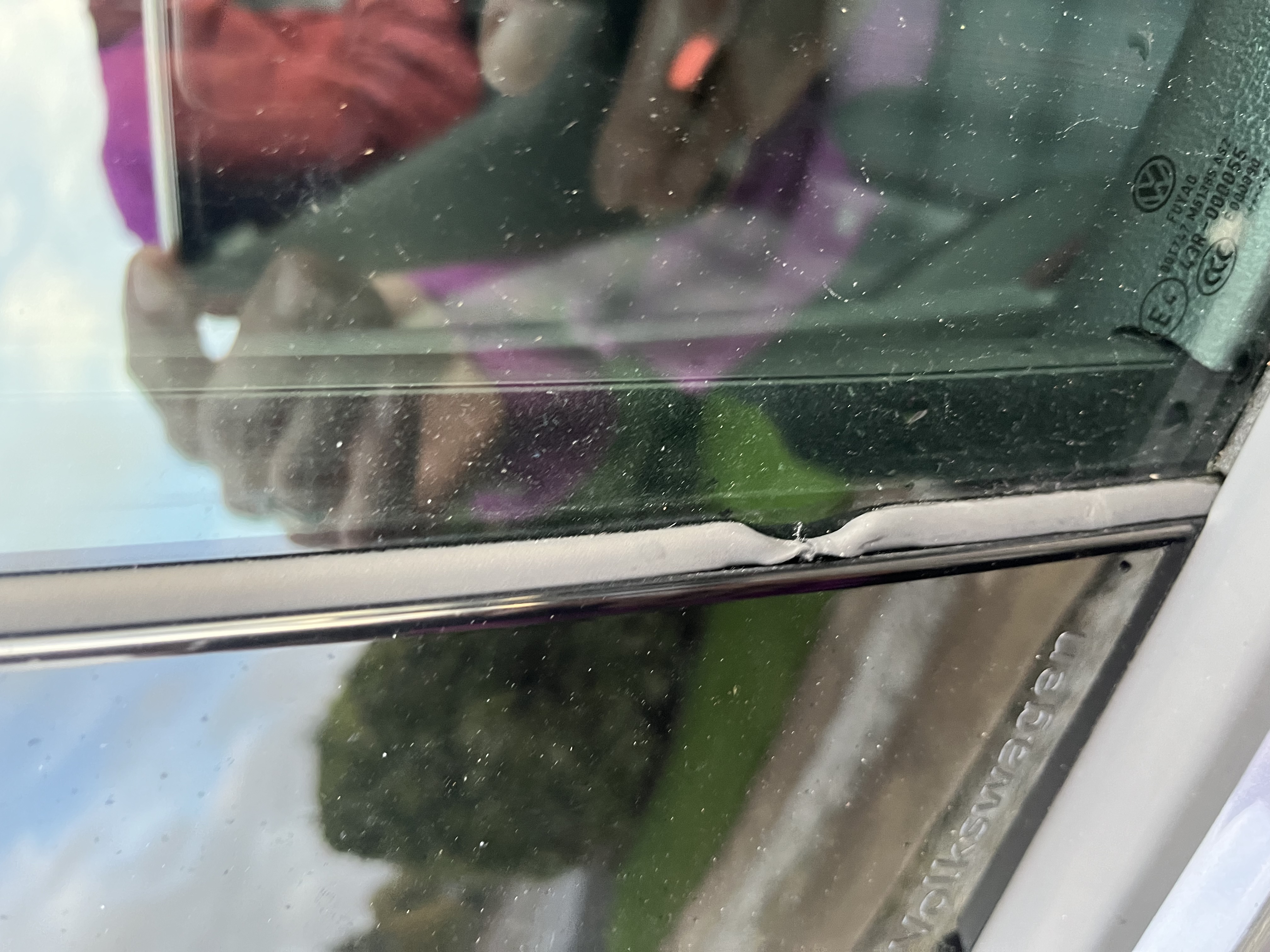

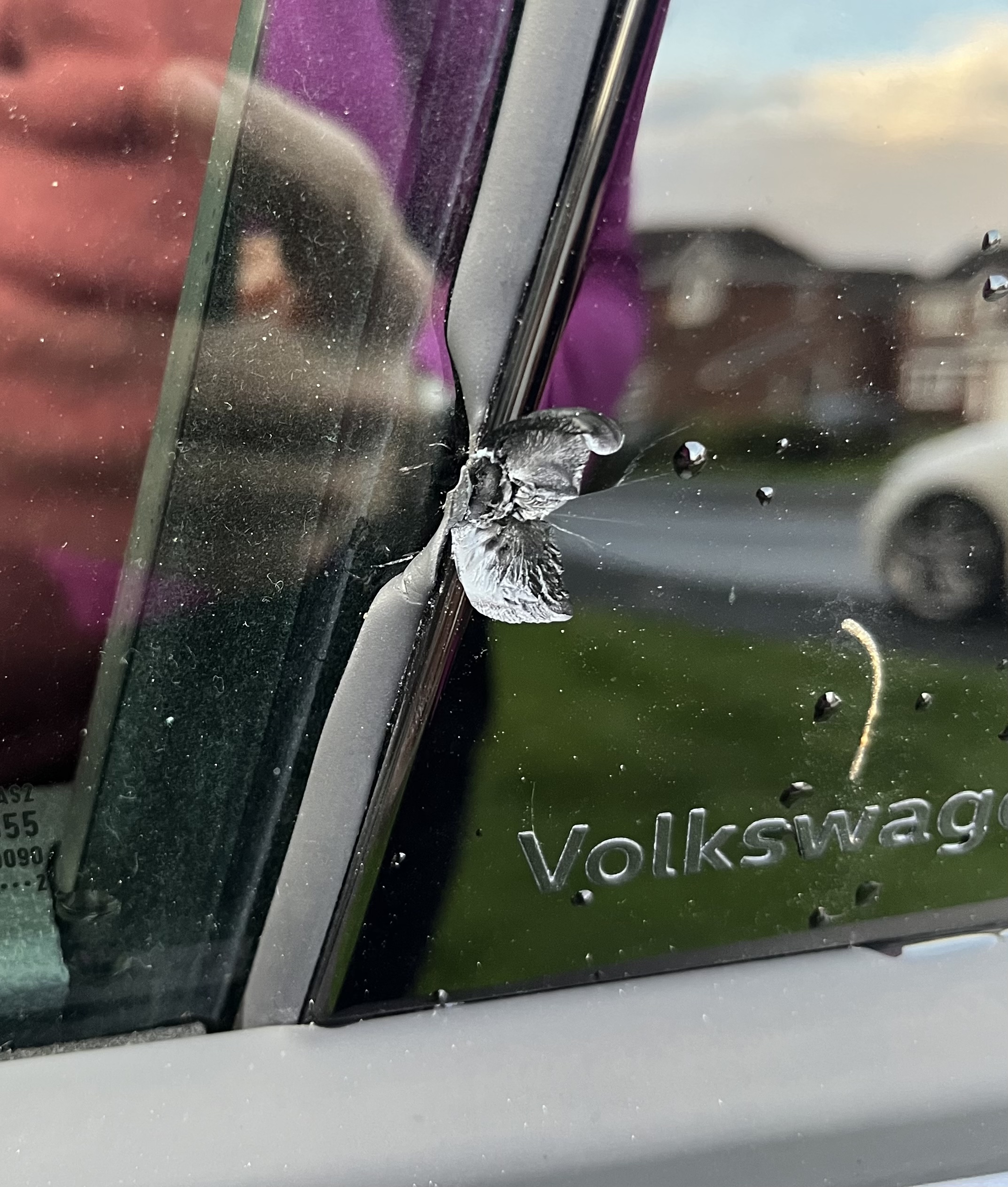

ImageHi everyone
First post, unfortunately not for the best reasons.
My car was parked at my local train station car park today and someone seems to have attempted to break into it.
Not sure what they were trying to achieve but they have caused damage to the gloss black trim around the door.
On the other side they’ve tried the same but damaged the rubber, the plastic seems unaffected. I’ve c attached a picture of the damage.
Does anyone know how to get the part numbers and how easy it is to swap the trim? It’s a 2022 polo gti.
Many thanks

It looks as if it’s the trim on the front door(s) that’s been damaged. Assuming yes, the gloss black B pillar trim looks to be no.35 on the diagram at the link below. There are different versions, but I’m assuming it’s the ‘trim with lettering’ version (with ‘Volkswagen’ at the base of the trim panel) that you’d need. There are a range of part numbers for that specific item of trim, so it’d be best to check with your local VW parts department to make sure you get the correct part for your year and model of car.
The rubber looks to be no.6 on the same diagram - described as ‘window guide’. Again, there appear to be a range of part no’s. for this part, so again best to check with your local VW parts department to make sure you get the correct part for your year and model of car.
https://www.lllparts.co.uk/catalogs/vw/ ... 837/837060
Sorry, I don’t know how easy it would be to change the trim or rubber, or if any special tools would be required. It might be worth doing a search on YouTube to see if there are any ‘how to’ videos. The Golf has the same type of trims so if there aren’t any videos of these trims being removed / refitted on the Polo, there maybe some for the Golf. If it’s not a straightforward job to do then it’d be worth asking the VW dealer what they would charge to do the job, and also ask a few independent body shops in your area what they would charge.
