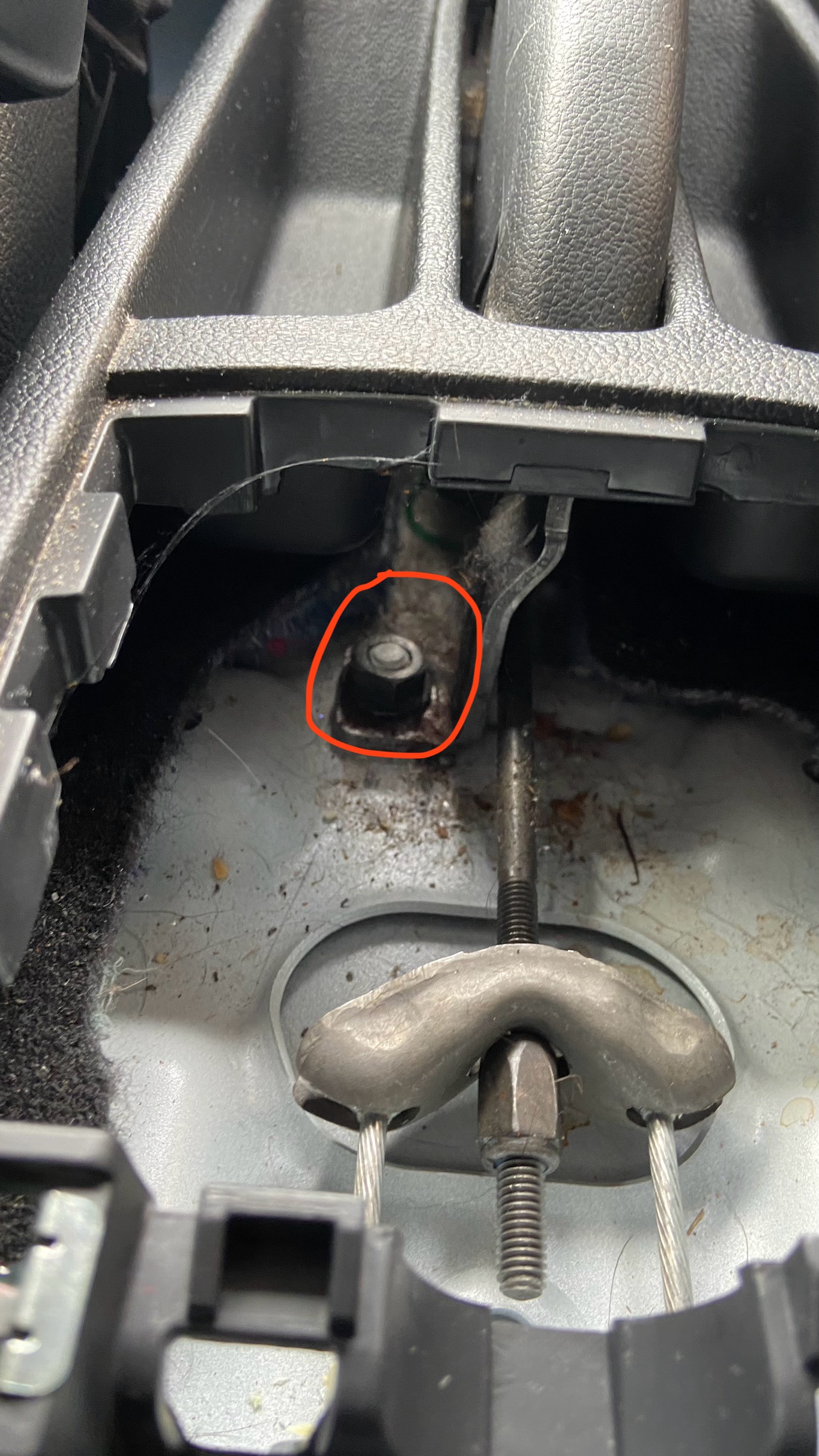

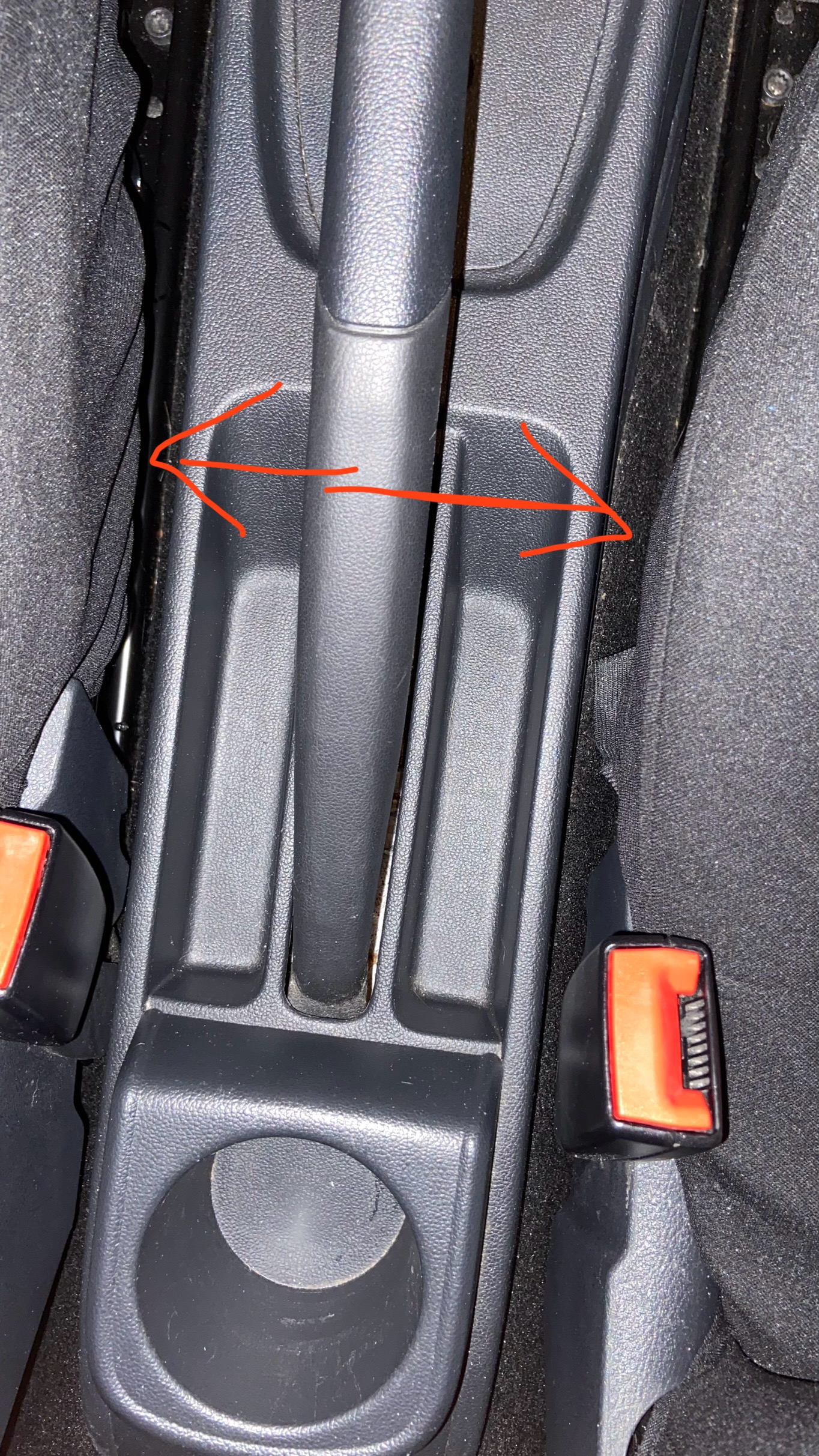

The handbrake on my 2016 Polo has significant side-to-side movement while in the down position. It even exists to a lesser degree in the up position. The side-to-side movement in the down position must be almost 8mm! Does anyone have any ideas of how to tighten the side-to-side movement? I am hoping it might be a loose screw or something similar. I haven’t had a chance to pull the plastic trim surrounding the handbrake off yet. I am planning on doing this tomorrow.

I found the culprit. It was the bolt holding down the handbrake that had come loose. I would like to clean all around the handbrake area… but how do I remove the surrounding plastic?

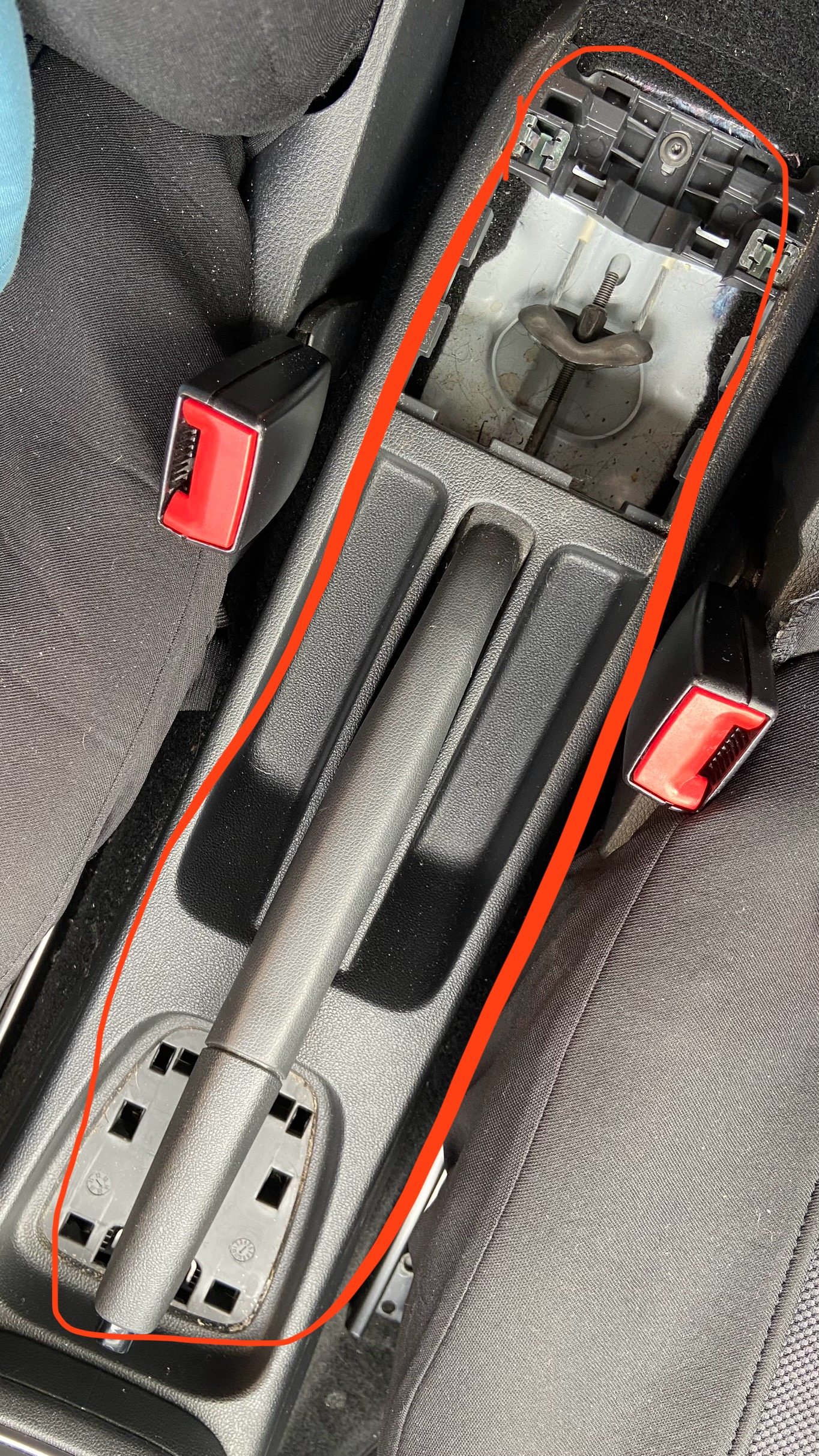

I’ve circled the plastic trim that I would like to remove in the photo. Any advice would be greatly appreciated.

You have to remove several trims to remove the center console.
and small parts that get in the way, e.g. the handbrake cover, etc.
It is possible to remove the push button without breaking it if you do it with care/love and good tools.
