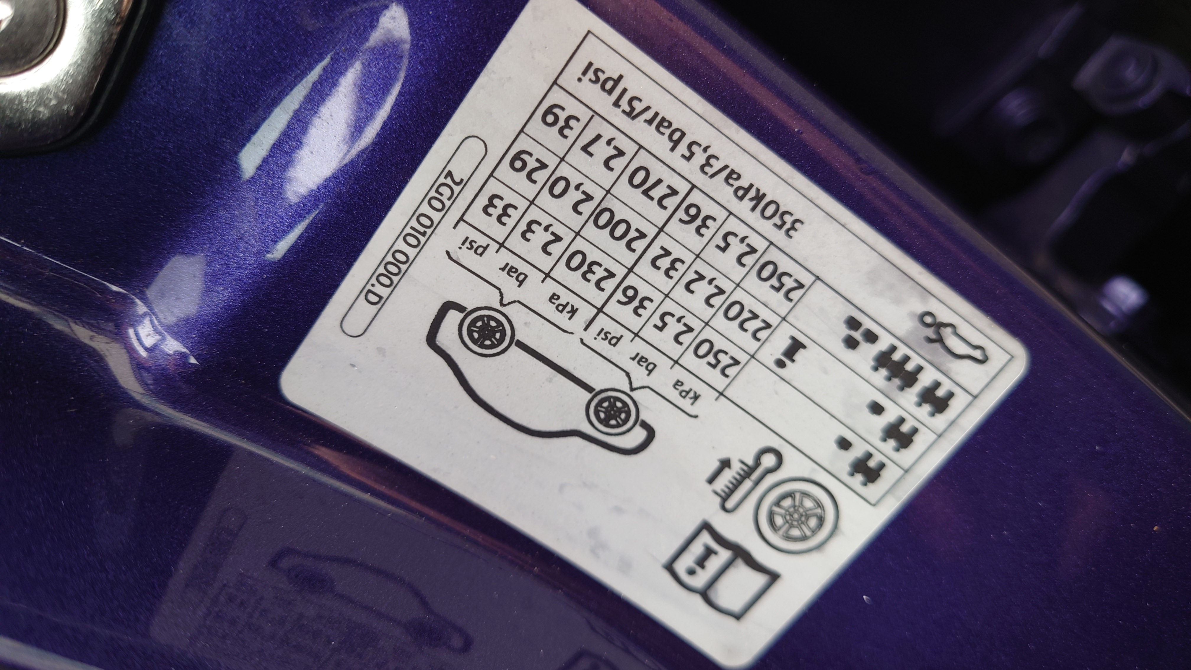

Hi, could some one please let me know what the manufacturers recommended tyre pressures are for a 1 litre Polo with 17" wheels please?
Perhaps publish a picture of the B post sticker?

These are the values in my car 1.0TSI 81kw/110ps

exactly the same pressures sticker for my 95hp version...
don't think mine are 17" wheels... more like 15"
