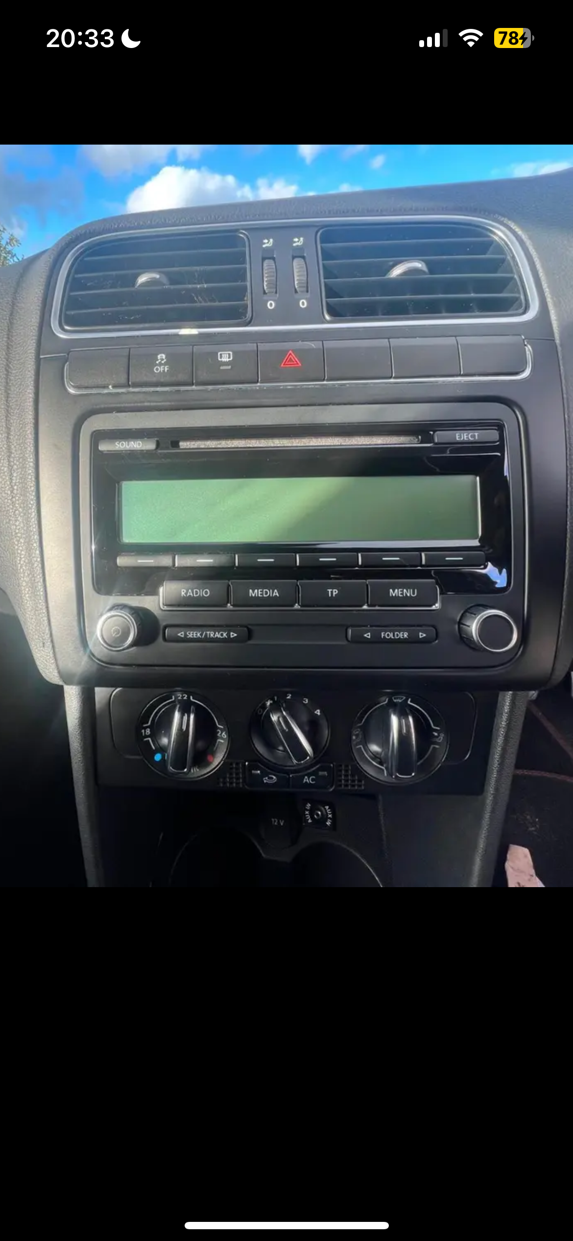

Looks like this, I’ve taken the stereo out and managed to remove all the aesthetic stuff but the unit with the three knobs is what I can’t get out

- Posts: 6695
Re: Replacing Manual Climate Control with New Manual Unit
not really what i was looking for, more the panel you're looking into... but let's try anyway.
remove the front panel and take out two screws from the bottom. then you should be able to move the climate panel a bit so you can remove the plugs and bowden cables.

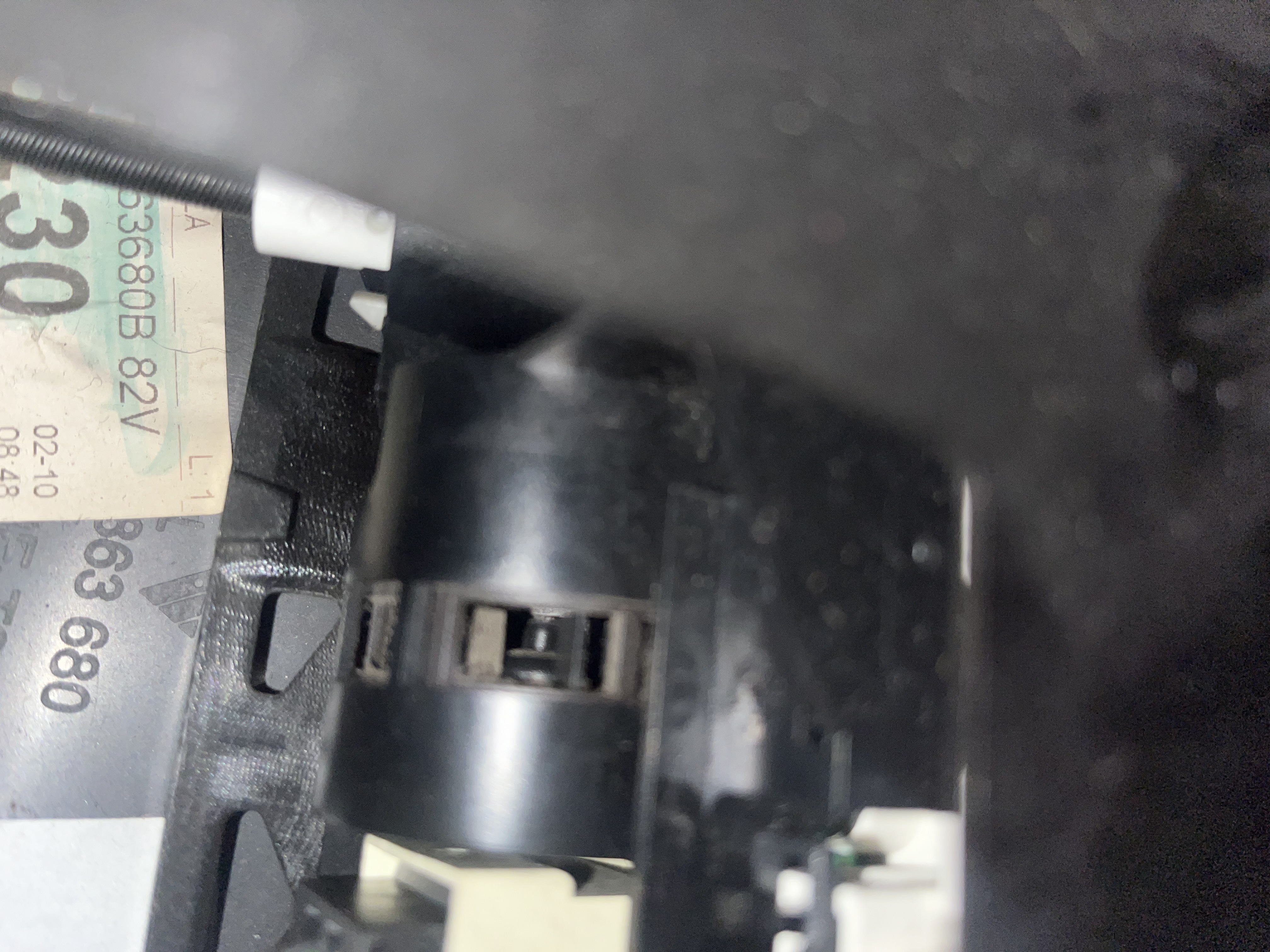

Hi, thank you for your response. I got the two screw out the bottom and the climate control is moving but I cannot seem to get it out far enough to remove the Bowden cables. It’s like one side is stuck and there is not give. I have this picture from when I got to that point (see attached)iichel wrote: Mon Dec 04, 2023 9:00 pm not really what i was looking for, more the panel you're looking into... but let's try anyway.

See here
- IMG_5877.jpeg (3.53 MiB) Viewed 6053 times

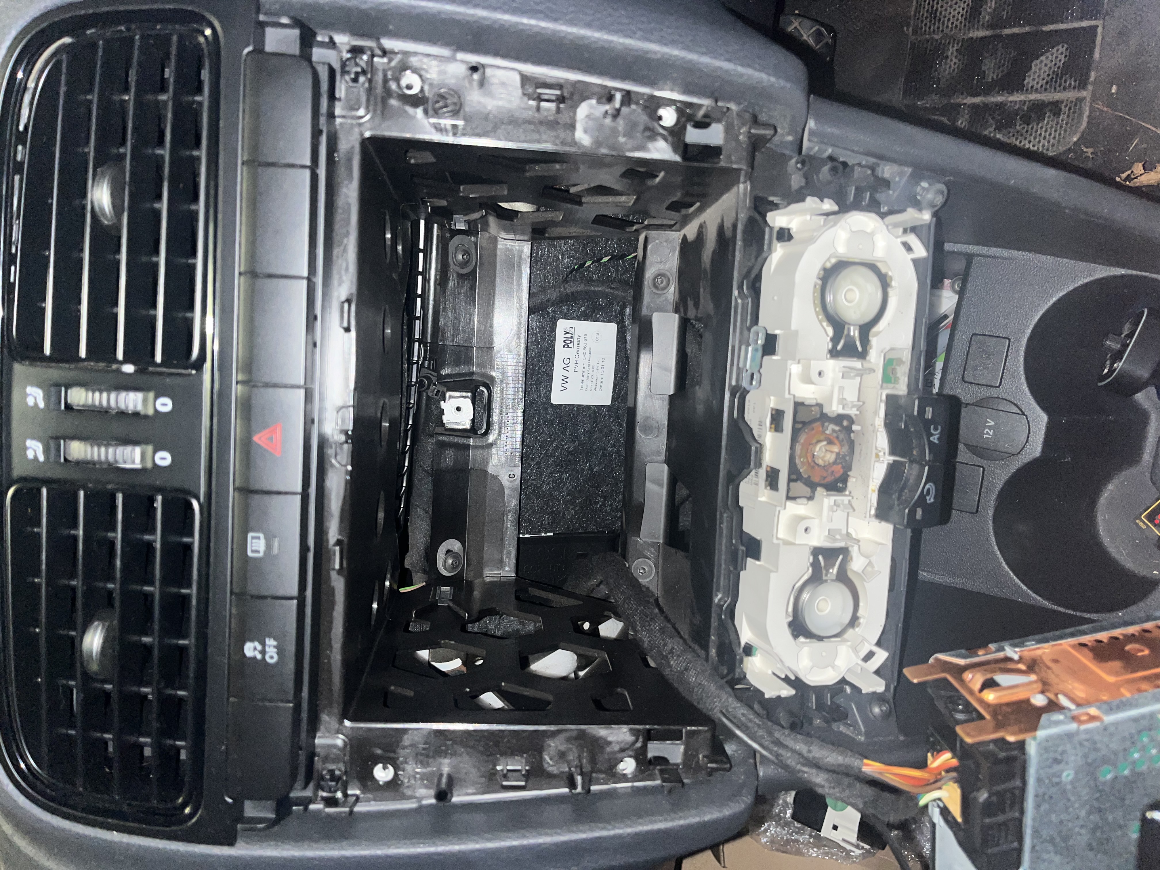

I’ve just managed to get it for you!iichel wrote: Mon Dec 04, 2023 9:00 pm not really what i was looking for, more the panel you're looking into... but let's try anyway.
- IMG_6236.jpeg (3.7 MiB) Viewed 6043 times
- Posts: 6695
perhaps take out the inner frame that holds the radio? i remember the bottom of the radio 'hole' being open but clearly yours isnt.

- Posts: 6695
come to think about it, you don't need to remove the vents but you do need to remove the trim around the gear knob and the top part of the center console.
Polo2010uk
- Posts: 9
- Joined: Mon Dec 04, 2023 7:01 pm
- Drives: Polo 2010 3dr
I see, that might be too much for my to do myself. I’m guessing a garage would be able to do this quite easily? I took it to one and they said it’s something I could do myself…iichel wrote: Mon Dec 04, 2023 10:14 pm come to think about it, you don't need to remove the vents but you do need to remove the trim around the gear knob and the top part of the center console.
- Posts: 6695
I think you can do it yourself, it's not that hard:
- remove gear knob frame (pull out)
- remove two screws below the frame
- remove two screws that are on the climatronic
- push down the two 'lips' near the first two screws
- pull back the top half of the center console
it's this part, takes about 5 minutes extra:
