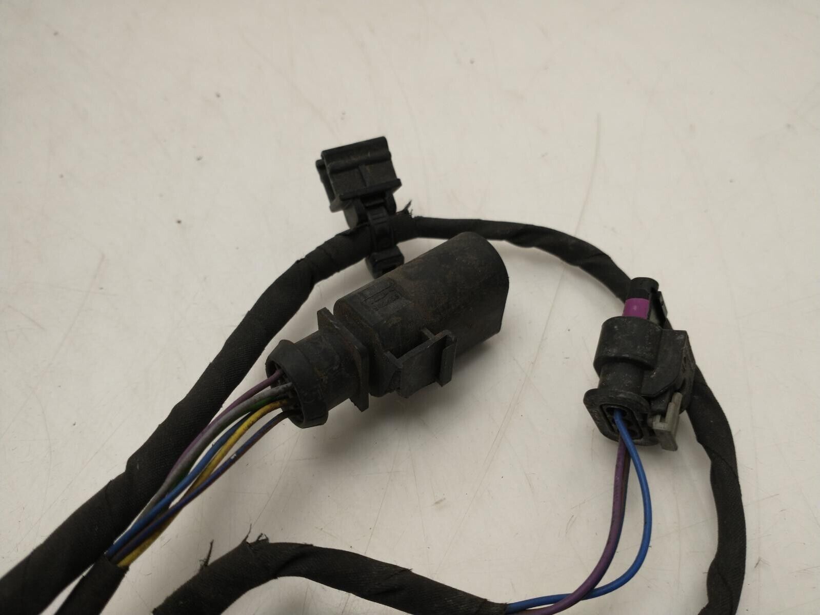

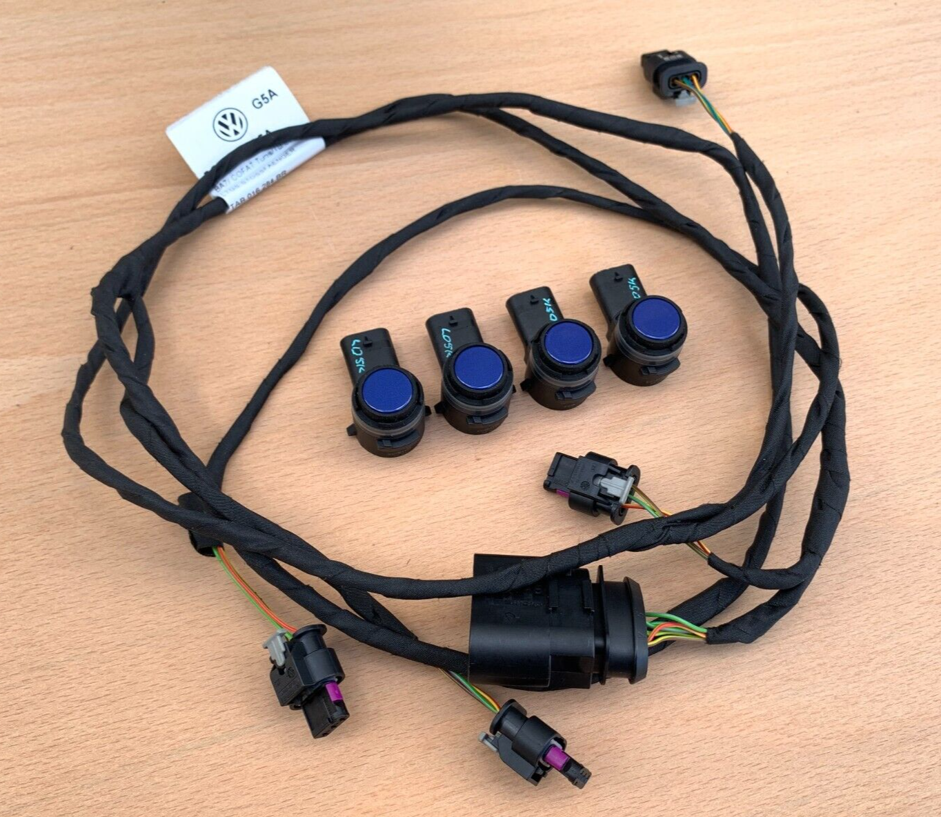

Not meaning to sound cheap with this suggest (well it is!).
The front sensor looms are looking £100ish on ebay while rear are around £40. I am eyeballing the looms as much as I can through images and I can't spot a difference between the rear or front sensor cables.
The front cables from images have 6 wires total. Each sensor end contains 1 unique wire, 1 earth, 1 power. Hence there's a total of 6 wires into the 6 connector (1x4 unique, 1 earth, 1 power). I have attached an image.
The rear loom is playing the exact same game. 3 wires into each sensor then 6 into the plug. The only differences I've noticed are there rears are wrapped in plastic and the front in loom tape. I could just remove the plastic and tape it up and get going surely.
Only concern I have is that the loom could be a dodgy length or be short, can anyone comment if there is a drastic length/spacing difference?

biggest problem with that is that the front loom enters the bumper in the left front corner and the rear loom enters the bumper in the middle. otherwise you can probably convert a front loom to a rear loom no problem.

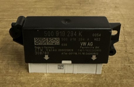

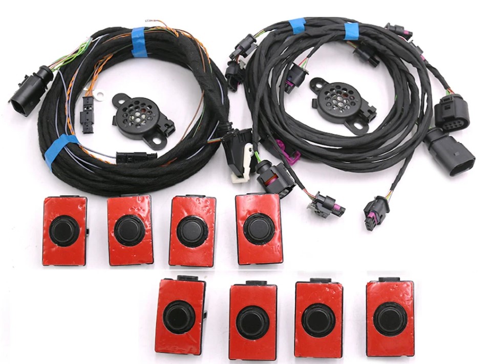

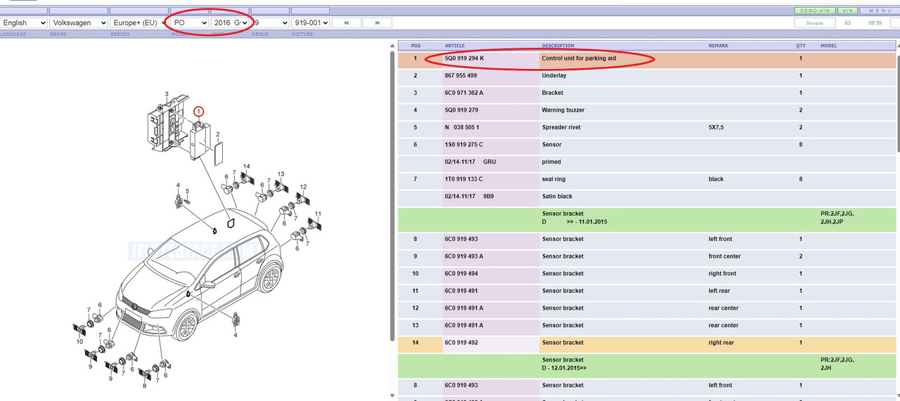

Hello,
i am thinking of retrofitting the 8K to my 6c polo.
I found this kit on Aliexpress it is for Golf7
https://www.aliexpress.com/item/3286378 ... ry_from%3A
The unit 5Q0919294F is the correct for my car. Do you think is it the right kit ?
What about the parameters for my car (this seller says that the parameters are for Golf7)

I communicated with the seller, asking for the set of parameters for my car, but he doesn't have any.
So now i am wondering how to find those sets of parameters. I appreciate any kind of help.
The unit is the correct one for sure. (5Q0919294K)

what about buying a used module from a polo 6c?

I am searching for that, allegro is a nice source for used parts. I found one unit, i am waiting for a response from the seller.

OK, i found a PDC used unit from Polo 6c so i am going to purchase it.
Now i am searching for the rest of the kit, and i am kind of confused. The reason is the electric platform of my car PQ26
I found a lot of kits on AliExpress but i don't know which to choose.
For example this one https://www.aliexpress.com/item/1005005974445544.html
i think is suitable for my car (it says it is for Golf7). Golf7 and Polo 6c has the same PDC unit (5Q0919294K) but not the same parking sensors (at least they have not the same code)
Any advice please ?
Any advice please ?

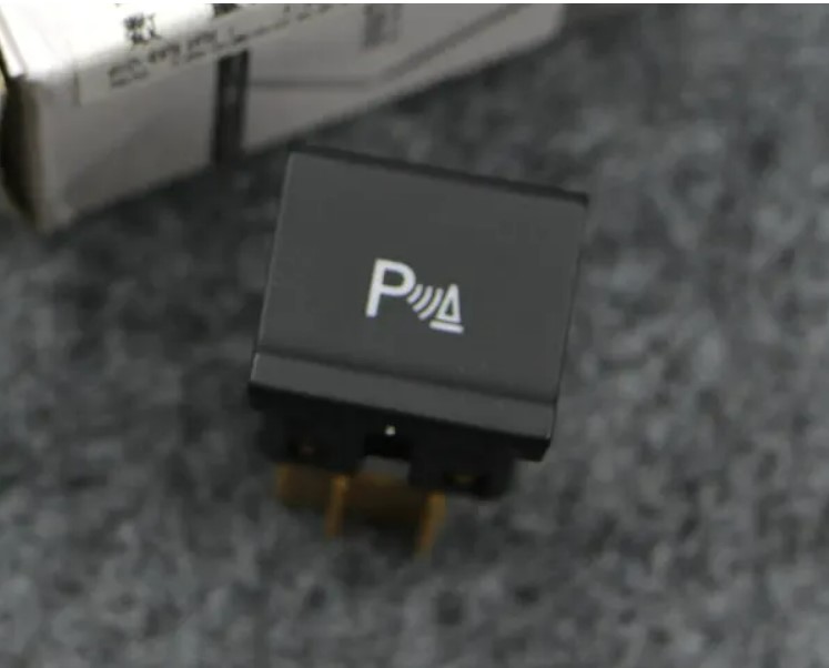

Small update
I ordered an used PDC module
Wiring and sensors from AliExpress
And the switch
Τhe wiring is made so that the position of the module is forward. In Polo, the position of the module is at the back. I will think about whether to finally put the module forward or modify the wiring.
Now i am searching information about coding and adaptations.
And the switch
