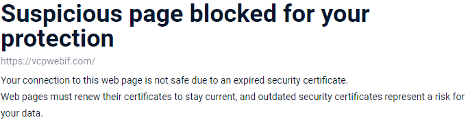

ciclo wrote: Sun Jan 14, 2024 4:43 am As for Chrome, it still detects/says that the website https://vcpwebif.com/ is not secure.
Seems it's a certificate issue on the site, likely lapsing at the end of 2023 or early 2024. That will probably be the cause of most of the trouble you were facing.
VCP Certificate issue.PNG (19.45 KiB) Viewed 2744 times
Click through on the "not secure" bit next to the URL and view the certificate data. My AV keeps inserting its own certificates so can't see the one for the site.
Good to hear you got it working again :D
