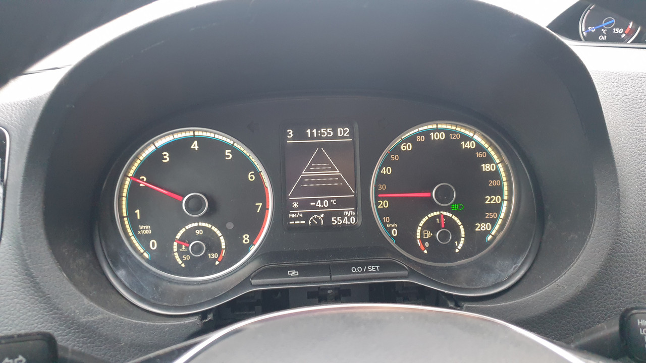

7e0 radar with CP off, but not calibrated yet :mrgreen:
ECU: 1.4twin with passat sw 03C906026BP_5708 with acc support
Abs/esp: ATE mk60ec1 1k0907379CC (need to change the model code in the VIN from 6R/61 to 16 jetta/beetle or 5k golf 6 to enable coding it)
MFSW: 7e0959442a with acc

would you be interested about telling us more about that cluster?

amer6R wrote: Wed Jan 24, 2024 8:39 am would you be interested about telling us more about that cluster?
Usual polo gti cluster with custom dials. Updated with 2h6 amarok sw 1009. And that's all

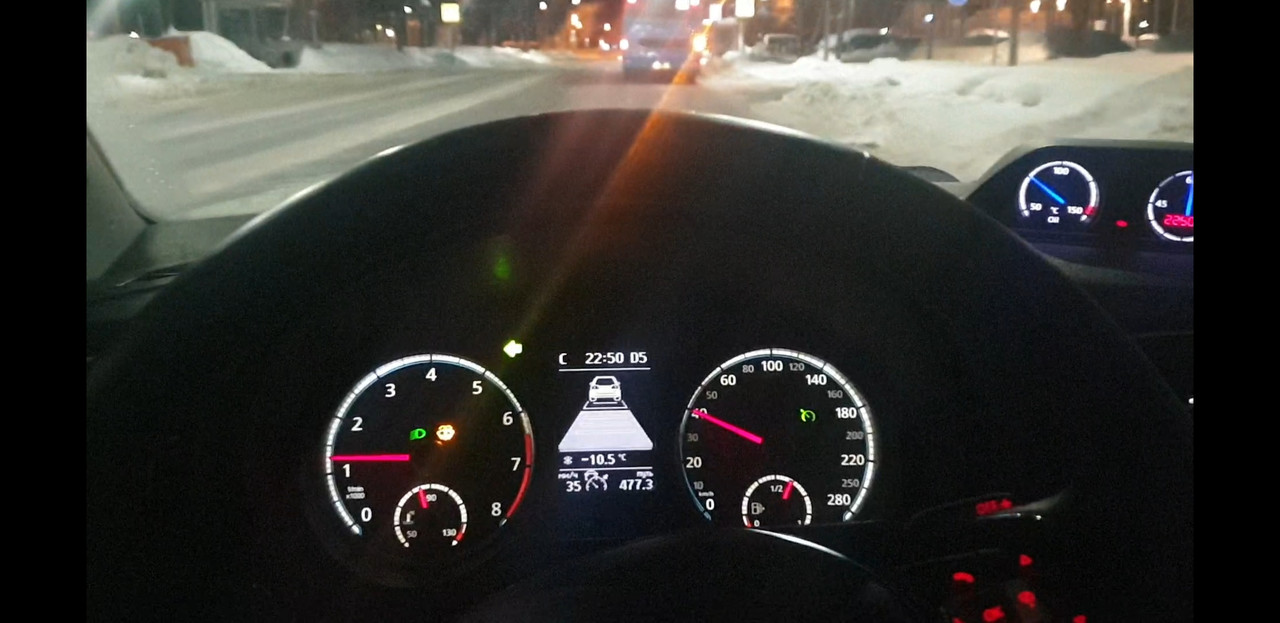

I've done!!!!

Glad to hear you made it work!👏👌
ACC is great.
Btw, did you manage to activate any other function at the same time? ... for example, Front Assist ambient traffic monitoring system with City Emergency Braking?
Sure, front assist is working too. But F2S won't work because of ATE ...379CC ABS/ESP unit.
