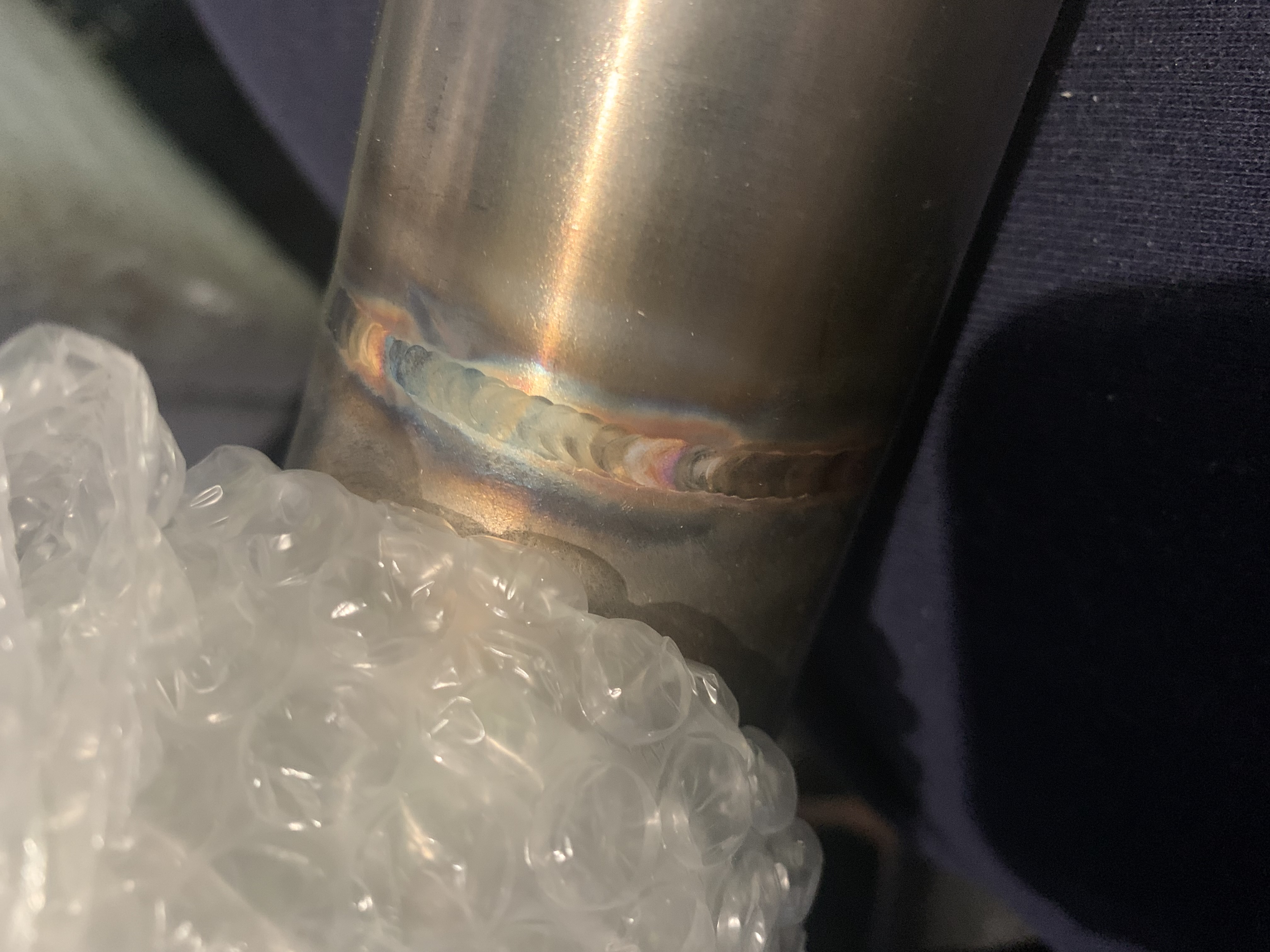

The pipe itself is made from 304 stainless and the welding is also high quality. It came with a clamp to secure it to the section leading to the rear silencer and uses the existing clamp in front of the resonator that connects to the downpipe.

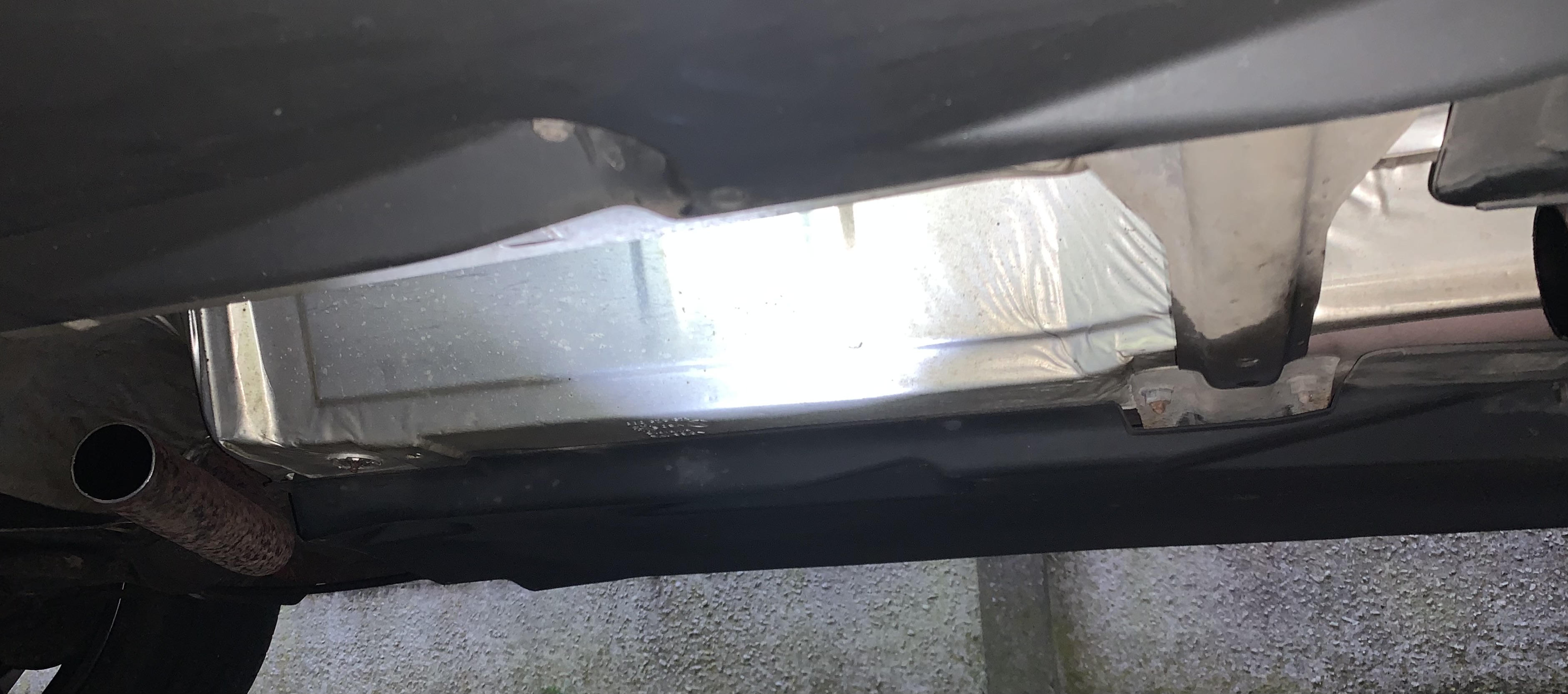

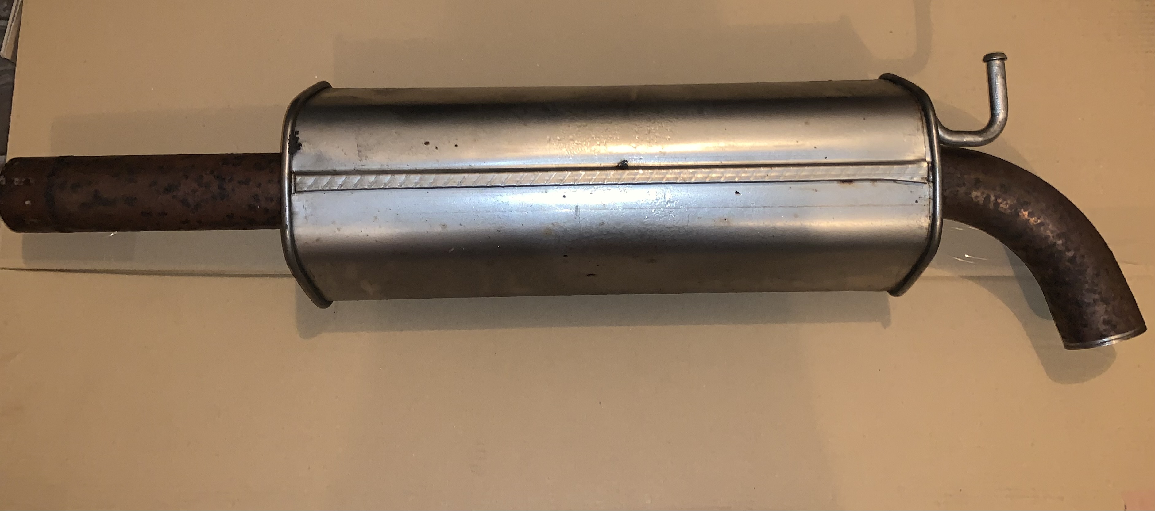

Factory Resonator for size comparison
Stock Resonator.jpg (864.92 KiB) Viewed 2280 times

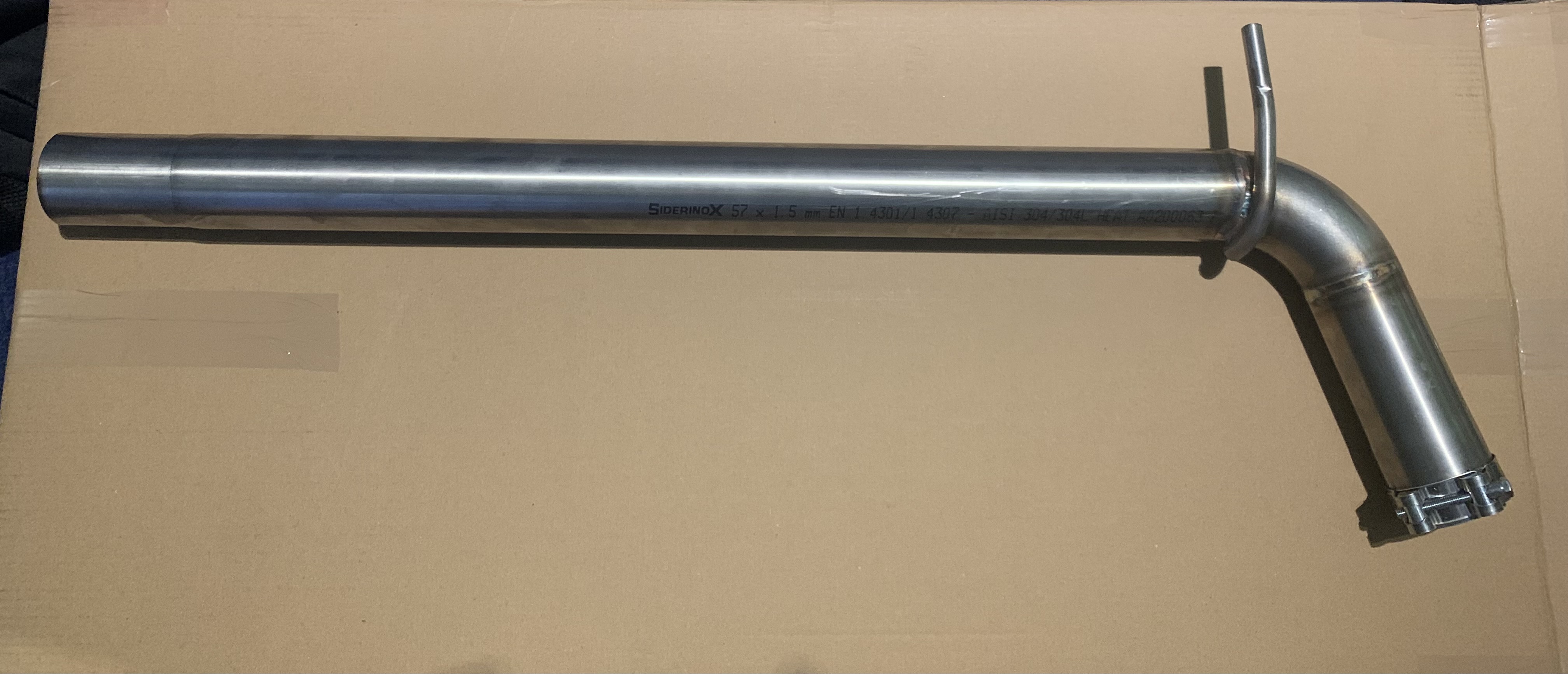

Res Delete
Res Delete.jpg (1.23 MiB) Viewed 2280 times
Welds
Res Delete 2.jpg (2.31 MiB) Viewed 2280 times

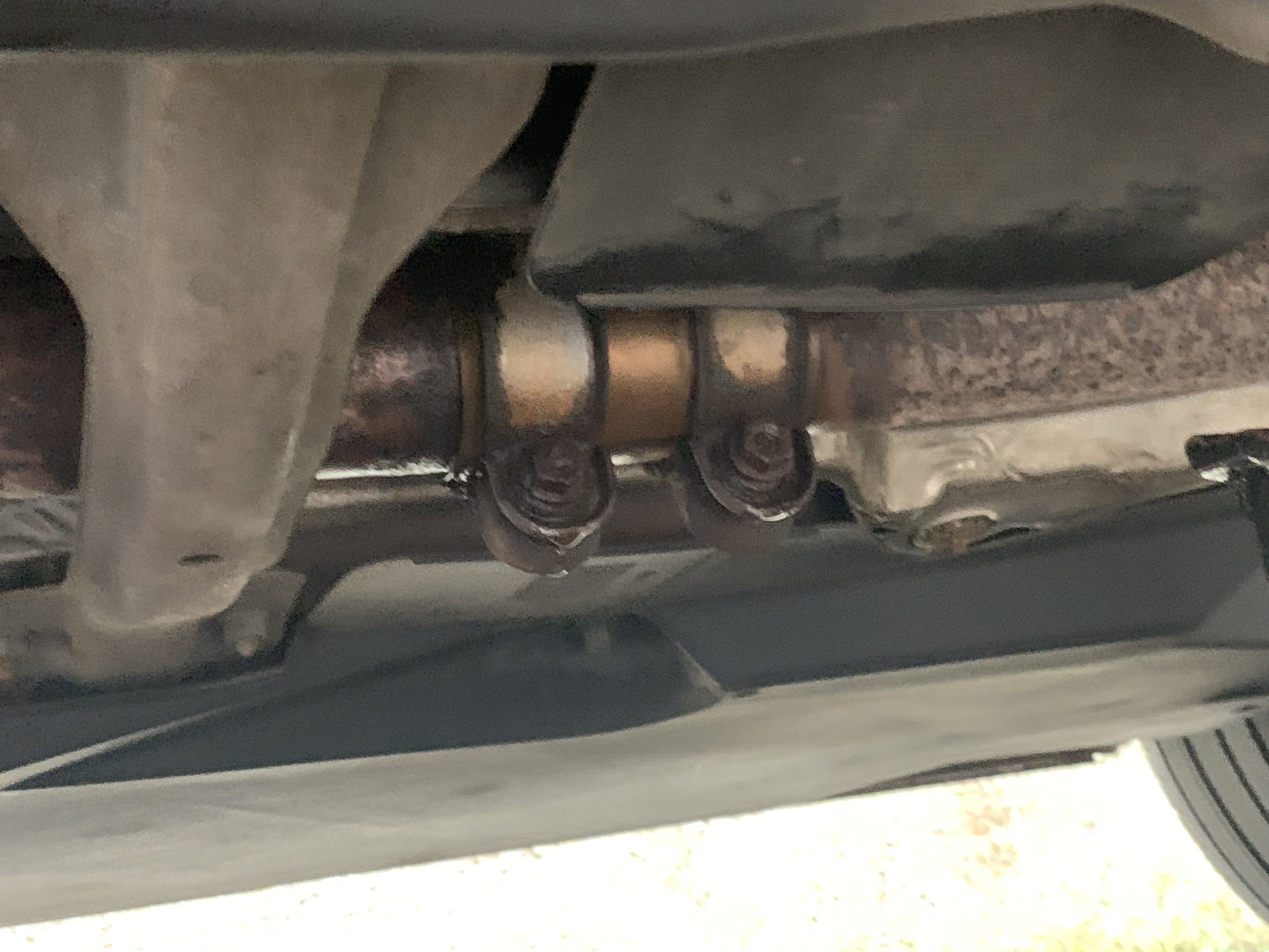

The factory exhaust is only made up of 2 sections, the downpipe and cat from the turbo, then the resonator and rear silencer. They're joined just in front of the resonator with a sleeve clamp. So for a res delete some cutting is required.
Mid Clamp.jpg (1.65 MiB) Viewed 2280 times
The clamp itself has two 13mm nuts. At 76k miles and 7 years old they were quite rusted but did loosen off with some WD40 and wire brushing of the exposed threads. The part number for the clamp is 1K0 253 141 M for those who discover the nuts have rusted away.

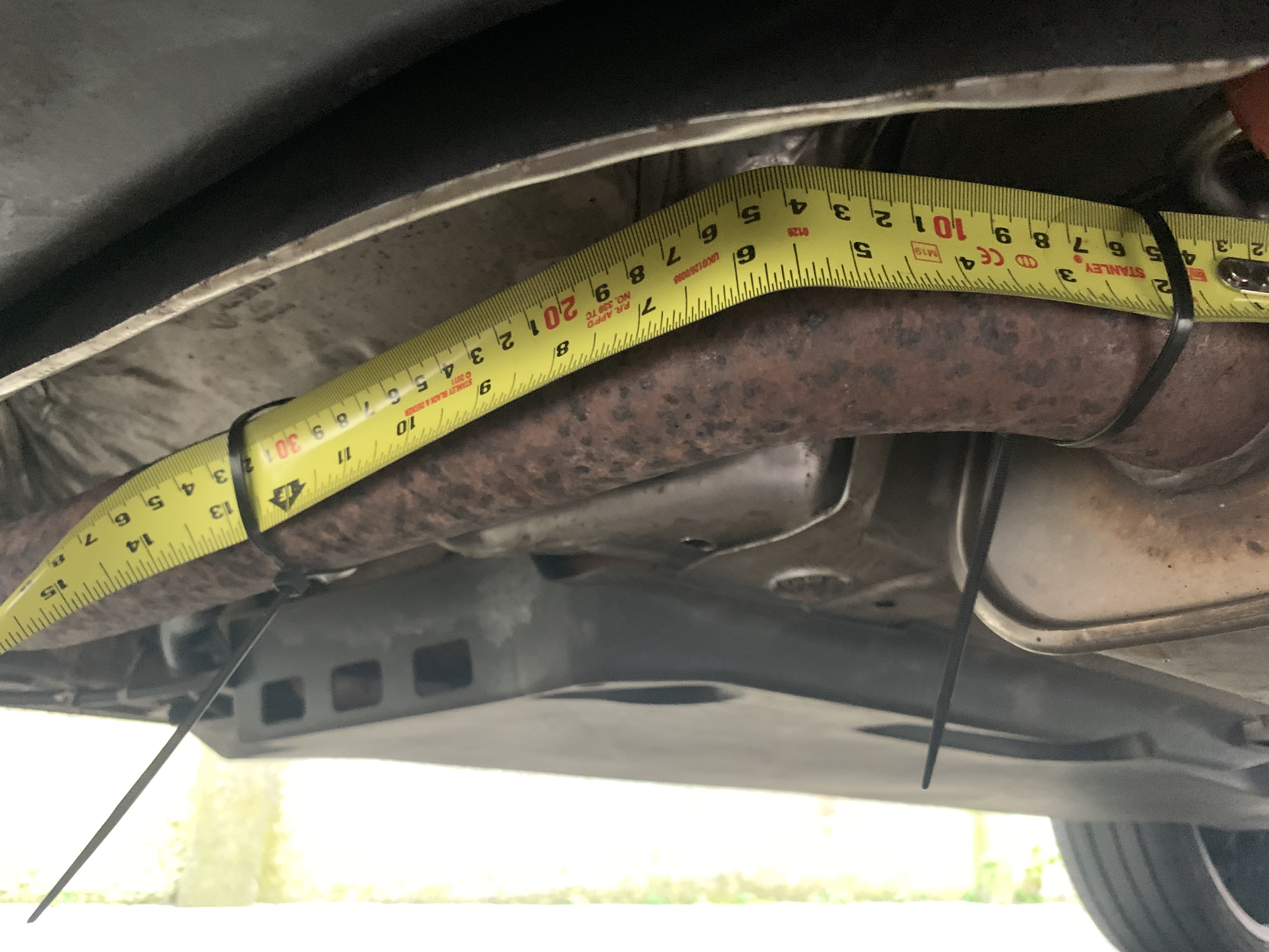

The instructions included stated to measure 240mm from the weld on the factory resonator around the outside of the bend toward the rear silencer. I misplaced my paint pen so settled for using a small hacksaw to mark the measurement.
Resonator Cutting.jpg (2.51 MiB) Viewed 2280 times
Fitment of the res delete relies on the existing exhaust sliding into the new pipe from the silencer end so don't cut this section too short or too long as otherwise it won't fit. Better to cut not enough off than too much in this situation.

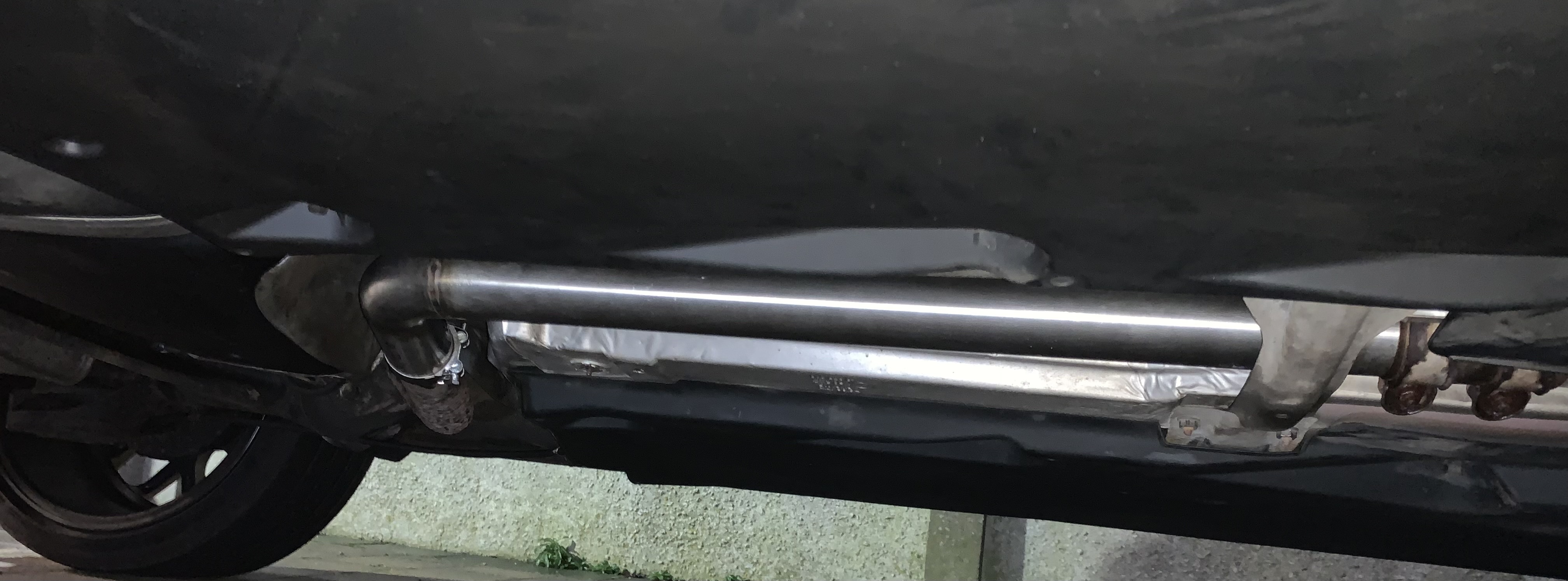

Getting the res delete in is where I started to face some trouble, mainly because I was doing this on the floor on jack stands so didn't have much vertical working space. I also discovered I hadn't cut enough of the old pipe off, off by 5-10mm. I couldn't get the section that went to the rear silencer on and the hanger into the rubber mount at the same time.
Also, don't bother unbolting the brace in the middle as there are more nuts underneath the plastic panelling that need to be removed in order to take it out.
Before you lift the res delete into place ensure all the clamps are in place and orientated in a fashion that means you can access the bolts/nuts to loosen and tighten them.
The best way I found to get the res delete in was the take the rubber mounting off of the car (two 13mm bolts) and put it onto the hanger on the res delete, lift the pipe into place over the centre brace, and push it past the centre clamp to the right side of the downpipe. Then slide the rear section into the res delete.
Once the rear section is in, position the front section and slide the mid-clamp over. Leave the clamps loose and bolt the rubber mount back to the car which is now accessible thanks to there being no resonator :D
Now if like me you didn't cut enough off your exhaust tips will be pushed the the right (looking at the back of the car from behind) but if you did cut enough off, while the clamps are loose, position and manipulate the joint between the rear silencer and res delete to achieve your desired tip fitment.
Ensure no part of the exhaust is making contact with anything to avoid having annoying rattles, knocks and potentially melting something like your bumper.
Res Delete Installed.jpg (984.31 KiB) Viewed 2280 times
