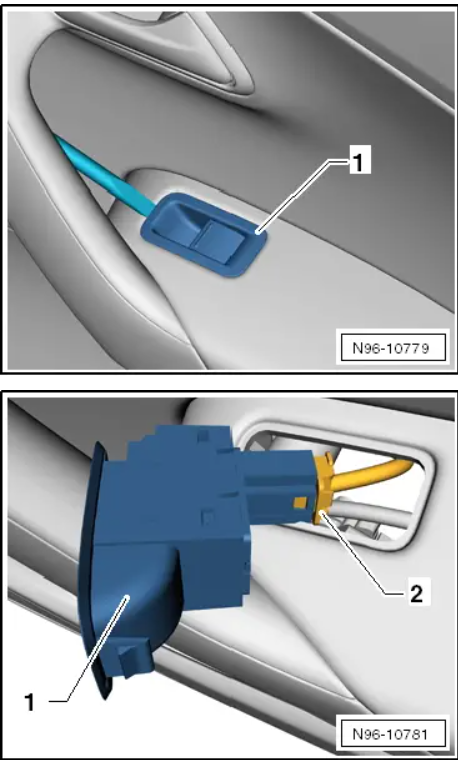

Is there any way to remove the passenger door window switch without removing the door card?
mirceaculita
Posts: 271
Drives: 6R 1.2TDI 75hp
Location: Romania
Re: 12V inside door cards when light are on
Post by mirceaculita »
Screenshot 2024-03-21 100946.png (228.29 KiB) Viewed 3953 times
found it

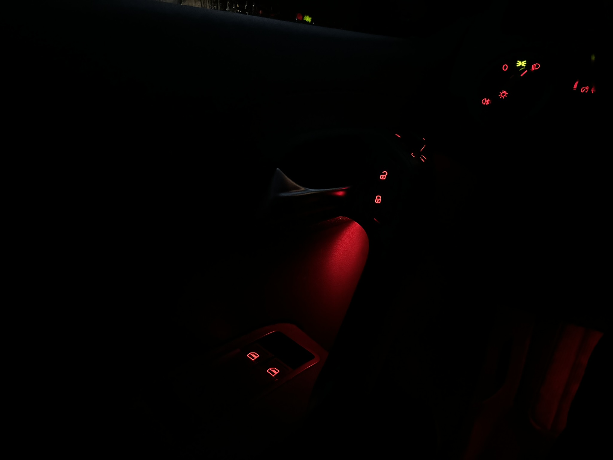

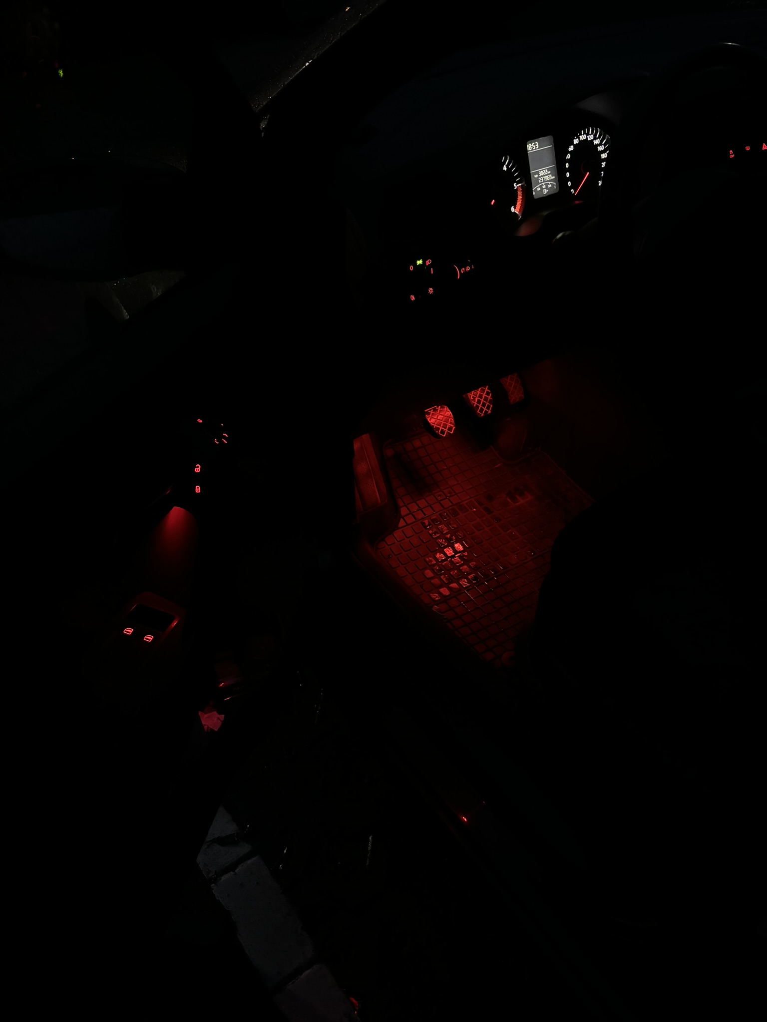

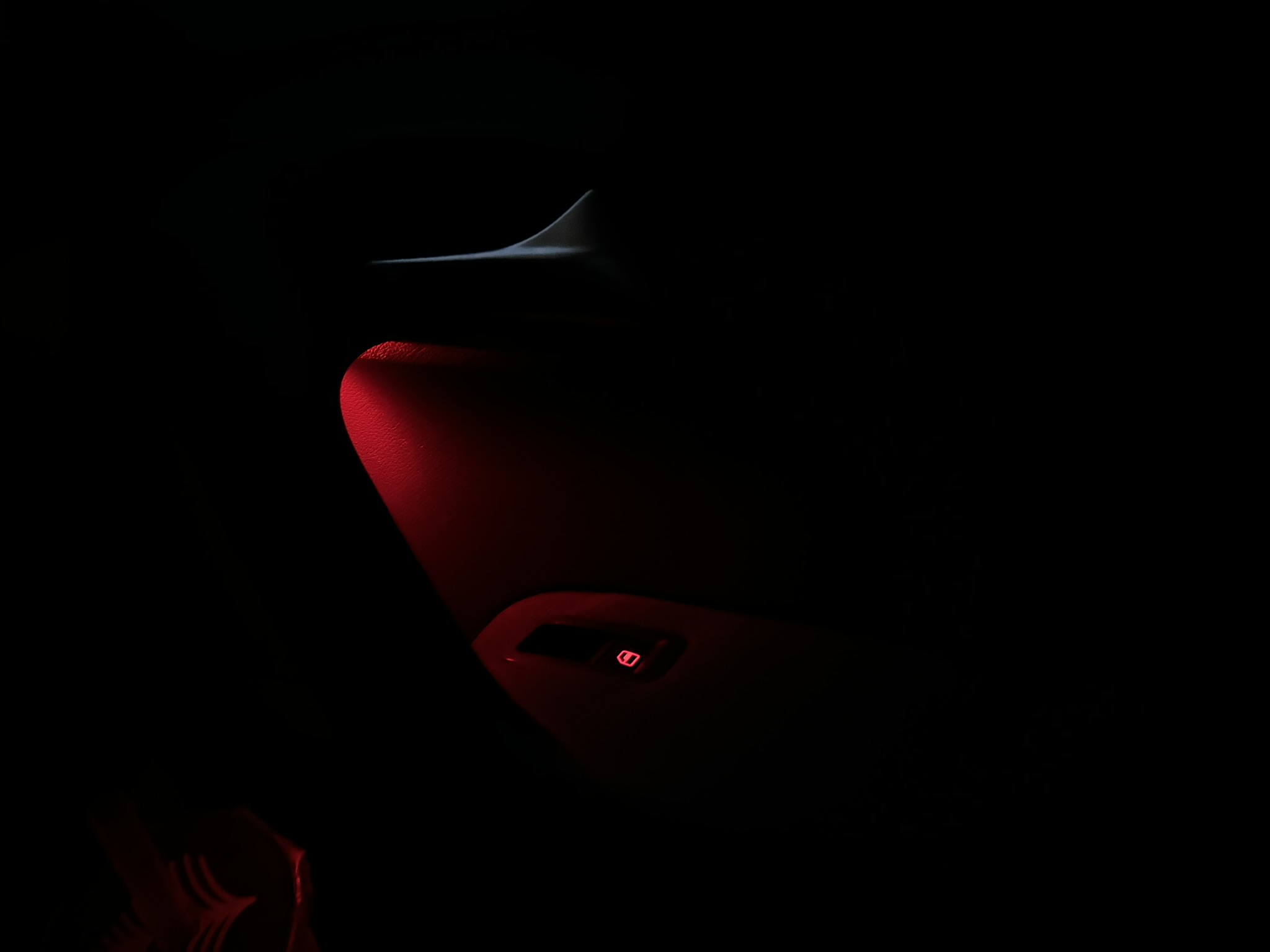

Also finished the install of the leds.
Here are the pictures of how they look at night. Not perfect, I wish they would light the armrest a bit more, but this is nothing an led lens cant fix(or even a different shape led). I wired them up with plugs so I can remove the leds and change them at will without having to re-wire everything. The photos look a lot more bright than they really are. I would say the intensity is at 2/3 or even half in real life. A very lovely side-effect is since they are wired to the button illumination they are controlled by the light power wheel next to the steering wheel making them dim at the same time with the rest of the lights
Even though its not perfect, I can't help but feel good about doing something like this. With the led footwell lights I had wired to the light switch and these new light in the doors it gives me a nice feeling when I look at the car with the door open.

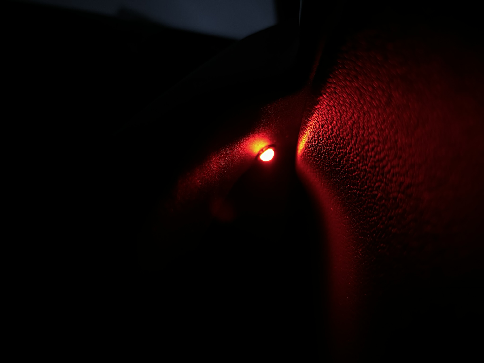

Struggled to drill the holes since my smooth brain couldn't visualize where the holes would end up on the other side. Because of the shape of the handle I couldn't really have the led be straight down so there is kind of a hot spot on the door near the led. Not that visible, also fixable with an led lens of different shaped led. The leds are 5mm and there are lots of different lenses and shapes to chose from, each having a different light pattern.
Here is a photo of the led
