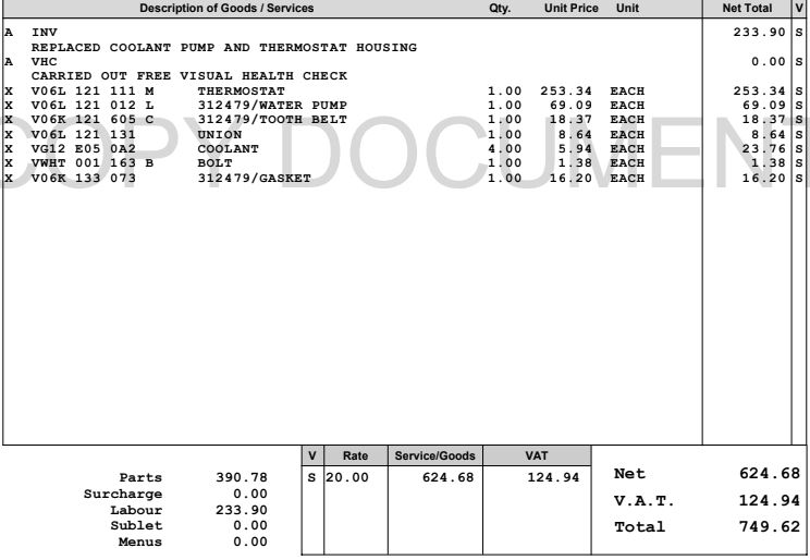

Definitely get the water pump sorted ASAP. FYI you're looking at nearly a grand in parts and labour for that alone if done through a main dealer. See the attached invoice, was from 2021 so prices will have more than likely increased since. I believe the current revision of the thermostat is P.

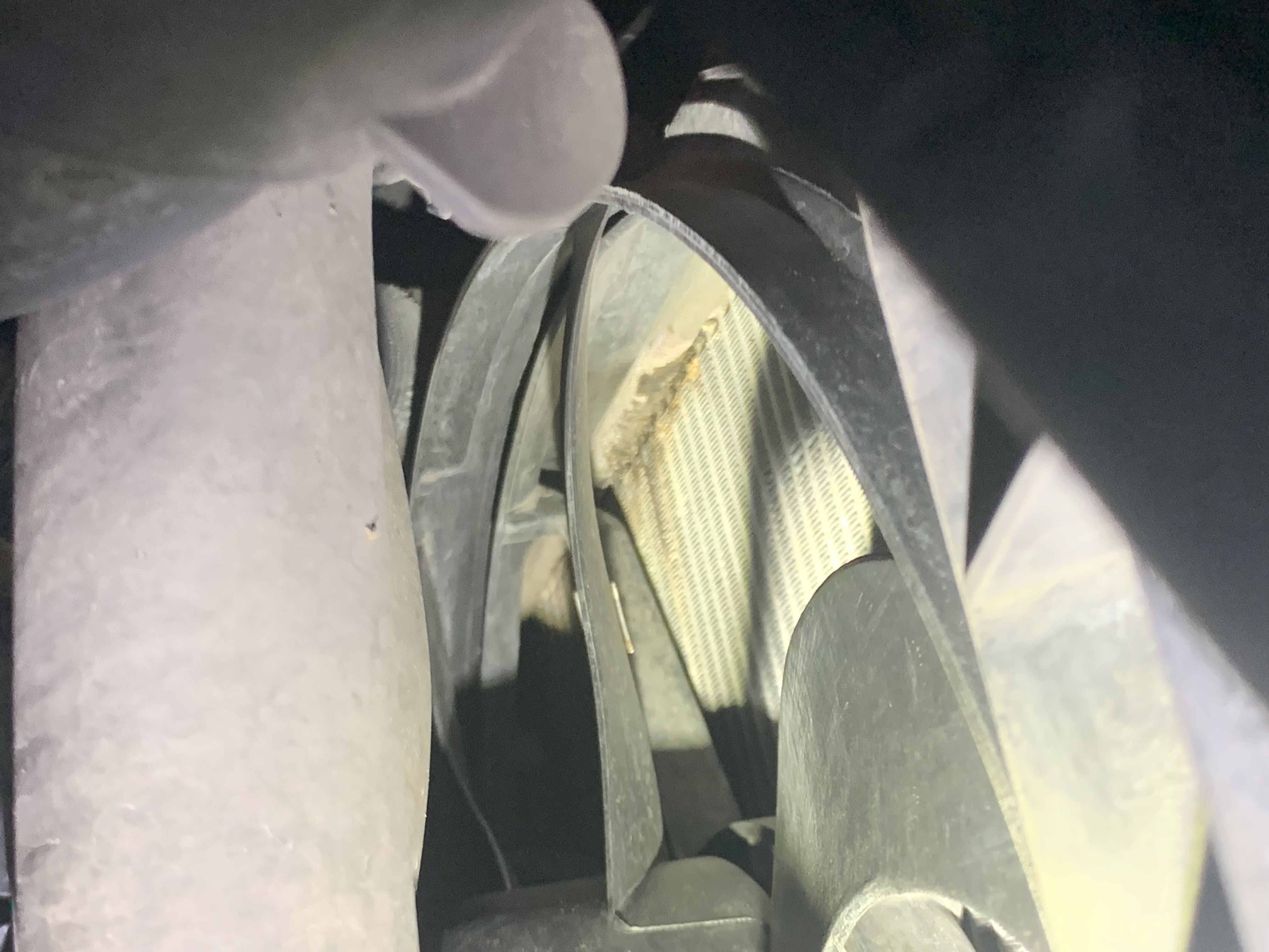

Other places to check in the cooling system now these cars are getting on and VW's heavy use of plastics in the system is the end tanks of the radiator and the coolant vent/union (no idea what it's called) in the cylinder head that sits between the turbo heatshield and the exhaust cam solenoids. On my car the nearside end tank is weeping and so is the cylinder head coolant union/vent (06K121143). For the end tanks, you can see that the edge of the radiator is damp by looking through the fans and also drips of coolant collecting on the corners at the bottom. The cylinder head vent/union won't leave any residue but if it's leaking in my experience that area is consistently damp and you can smell coolant (when the thermostat isn't leaking). It's worth changing, the part was around £7 from memory.
Radiator leak:

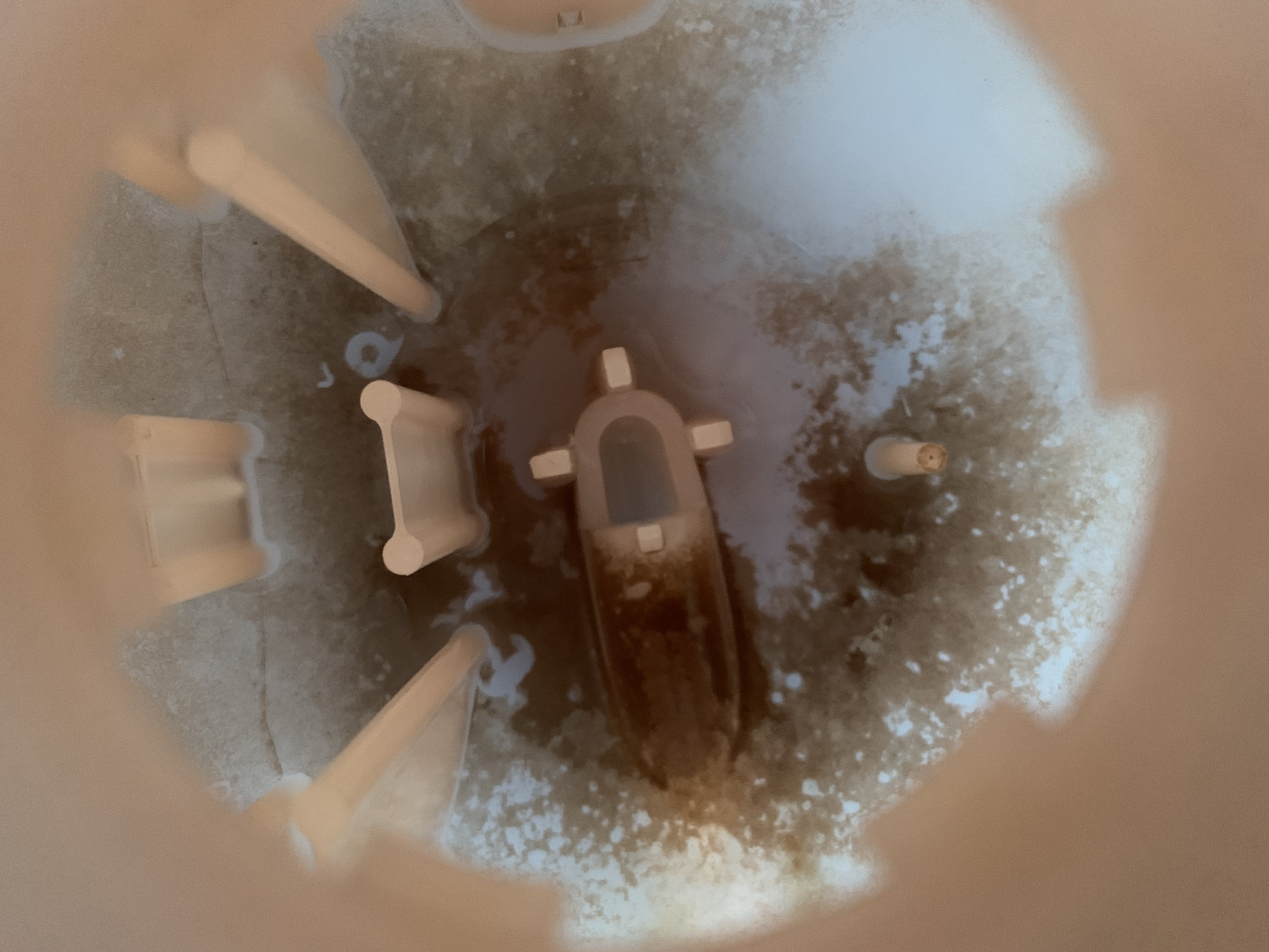

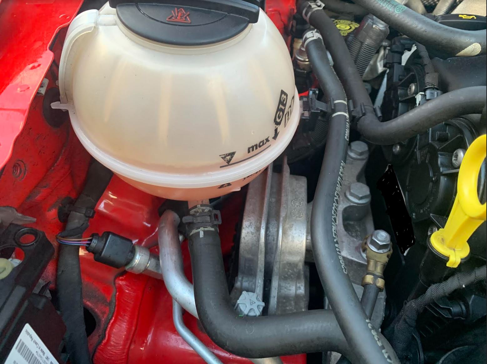

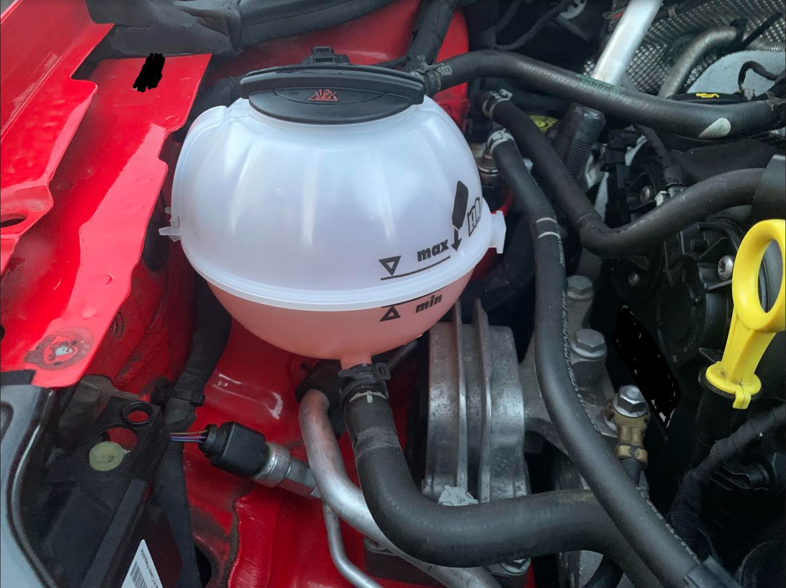

Also, remove the silica packet from the expansion tank if you haven't done so already. If the tank is marked with "mit silikat" then there's a bag of silica in it. If you're worried about it splitting while removing it, removing the whole bottle isn't too difficult. You can pull it out with needle nose pliers from the opening on the tanks on the Polo. New tanks also don't have one if you want to just swap it out. From memory, I paid £40 for a new tank and cap.
Old
Old tank.JPG (196.76 KiB) Viewed 2362 times
New tank.JPG (198.15 KiB) Viewed 2362 times
Inside old tank
Old tank inside.jpg (2.54 MiB) Viewed 2362 times
