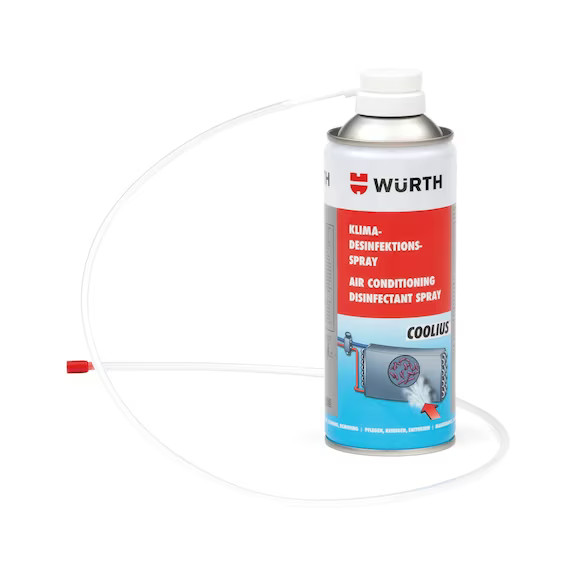

I have previously done the AC bomb thing in my 2017 6C. Just set off a can of disinfectant and shut the doors and let the AC run.
I have a can of Wurth evaporator disinfectant/cleaner.
This comes with a long hose to be inserted in the AC drain hose to get to the evaporator.
The 6C doesn't have a regular drain hose as such, just a exit port behind the firewall padding.
Has anyone done evap clean using that port? Shouldn't be a problem, should it?

A very long time ago, that was the way that car evaporators were sanitised - and I might just have a tin of "stuff" that has that same long straw - but I've got no plans to use it - if I can ever find where I stored it, the long straw is kept in beside a central heating boiler, so that it is flexible - I think that was the plan many years ago!
So, I tend to use bombs, but first of all I remove the pollen filter as there is not much point in letting it capture lots of the stuff that is meant to be passed round and round the car's cabin air system, ie after running a bomb thro the AC system, I fit a new pollen filter.
I'm not sure that that stuff was meant to get blasted into the water drain, I thought that the instructions requested that it went in somewhere else so that it got passed through the cabin air plenum box including thro the evaporator. There must be an "air return" path that takes cabin air back into the plenum when the recirc flap is set correctly. Maybe investigate using a piece of light cloth to see where the air gets sucked in, and stick the end of the straw in that air path.

I've seen them feed it into the air ducts as well.
The instructions on Wurth's site say to feed it into the drain pipe.
There are foam type cleaners that are used in the same way. Those seem to be more effective due to dwell time on the evaporator. Actually, Wurth have one like this, but I can source locally.
I have run a bomb through it before, but that wasn't as effective as I thought it would be. Was hoping to get a more direct shot on the evaporator where most of the mess is.

Oh well, stuffed up the drain it is then, maybe I should try to find my one and use it!

LiquiMoly have one of these as well.
Same application instruction.
But looking at the spec the LM has a pH of 7.0 and this Wurth is 5.0. Not sure if that's gonna be a problem being slightly acidic.
