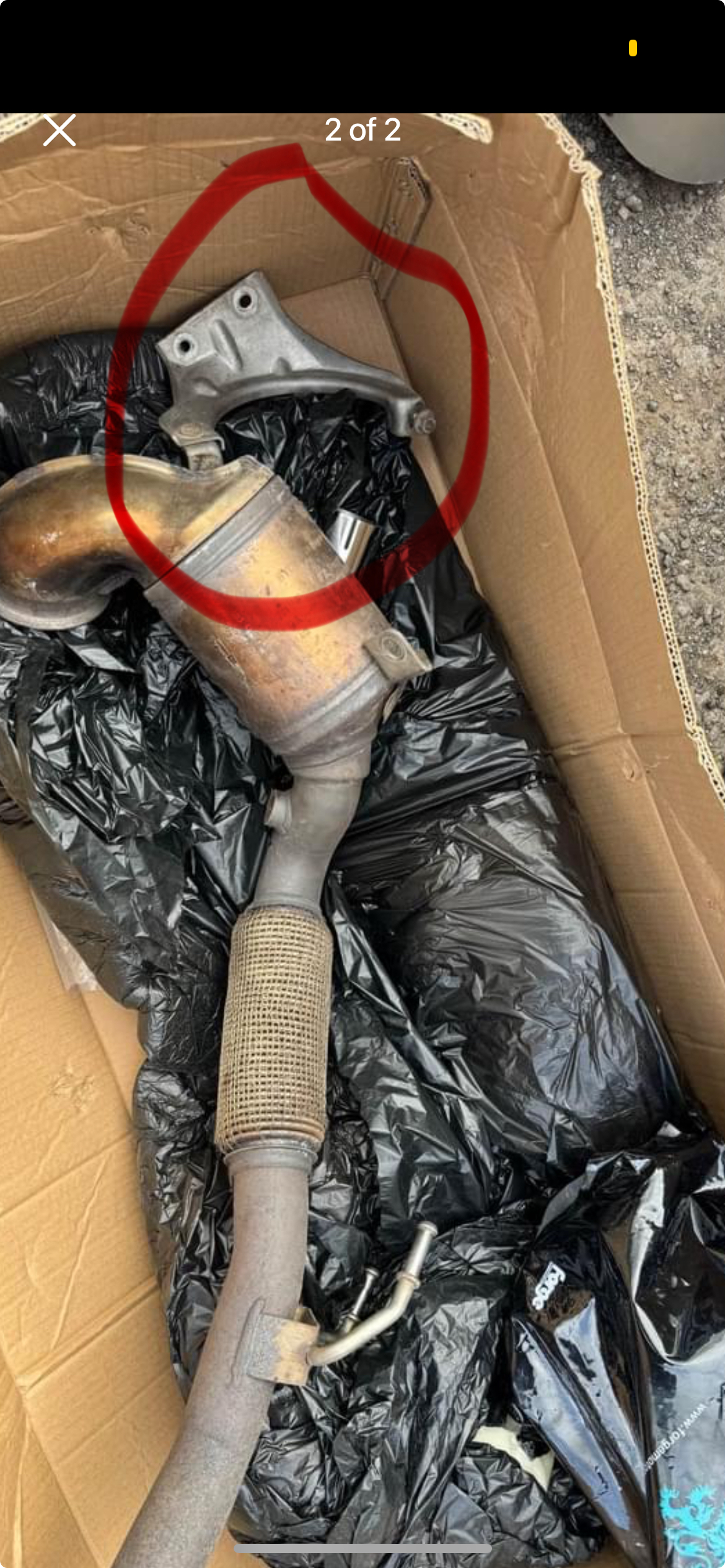

So I recently removed my turbo back exhaust to re-install the OEM system.
I noticed when putting the downpipe back on that I’m missing a bracket that goes straight to the engine block, I cannot for the life of me find a part number for it.
The car is still driving fine and there’s no play in the downpipe without it, but I want it to be better safe than sorry.
I’ve attached an image I found on one of the polo groups on Facebook, it’s circled in red.
2226

6R0 253 249
Retainer for exhaust pipe.
