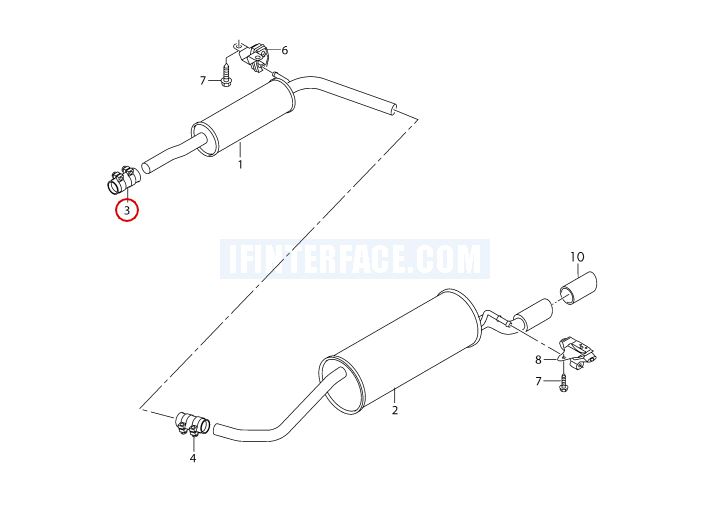

Most likely these clamps:
Items 3 and 4.

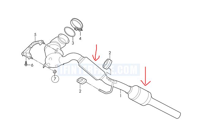

Speaking of exhausts...
How many cats on the CJZD?
There's the cat up top at the turbo, but what are these other 2 units? Resonators?
To honest, now IDK. For me one, right after the turbo. I don't know what are those devices.

I guess need to look at where the 2nd O2 sensor is. I've never really checked.
I think that's just the resonator; after that is the 2 mufflers.

The first ( nearest the motor)most likely a flexible joint the second is definitely a cat

CarbonChaos wrote: Mon May 20, 2024 8:39 pm The first ( nearest the motor)most likely a flexible joint the second is definitely a cat
EA211 hase their cat right after turbo. It's not a flexible joint.

Petrol particulate filter.

The first "red arrow" in the diagram above is the flexi section.

The other red arrow is the particulate filter. Only found reference to this is one of the maintenance documents.
The maintenance document for the 1.0tsi has a ton more stuff going on. Very weird.
