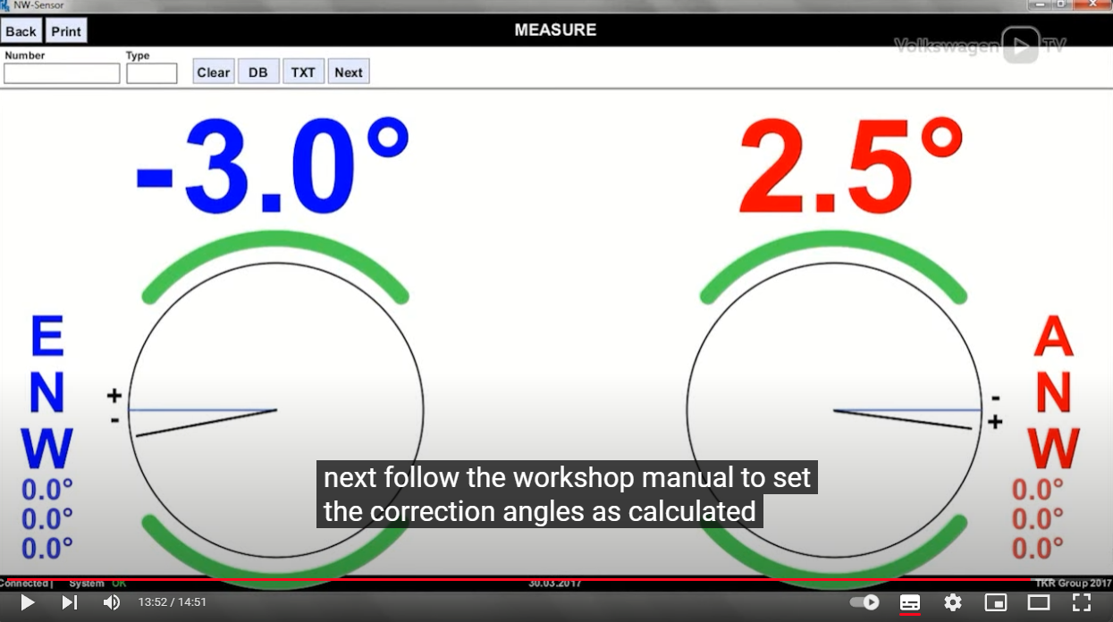

At 8:00 min they install the tool and make engine two turn of crankshaft before lock it in TDC position.
Actual reading on the computer are out of tolerance and engine need a proper timing.
Since here ok.
They untight bot camshaft bolt and set both camshaft sensor to 0°.
Tight back both camshaft bolt.
Ok.
Now, again two turns of crankshaft to determinate timing correction angle (to see how far the values are from factory requirement).
In the exemple we have (after two turns):
+3.5° on the inlet side (nominal is +0.5°) so adjustment need to be -3.0°
-1.0° on the exhaust side (nominal is +1.5°) so adjustment need to be +2.5°
No issue here.
It's after that I'm confused:
At 13:48 min they said 'set the correction angle as calculated"
And on the screen we see that: -3.0° for the inlet side
+2.5° for the exhaust side
So they applied the corrected angle.
But on the video they said nominal is +0.5° for inlet and +1.5° for the exhaust.
So if I make a quick calculation we have for inltet side a correction of -6.5° (from +3.5° to -3.0°) and for exhaust a correction of +3.5° (from -1.0° to 2.5°).
But it seems I miss something of maybe they take the 0° calibration as they did at 10:09 min to determinate the correction angle value.
So the 0° is the reference.
Let me now.

The initial zero calibration seems to take out the extra you have in your calculation.
So, yes, over the total procedure the degrees add up to what you have, but there are 2 adjustments done.

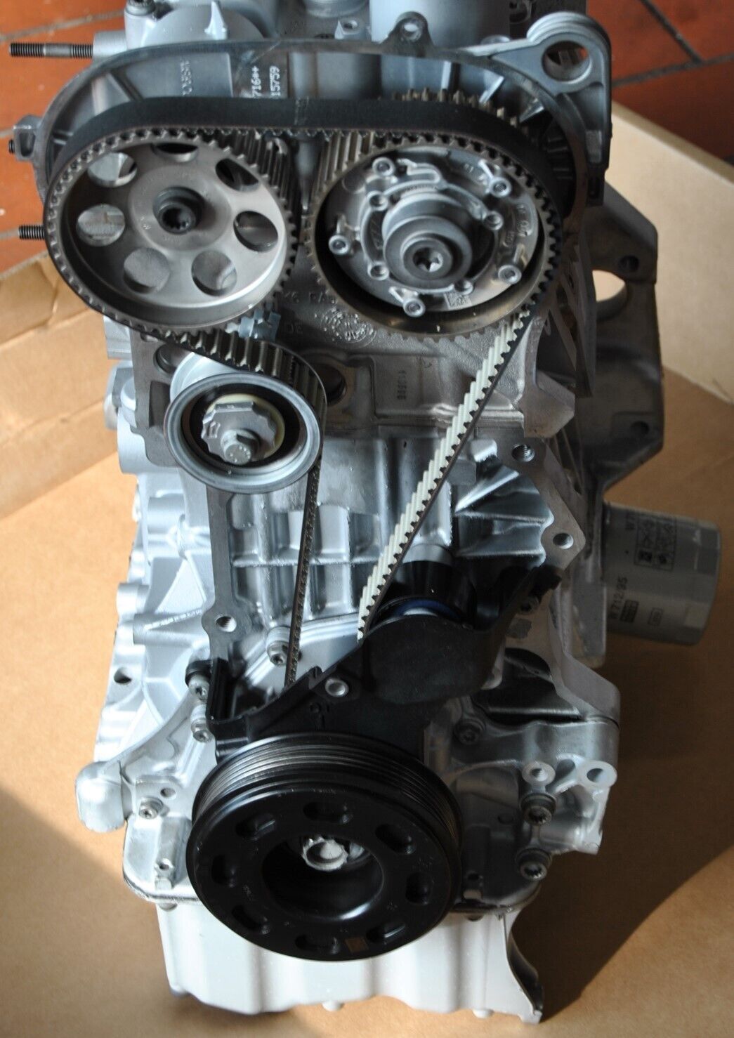

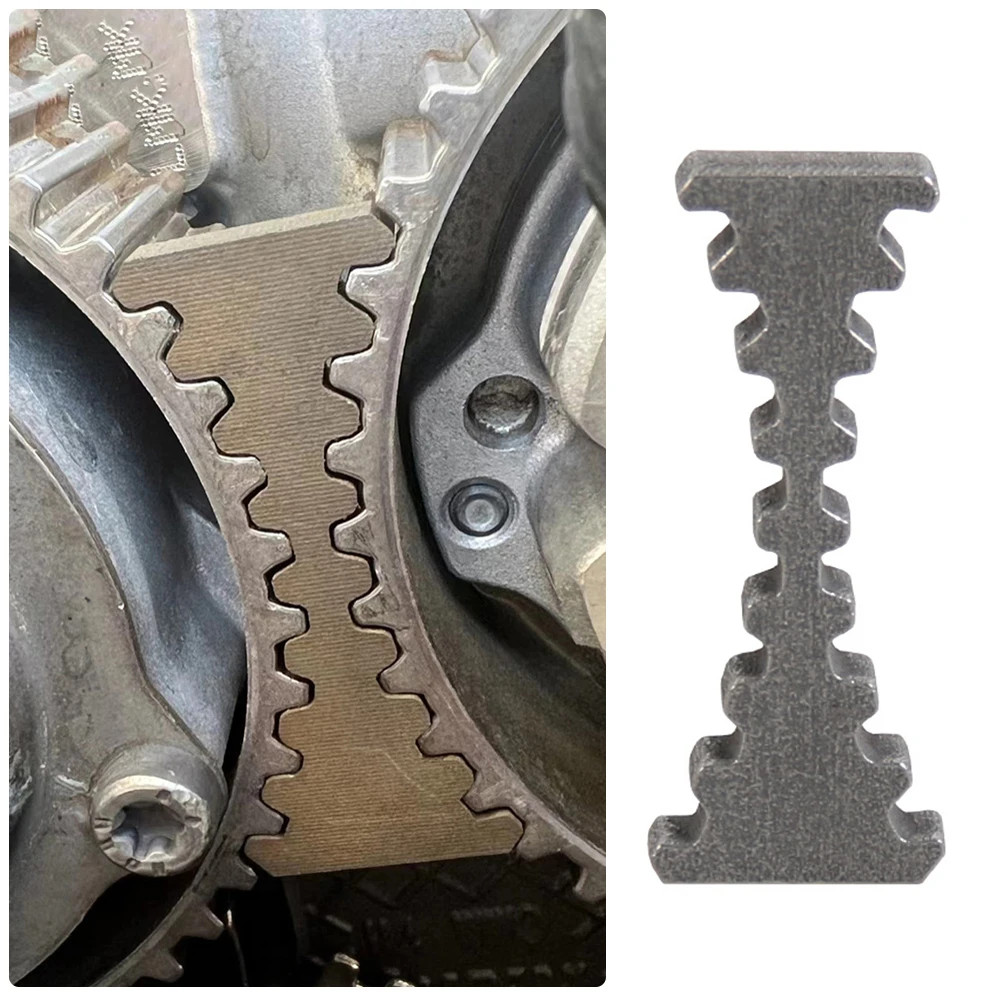

You could lock the EA211 like this:
Only intake phaser on the CJZD.
Think it looks like this:
That exhaust cam bolt is gonna be in there with some serious Loctite.![]()
VW saving 0.15 euro on the woodruff key.
The rest looks like a regular timing belt setup. The worst part it not shown in the picture is the engine mount being in the way.

Yes you can lock camshaft on both side with the tool you share between the pulley, and with a tool on camshaft on gearbox side.
But if you don't touch to the bolt on camshaft, no timing check is needed.

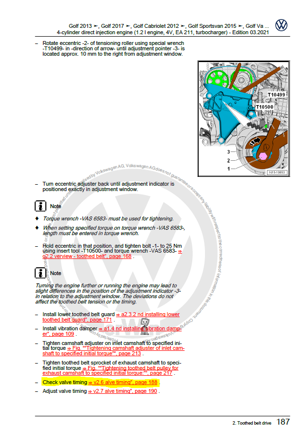

On SuperEtka, I found official VW Workshop manual for timing belt replacement according to my VIN.
And guess what ? No need of the 3 millions euros tools from VW to check valve timing.
- Posts: 6093
Re: Timing tool VAS 611007
That is interesting, I had assumed that VW Group had introduced that tool in response to workshop techs not being able to get a 100% success rate when replacing these belts, ie but using this tool, the job could be "de-skilled" and get better or constant good results every time.
I have read online about many people ended up with a very nasty car after getting a timing belt replaced - assumed to be due to a slight/small error in timing, in fact some VW Group Indie workshops suggest avoiding using any workshops that do not have that "tool kit" if needing a new timing belt on ANY EA211 engine, regardless of age.
One side issue with getting an EA211 engine timing belt replaced in a a workshop AND them using that tool kit to achieve timing as good as it was before the timing belt change, seems to be that the labour cost in hours is much more.
I'm asking, was that official workshop manual issue date "newer" than when that tool became available, or was it an earlier date, I think that I read that that new tool kit MUST be used on newer 1.0TSI EA211 engines, but is very useful to be used on older 1.4TSI and 1,2TSI EA211. I'm guessing that that VAS 611007 tool kit was launched almost a year ago.
- Le_Combattant
- Posts: 514
- Location: France
Okey so my bad fox, I did a mistake.RUM4MO wrote: Fri Jun 21, 2024 6:09 pm That is interesting, I had assumed that VW Group had introduced that tool in response to workshop techs not being able to get a 100% success rate when replacing these belts, ie but using this tool, the job could be "de-skilled" and get better or constant good results every time.
I've just figured it out.
On Erwin, I took two PDFs, one for the petrol engines dedicated to the Polo ONLY, the 1.2 TSI available in two level power (90/110) CJZC and CJZD.
The second concerns the entire EA211 family, Golf, Touran...etc. So I think they've incorporated the strictest method with the VAS 611007.
And indeed, in the PDF dedicated solely to my car (and yours with CJZC and CJZD), the VAS is not required. Blocking with the T10494 tool is enough.
