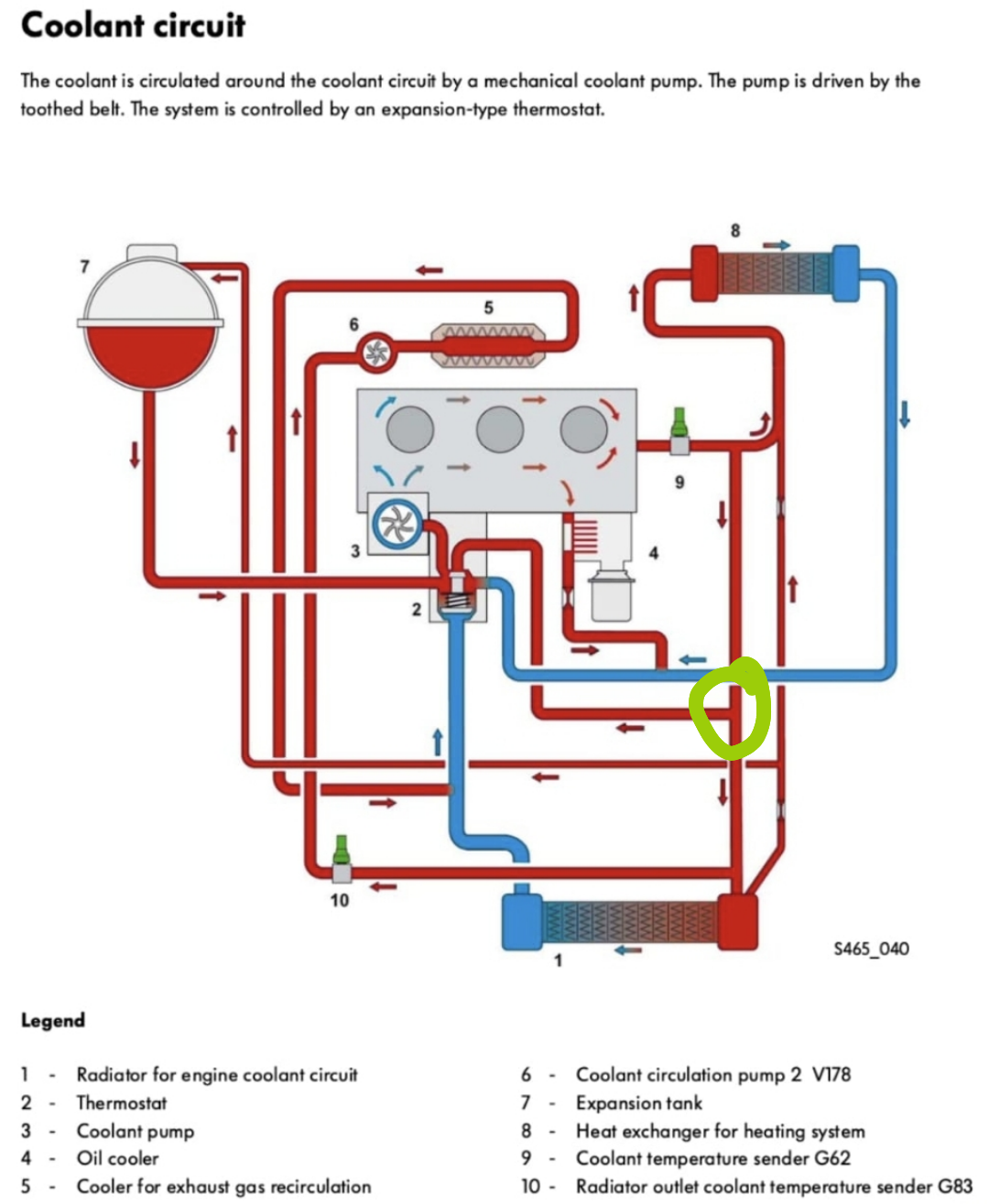

So... Allowed the car to sit while I gathered my thoughts... Consulted the below diagram, had the idea to fill the header tank, pop off the pipe below, have a friend start the car for a short period of time, so I could both monitor the pipe and fill the header as needed. Flow from the pipe, which should have come from the pump from the block and it was literally a trickle, nothing more forceful than the flow when The pipe was taken off.
We think from this (other opinions are very welcome) the pump has indeed died.
Looking to test my logic to see what others think.
Re: 1.2 TDi BlueMotion (2012) Overheating issues
it's a shame the pump housing is integral part of the engine so you can't really check it. the return of the radiator seems to have the thermostat.
i guess you could check the top hose of the radiator for any flow with running engine @ idle, but make sure you don't get a pink shower...

We did this, but at the tee peice circled above which is same pipe. Not much flow...
When car is up to temp after being driven the top hose goes rock hard with what feels like compressed air/steam. Knock it off and twist the cap to pressure release, the top hose clicks and pops then slowly fills with hot water. If a pump doenst fix it, I am literally at an impasse!
