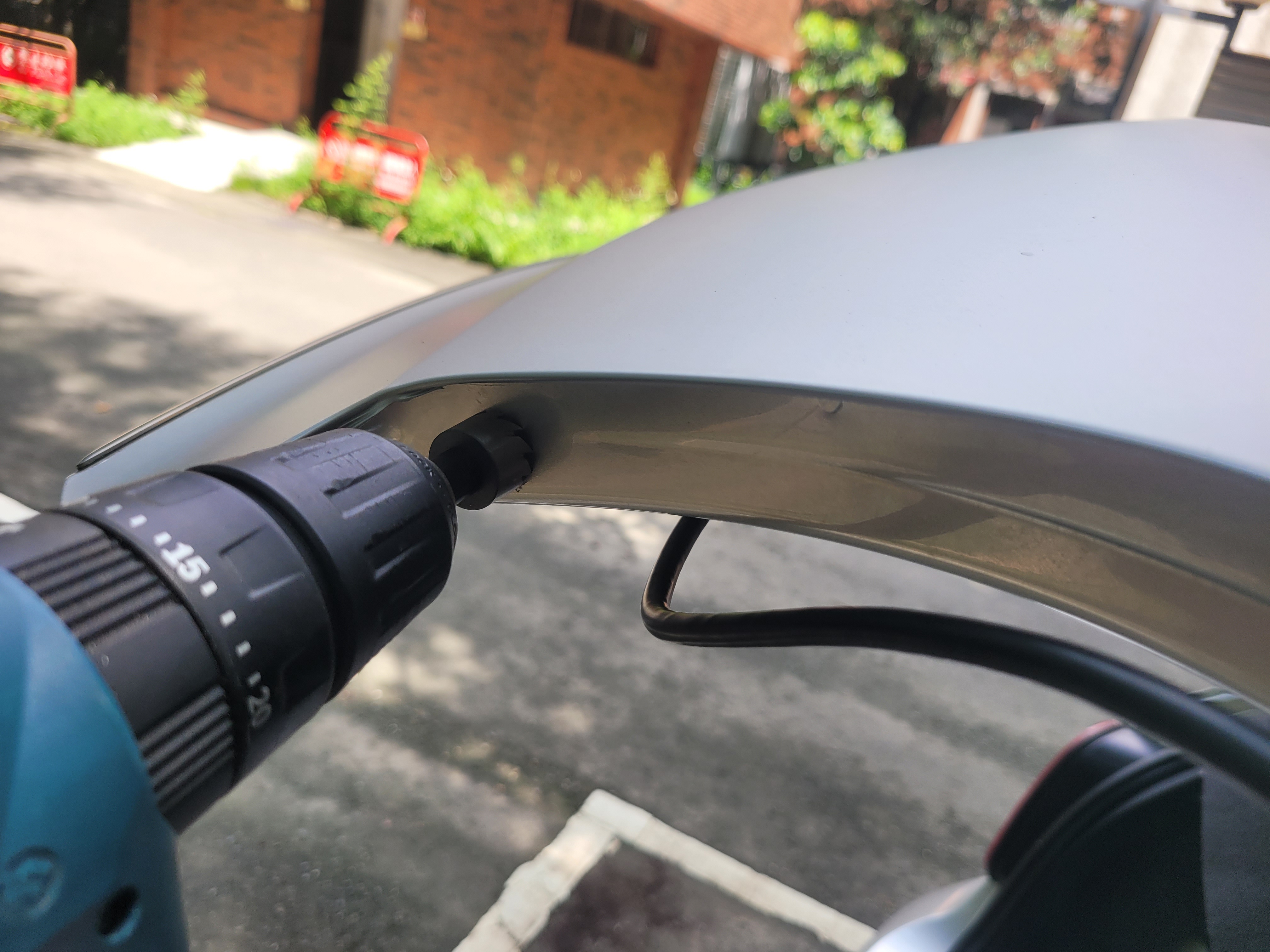

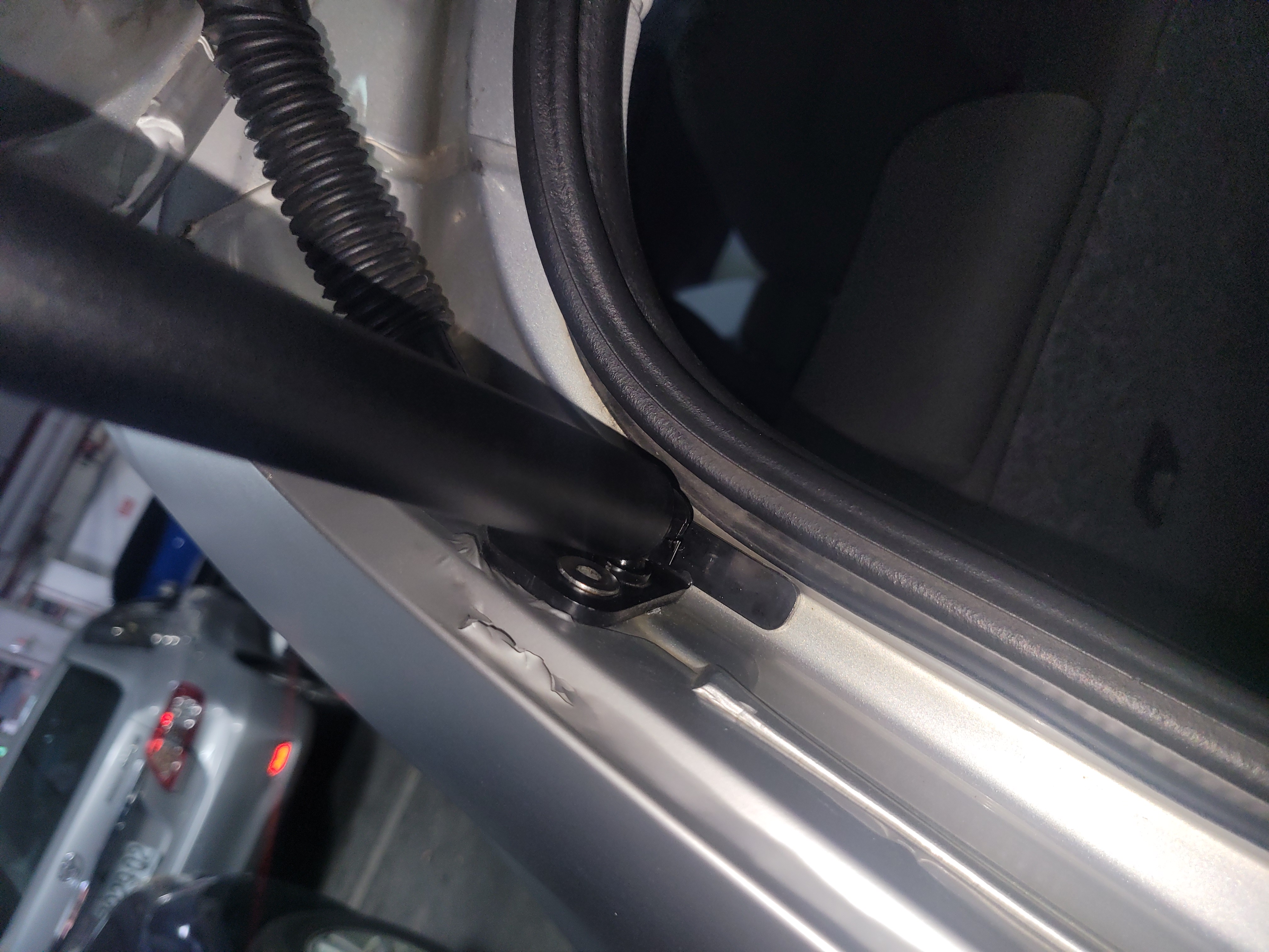

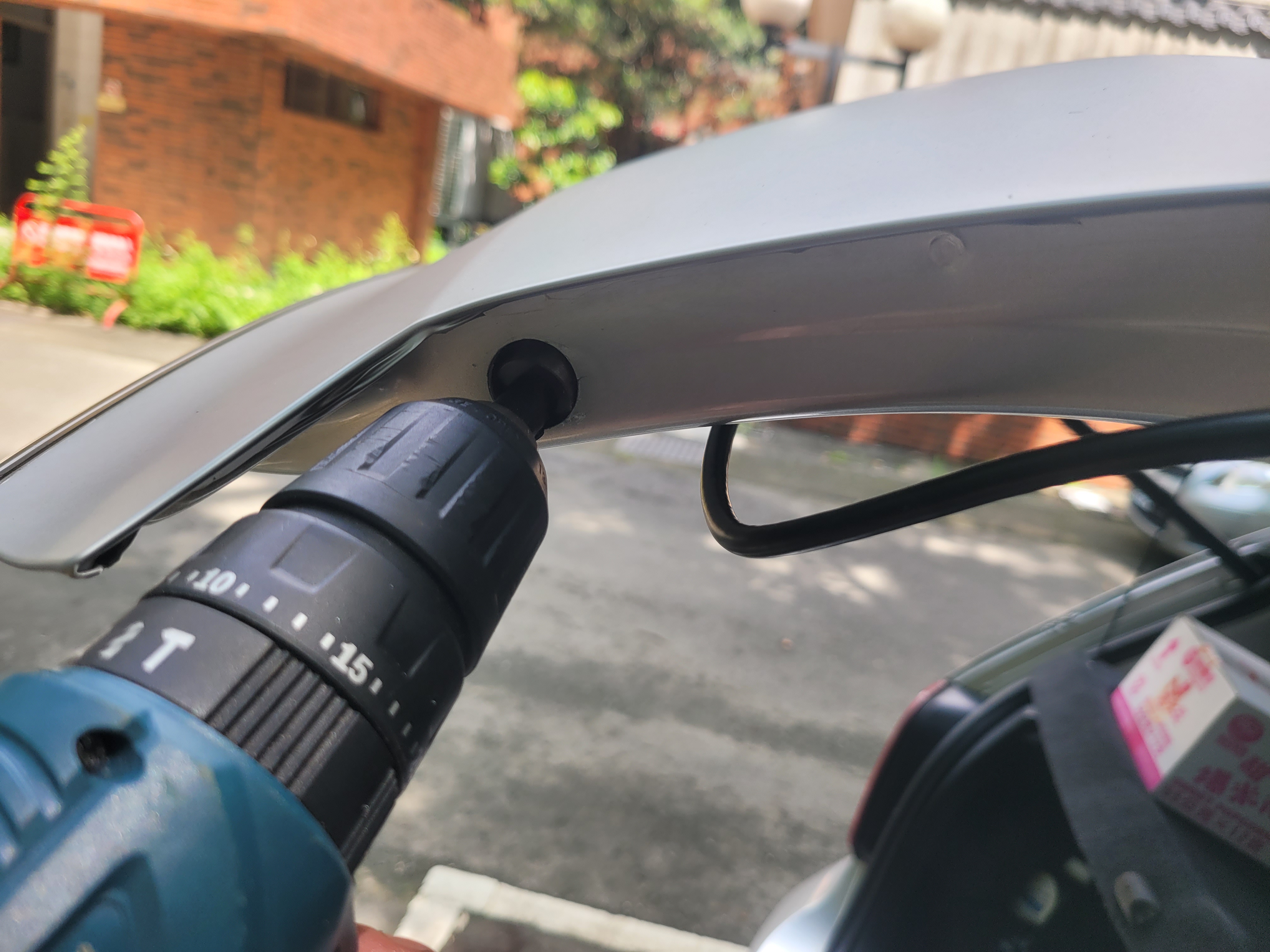

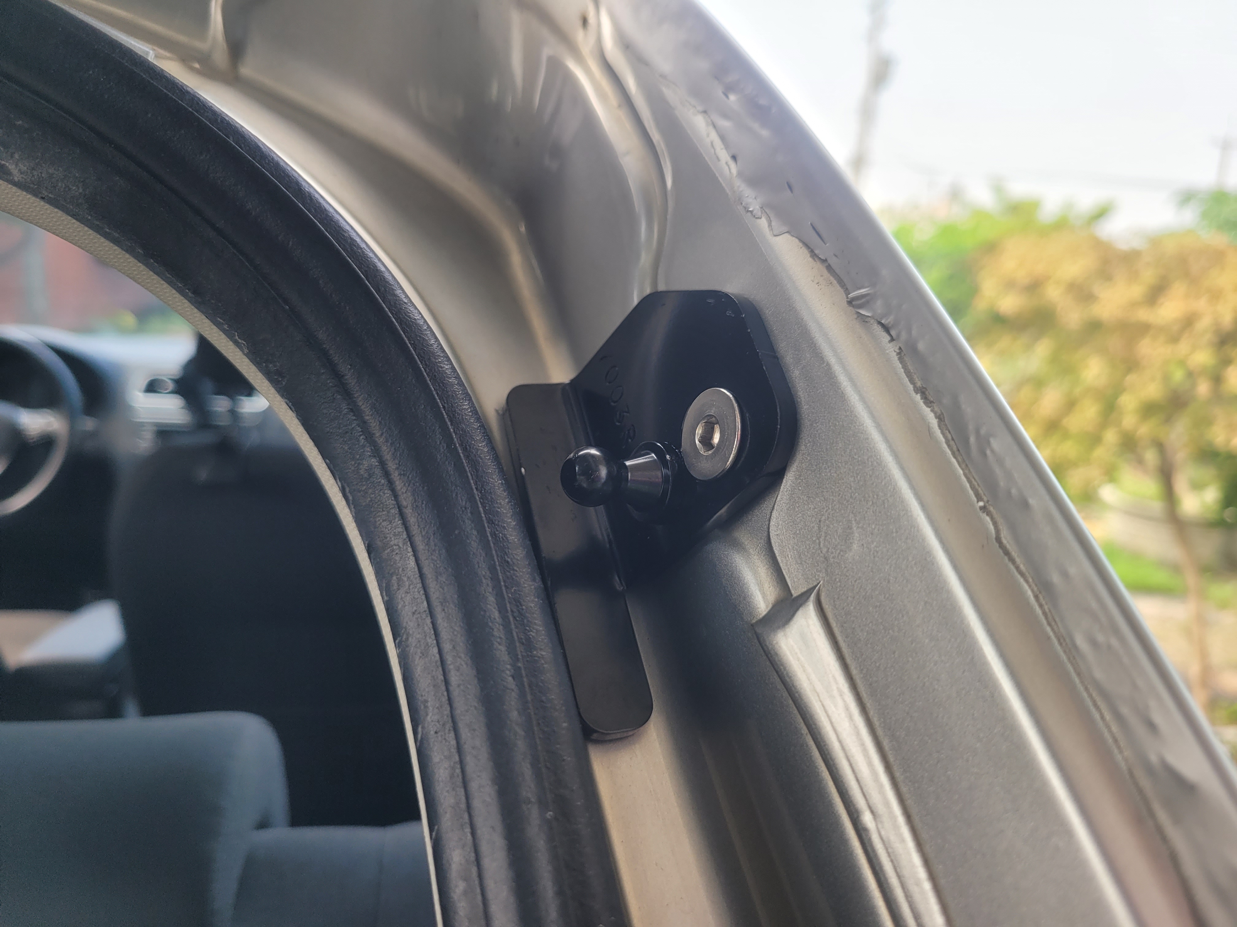

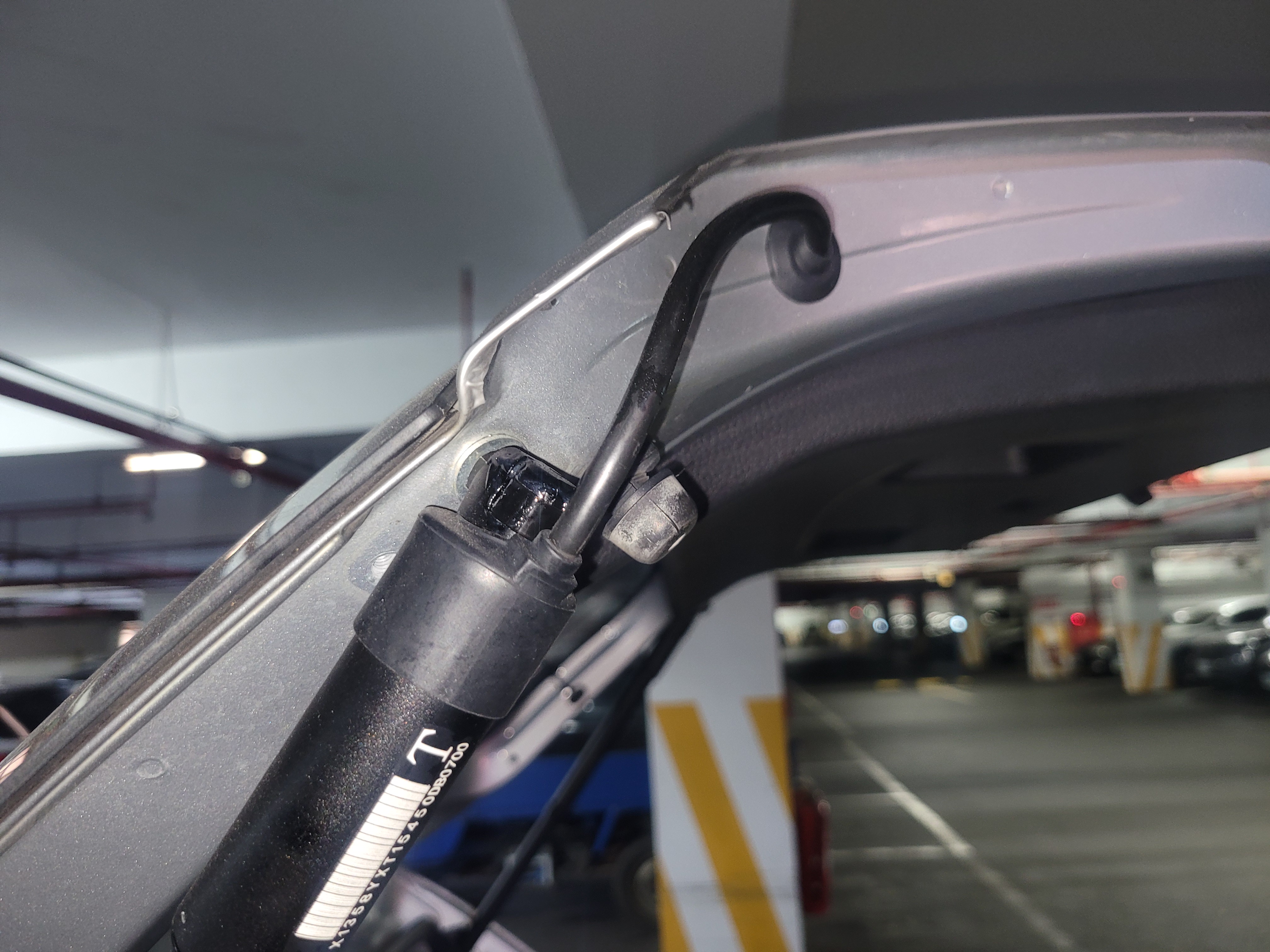

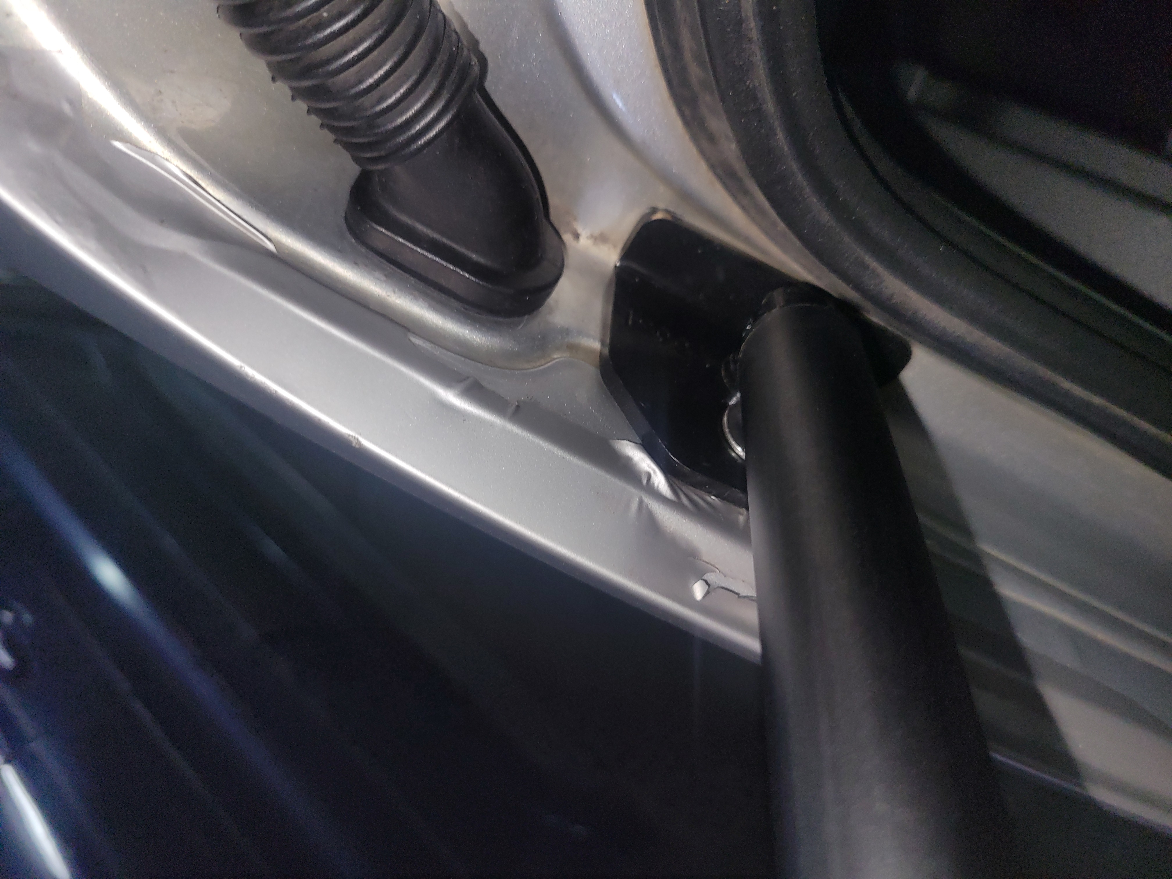

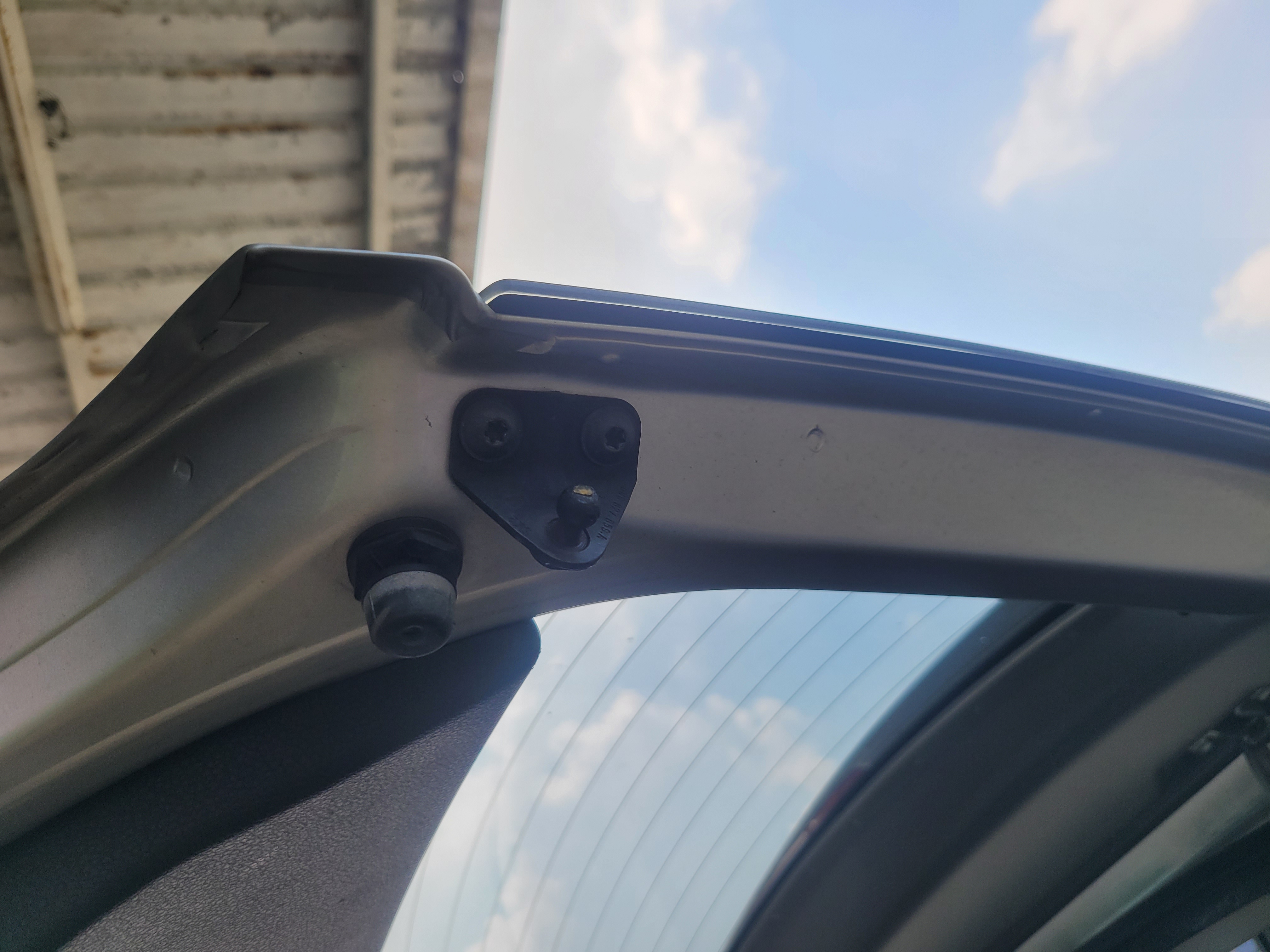

First, modify the fixed part of the gas spring.
Fixed part on car body
Fixed part on tailgate

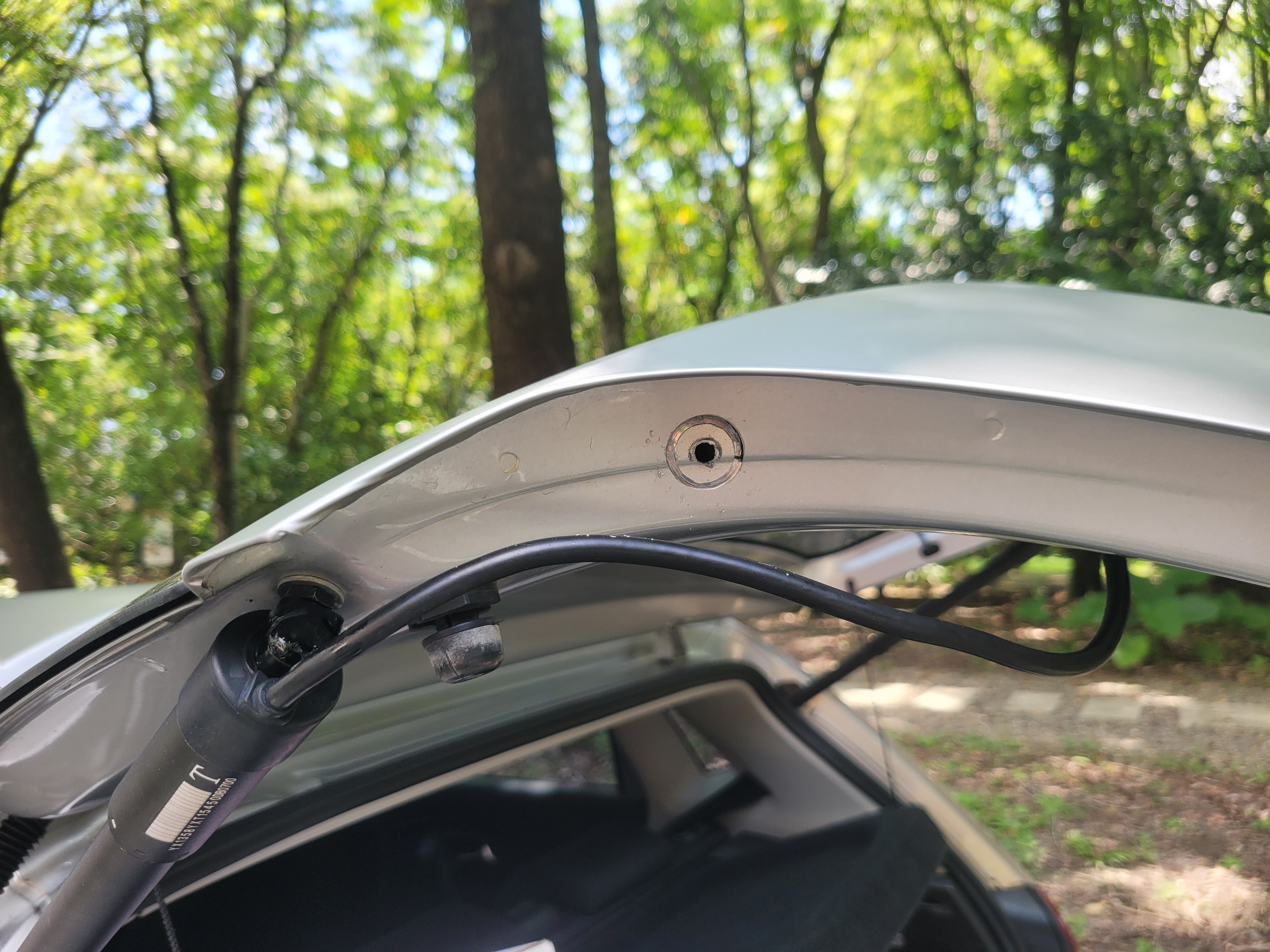

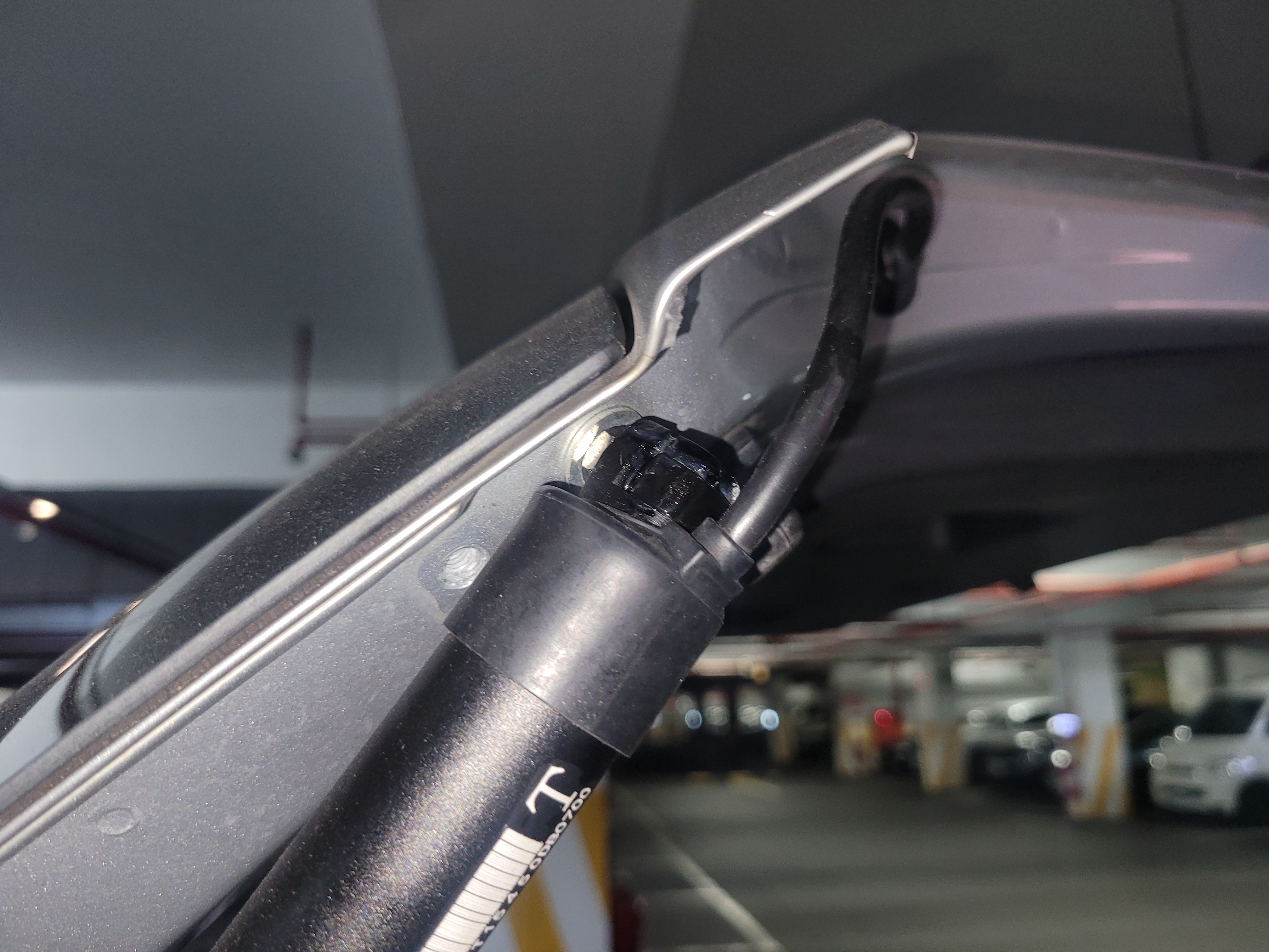

Second, replace the gas spring.

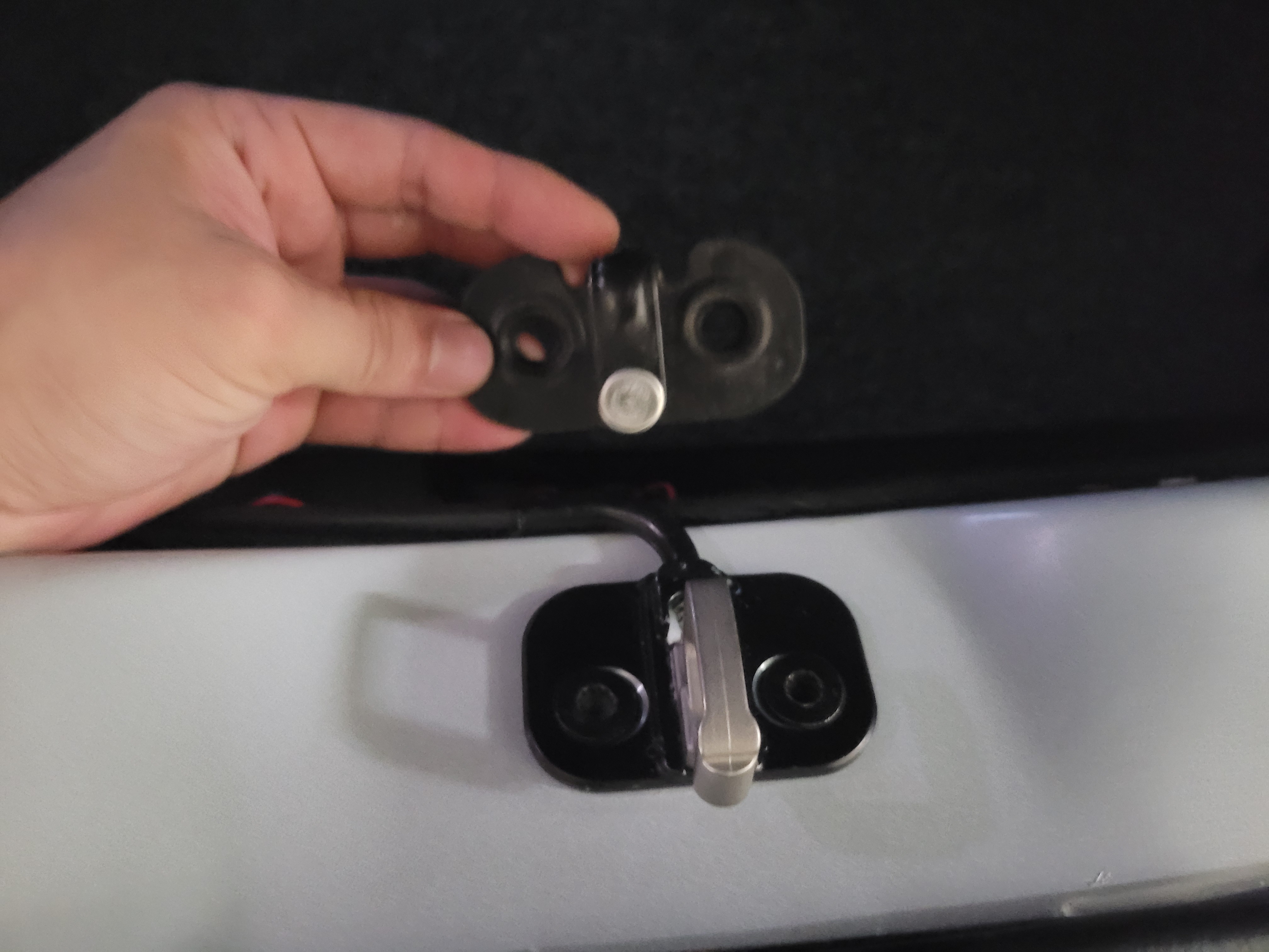

Third, modify the boot lock.

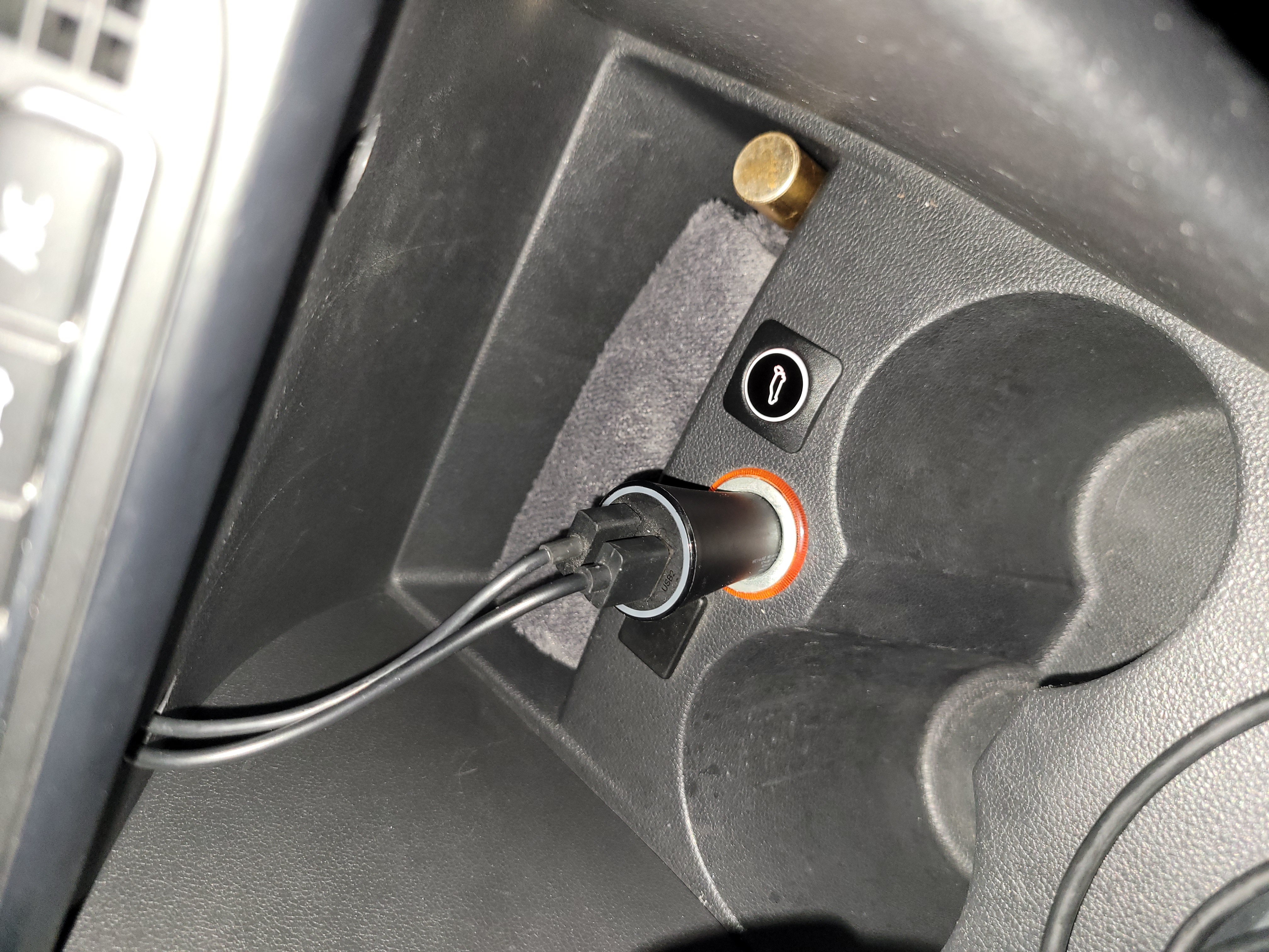

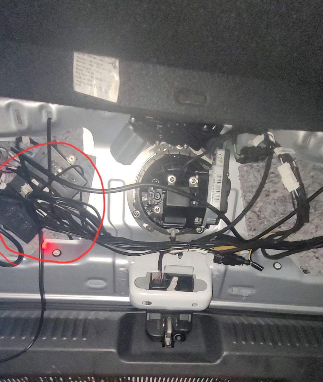

Fourth, wire and install the control unit.
Now, enjoy the automatic tailgate

A small question, it seems that the car body suffers a bit in the area of ​​the part for the gas spring, or that paint chipping is from the factory or some repair?

it seems like Vinyl Wrap to me.
Posts: 9037
Re: Automatic Tailgate
giannis20vt wrote: Thu Sep 19, 2024 2:15 pm it seems like Vinyl Wrap to me.
🤦‍♂️...ok, it's everywhere.👍😊
btw. actually the paint likes to peel around the vw emblem swtch on rear lid. starting from inside edge
Yes, that's inferior vinyl wrap (matte silver).
I applied it less than a year ago and I plan to apply a new TPU wrap this year.
