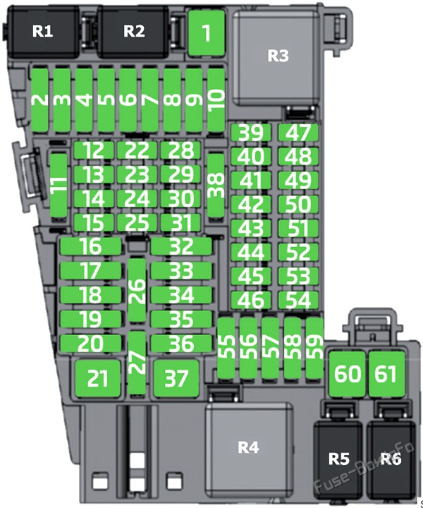

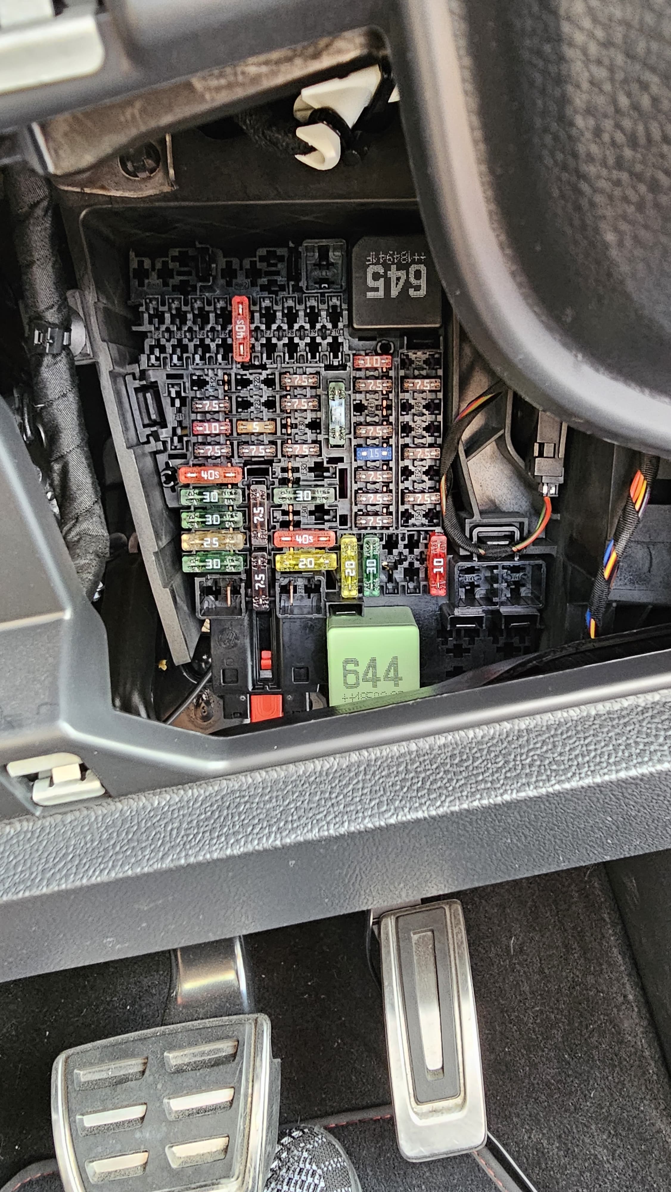

Hi everyone,
I'm having an issue with my 2019 VW Polo GTI AW.
The washer pump has stopped working, though both front and rear wipers are functioning fine.
I've checked the fuses and diagrams, which indicate F58 should be the relevant fuse. However, there's no fuse in that slot, and there doesn't seem to be an electrical connection there to hold a fuse in place.
F58 7.5 A Windscreen and rear window washer pump
Has anyone encountered a similar problem or have any ideas on how to troubleshoot this? I'm stumped and would appreciate any suggestions.

Silence when washers acivated, no whirring from pump. Pretty sure it's a blown fuse but fuse isn't in the position it's meant to be!

Its exactly 7.5 A and its missing from your picture, did you put there 7.5A fuse?
I changed mine few weeks ago. Wipers will always move when you try to wash windshield, but if you cant hear the pump while outside, its either fuse or the pump.

I hate it when people raise issues and never come back with any sort of resolution so here's mine,hope it's of some help to someone in future...
I eventually took it to a garage and they confirmed the relevant fuse was SC43 but mine was ok (that was one that I'd checked anyway). My problem was simply (but expensively) that that the pump motor had blown, replaced and all working now.
However, based on the way that mine was put together, I wouldn't want to guarantee that the above will be relevant to anyone else.
Regards
Pete
