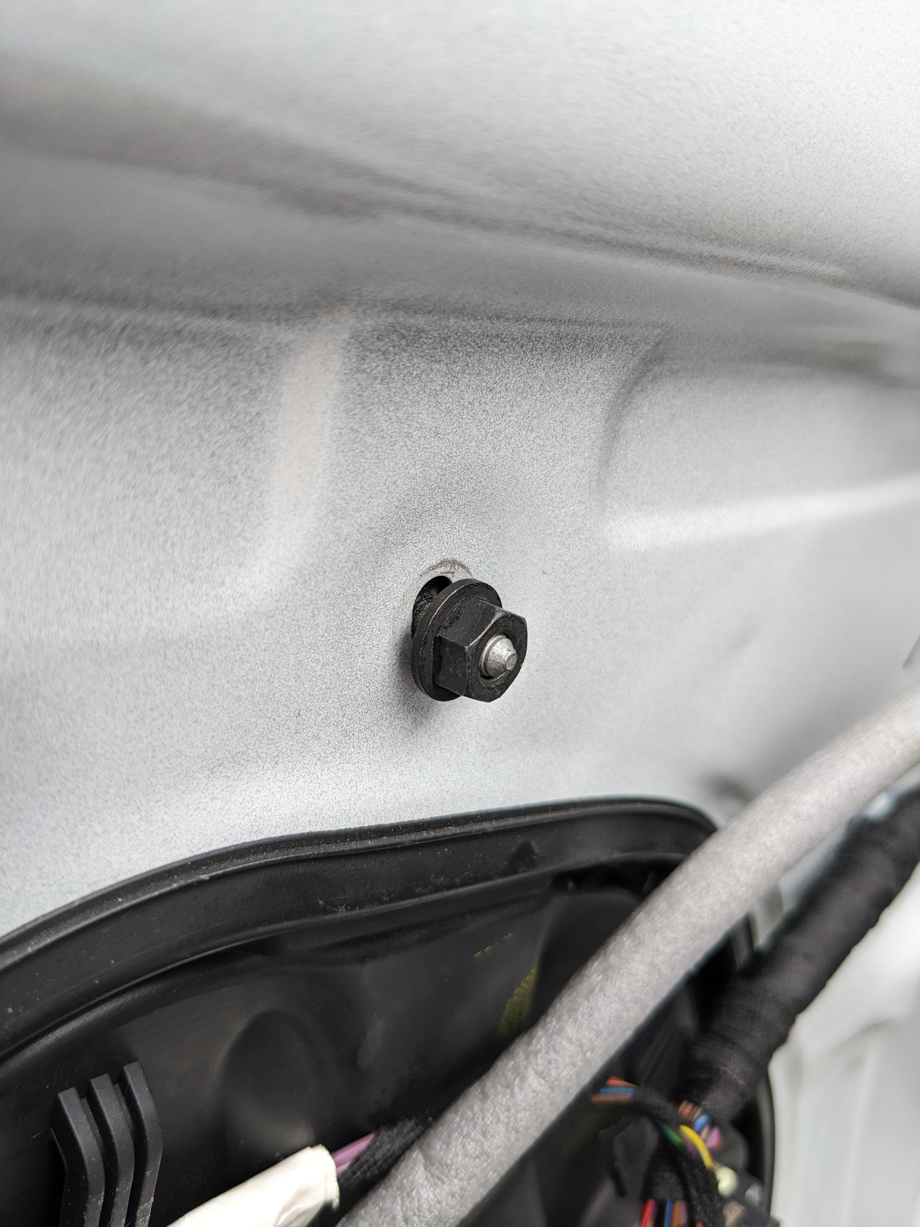

2226 wrote: Mon Oct 21, 2024 2:07 pm The heigth adjustment mechanism? Really, they were loose? I need to check mine. I never use that lever.
Yeah, plastic gets brittle and wears out, but honestly the car is too young to be having these noises.
The cards creak along the top. I will eventually put some foam tape padding along there when I get to the sound deadening.
Yup, just like that:
All 4 nuts on the 4 door were no tight anymore.
Mine is 10 years old and sleep outside.
I have 170000 km (105633 miles) and also I'm lowered since 3 years now (eibach spring).
On the top ? Can be the inner seal, I have the same issue. I ordered them few day ago now, I'm waiting them to replace and make them silent.
