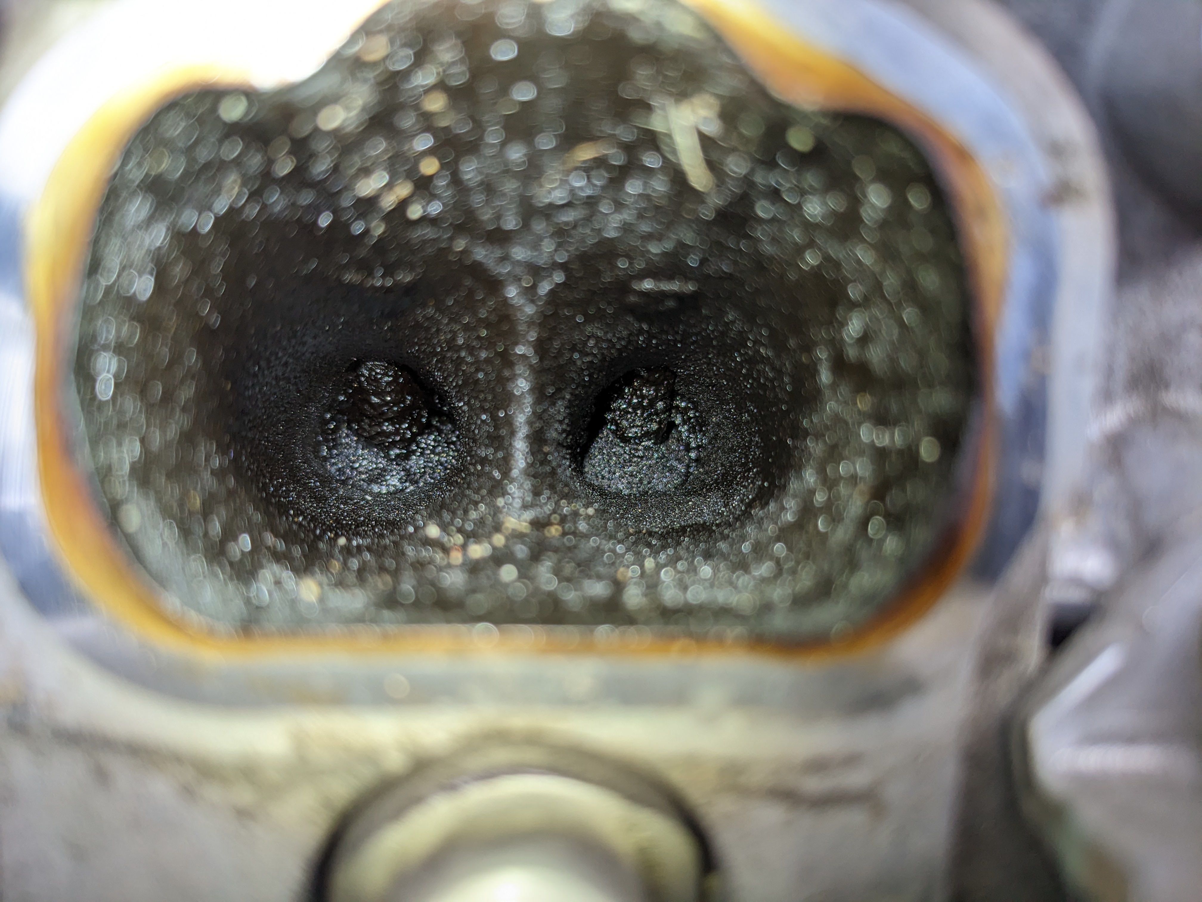

Le_Combattant
Posts: 514
Location: France
Re: Help needed with 6r cbzb engine 77kw cooling system.
Post by Le_Combattant »
This, carbon on the intake ports:
Retali
Posts: 114
Joined: Sun Aug 18, 2013 5:13 pm
Post by Retali »
Le_Combattant wrote: Sun Dec 01, 2024 2:20 pm This, carbon on the intake ports:
Thanx! How did you end up cleaning it ?
Soda blasting (or similar) in a workshop ? or did you do anything yourself ?
Le_Combattant
Posts: 514
Location: France
Retali wrote: Thu Dec 05, 2024 9:45 am
Ice blasting, company service (250 euros).
