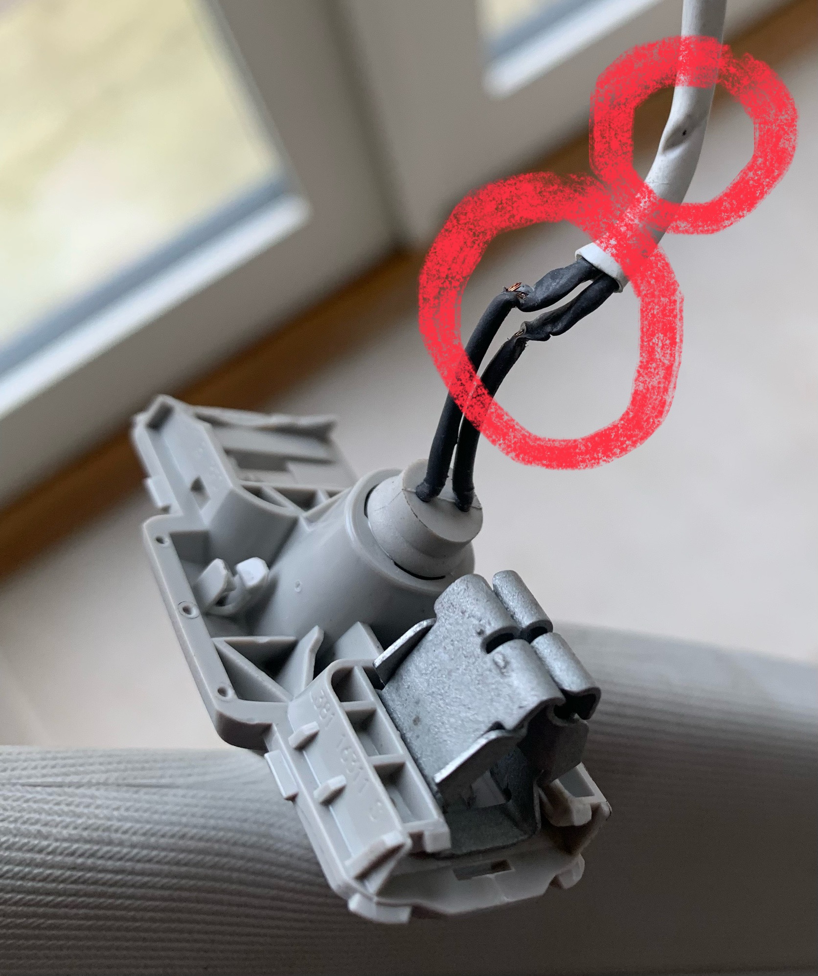

Some progress...
My independent guy pulled out the front left sun visor (a sod of a job in itself, apparently) and found this pinched wiring which was causing the short. It could well have been badly installed at the factory. The sun visor remains unplugged and I will find an eBay replacement.
Interior lights then started working but when I re-started the car after paying there were no lights...
VCDS was plugged in and he ran an Output Test which got the lights working again until I got home and switched the engine off. Now the lights don't work again.
I wonder if the system is unhappy that the connector to the sun visor mirror slide switch is unplugged?
EDIT: Or could the short have damaged the BCM?
