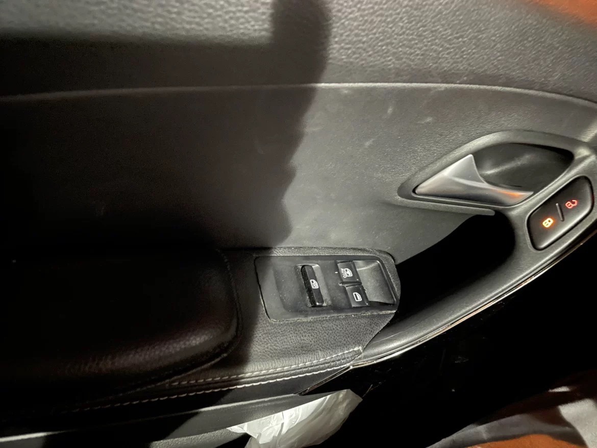

There are only 2 window switches that control front seat (L & R)
I want to add the rear seat switch (L & R) to the driving position, how can I do this?

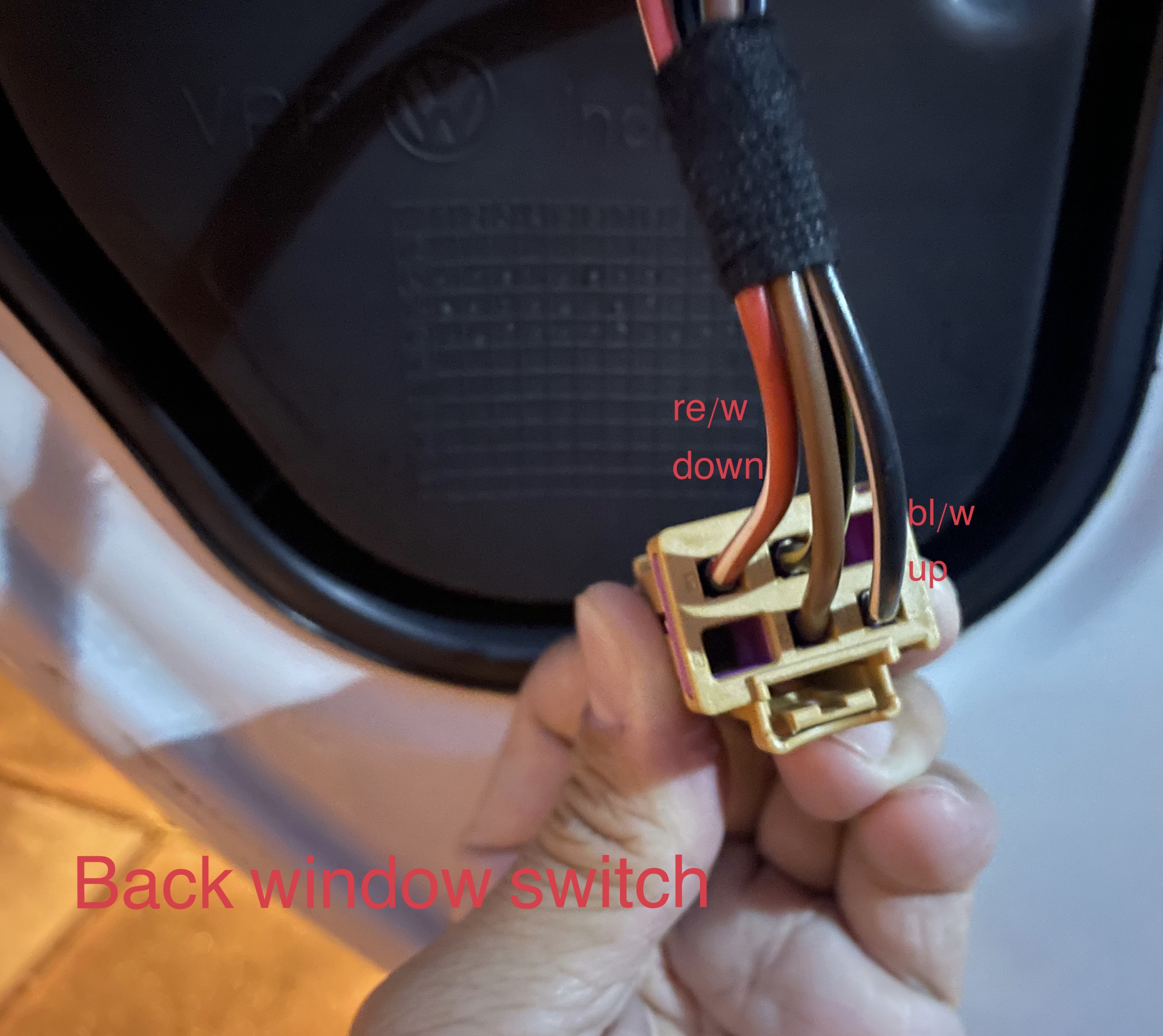

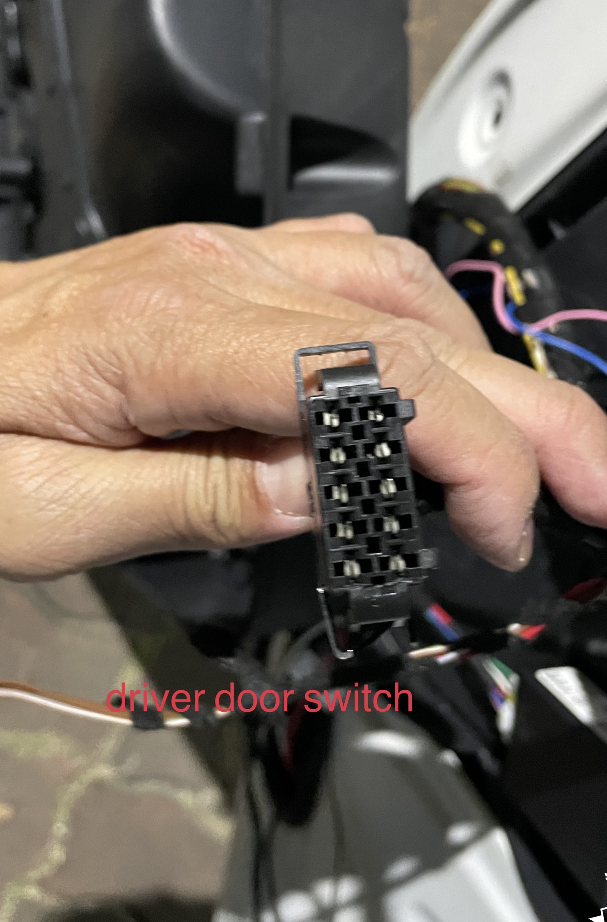

I think it's not easy, because my driver's door switch only has 10 pins, and the rear seat switch only has 4 pins.
- IMG_5016.jpeg (2.33 MiB) Viewed 4998 times
- IMG_5017.jpeg (1.19 MiB) Viewed 4998 times
- Posts: 9037
Re: 2016 POLO 6c Window switches
It is definitely more complex, that is why we asked for the Autoscan -more info-.
Due to the connectors you show, the technology/components applied for the 6R in Taiwan - supposedly for the Chinese market - is different from that applied for the 6R in the European market. We could say that the technology is somewhat older, which is not synonymous with worse.
As I suggested, you need to have the wiring diagrams for the 6R Taiwan model to compare with the 6R Europe model, so you can decide if this modification is possible.
