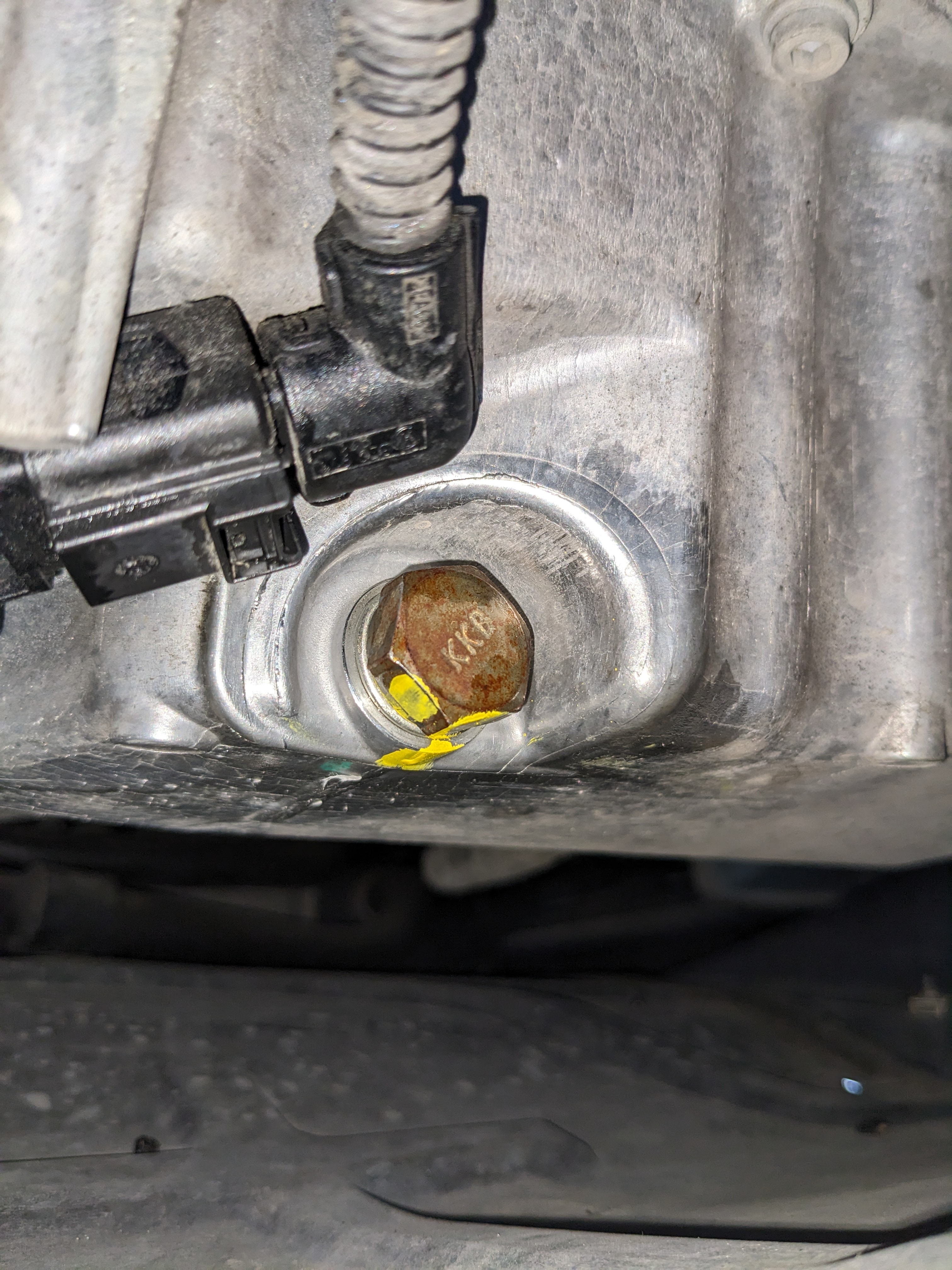

Well, 2025 start very...well.
180720 km on the clock, time for an oil change today.
Every thing is normal.
I changed the filter, fuel filter and the seal around the drain plug.
Time for thightening to 30Nm as per VW Workshop Manual.
And here is the issue.
Oil sump threads are gone. I hand tight first and after making contact, set my torque wrench to 30Nm and start the final torque...that never came.
I don't know what happened. The seal (metal one) did his job of deforming itself but the drain plug fail (or oil sump threads failed).
Torque was increasing as normal and from a second, bolt became loose...
I had a cold sweat. I finish my job, put the 4L of oil required and return back to home (40min of driving).
No issue at all, no leaks.
But I'm pretty f****d now.

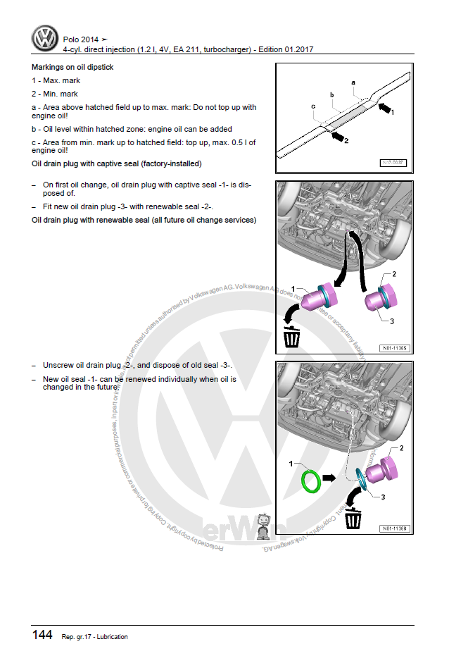

Now, going by my official VW workshop manual, at the first oil change, the original "plug with captive washer" gets thrown in the bin, and a different type of sump plug gets fitted along with a "use once" rolled washer.
I've forgotten what our local VW dealership in UK did to my wife's August 2015 1.2TSI 110PS engined Polo, but I have always used the correct drain plug and correct rolled washer - but I did initially only buy 2 of these correct drain plugs, and swopped them over at service time - fitting a new sealing washer every time. Then, maybe at the year 7 or year service 8 service, I noticed that the plug could be initially easily unscrewed before becoming tighter as it was being removed, so at the next oil change, I cleaned up the threads in the alloy sump with a correct size tap, quite a few small bits of alloy were removed, but the sump plug fitted more easily - ie smoothly.
At the next service, I fitted a new drain plug and threw away the 2 that I had used previously - I'll probably buy another new one, at each of the pre-paid services within the initial new car 3 year warranty period, the "scope of work" work sheet that I demanded that I was given by that VW dealership, showed that a new plug and a new washer was being fitted at every service - how true that was I can't say, so maybe VW Group discovered that re-using steel drain plugs in alloy sumps was now not a good idea, and it was me repeatedly re-using the same 2 plugs that caused a build up of damage to the alloy sump threads, who knows!

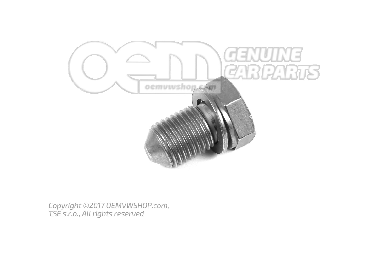

And yeah you are right, here is the PDF from VW: And I have this drain plug: N90288901 but there is aslo these one, same part number:
So, I'm sure it's not the one from factory, it's the second type, shorter or something else.
And with it, the crush washer. Always renewed.
"how true that was I can't say, so maybe VW Group discovered that re-using steel drain plugs in alloy sumps was now not a good idea, and it was me repeatedly re-using the same 2 plugs that caused a build up of damage to the alloy sump threads, who knows!"
If it's correct, the WorkShop Manual is wrong so, and I have followed it.
Because I aslo notice that I could screw it by hand but after few turn (3-4) it's started to be more hard. But I was aware because I had the same "issue" during the last few oil change.

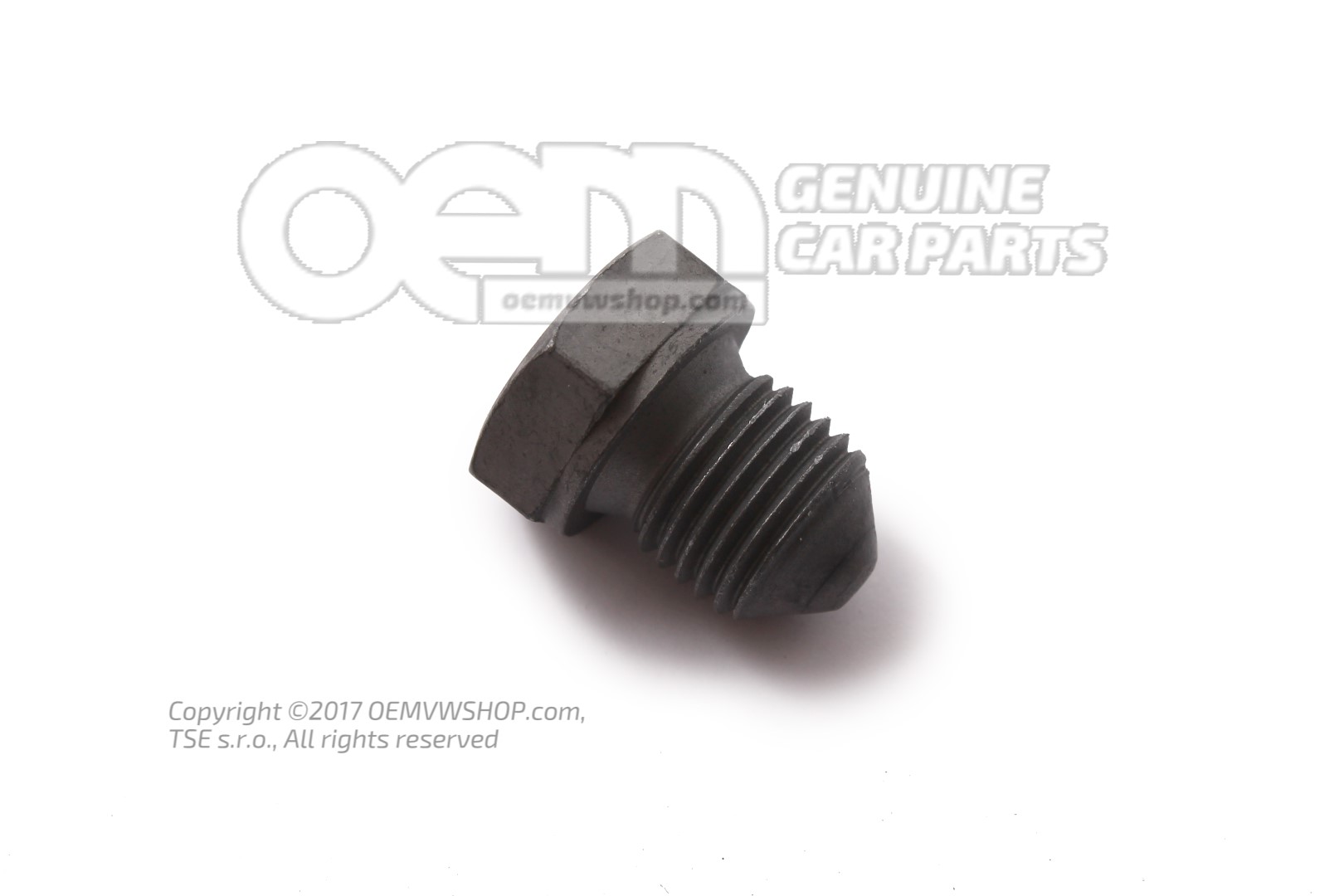

Mine was never replaced by the dealership.
I only became aware of the different sump plug when I noticed a leak.
The captive washer plug always had a tight spot to it when fitting or removing.
I bought 2 different sump plugs from my aftermarket VW part supplier. They too were unaware that those need changing.
The non-captive washer plug they gave looks like the same thing fitted to my mk1 Golf.
Much shorter than the original. If it's correct, who knows. Should be since I went in with part numbers.
I fitted the replacement captive washer during that service though as I completely forgot to actually buy the copper crush washers.
It will be going in on the next service.

Correct drain plug is N 902 889 01 and the correct rolled sealing washer is N 013 815 8, when anyone calls a sealing washer a "copper washer" I think about thick solid copper washers - this is not the correct type for these engines, a rolled maybe alloy washer is what is needed to make sure that you seal the drain plug using the correct tightening torque.
On the subject of getting rid of the swarf after re-tapping the drain plug hole, just add some fresh oil into the engine while the drain plug is still out and that will flush any swarf out through the open drain plug hole.
