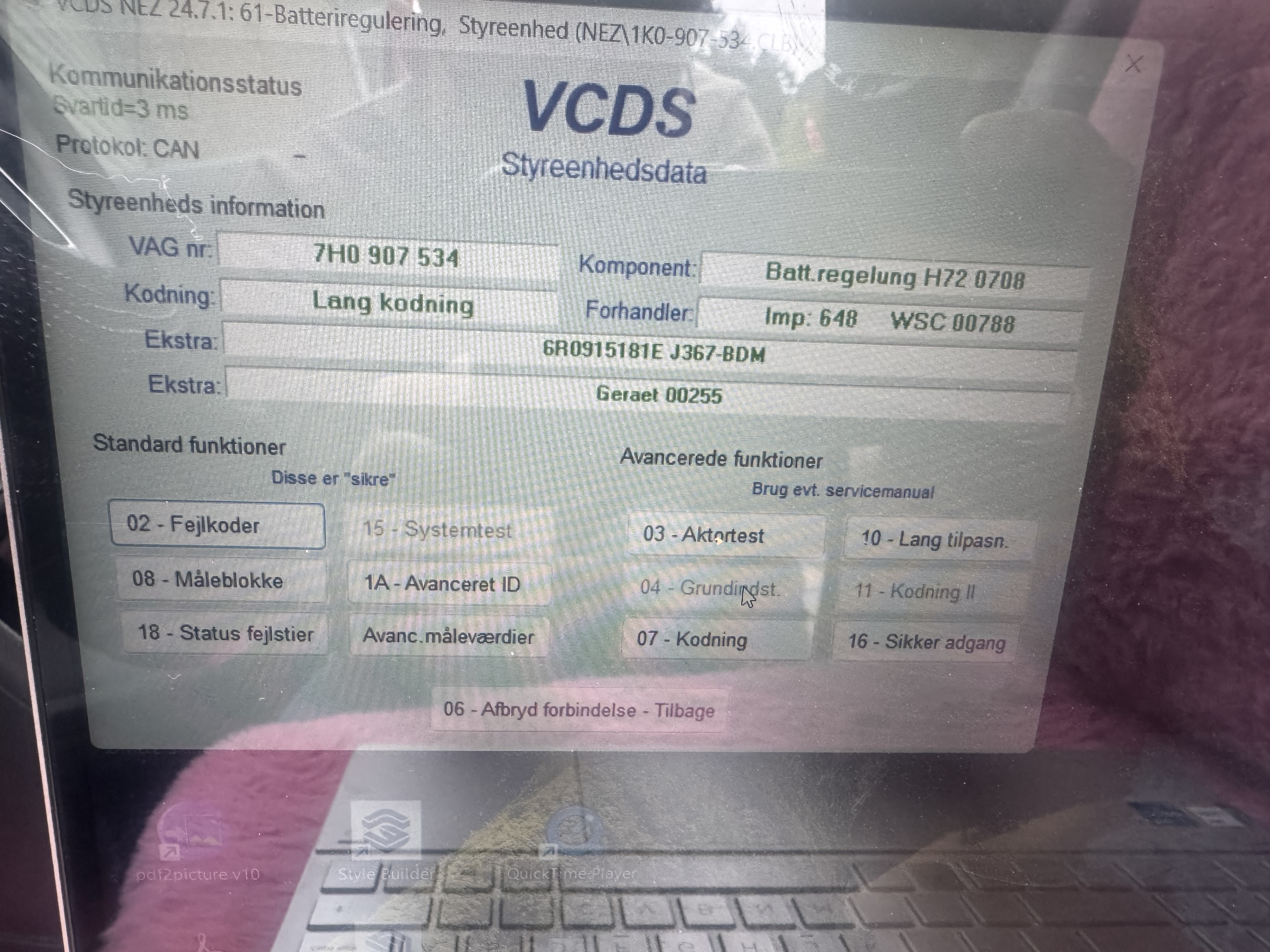

Thx for the reply’s.
It wont let me do 04 basic, so i guess it will adapt as i go, hopefully
Anything else i can do maybe?

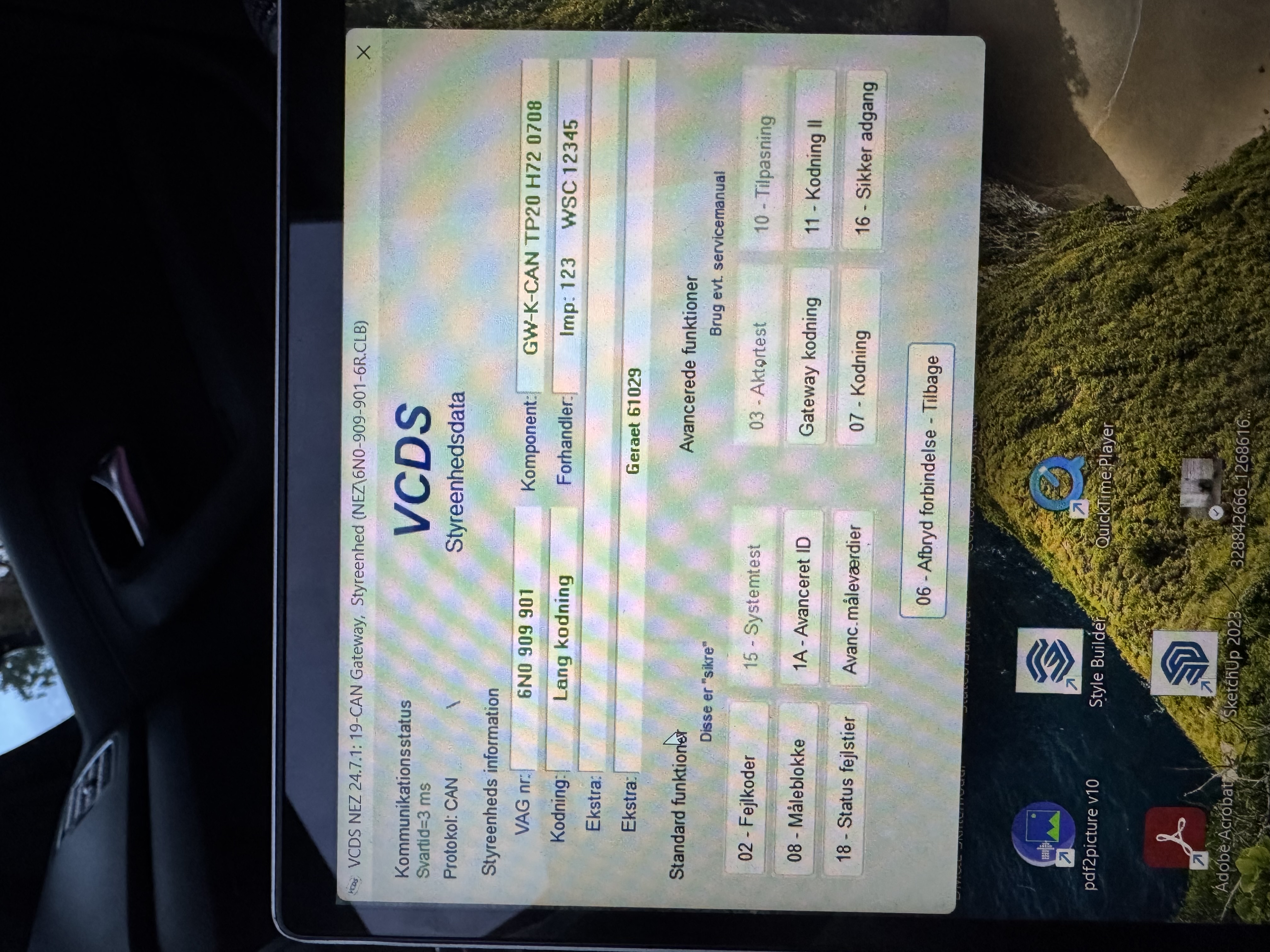

Try to find the Basic Setting of the Alternator/Generator voltage regulator at 'Address 19' Gateway, NOT in Battery Monitoring Control Module (Batteriregulering) 'Address 61'.Peachbutt wrote: Sun Apr 20, 2025 4:57 pm Thx for the reply’s.
I guess VCDS won't provide you with a guided function once you enter the Basic Setting, so you should try to follow the sequence indicated in my video with ODIS... but with VCDS.

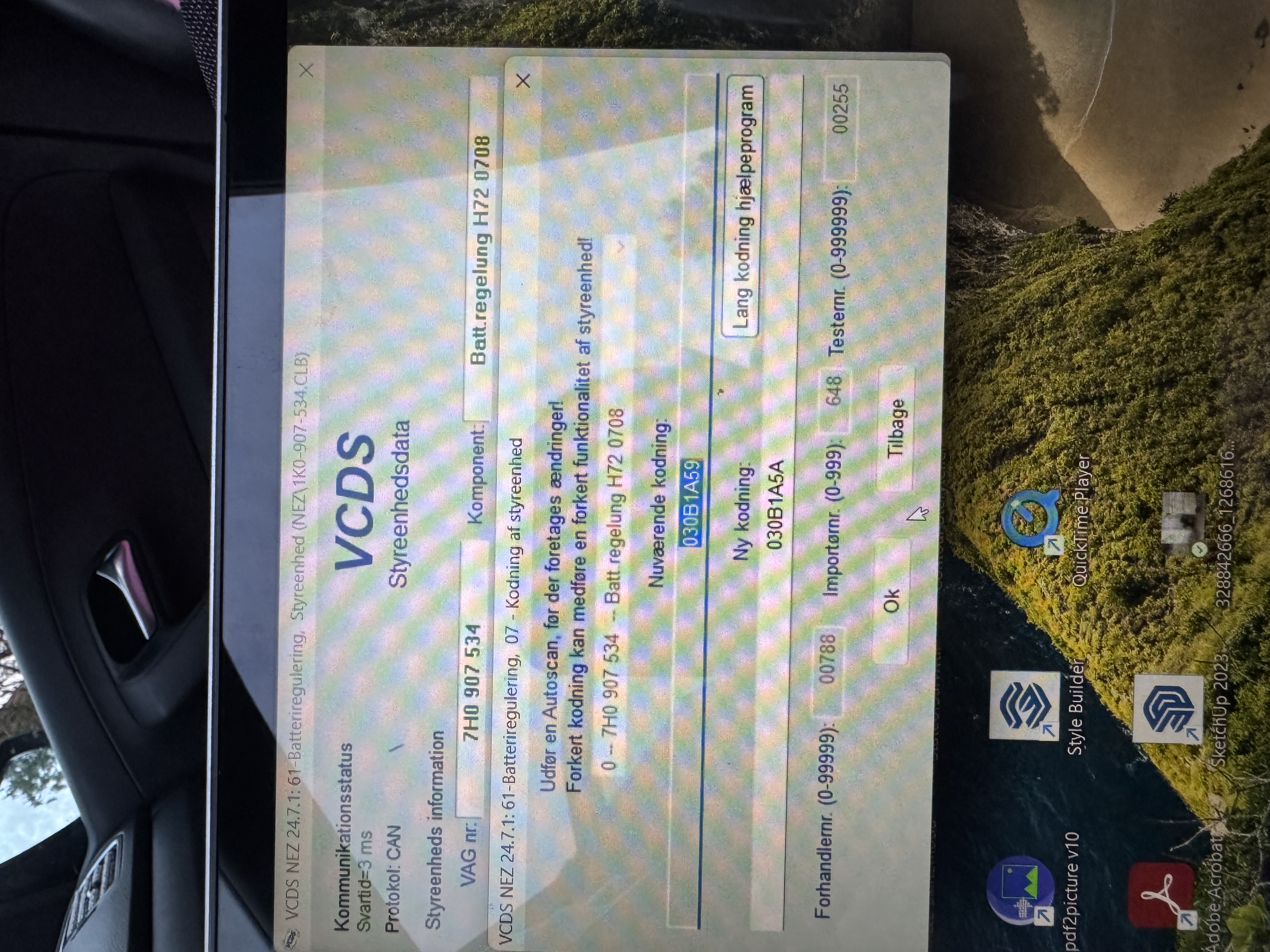

It wont allow me to do basic setting in can-gateway
I checked the coding for the alternator and it showed a diff gearing then yours.
Ao i changed it for yours instead, dont know if it will change anything

Generator Gear Ratio is the result of dividing the crankshaft pulley outer diameter by the alternator pulley outer diameter.
After reviewing a few AutoScan 6R 1.2TDI Bluemotion models, the most common hexadecimal values are 5A HEX and 59 HEX.
This is important for proper alternator operation across the entire rpm range.
For a short period, monitor the alternator's performance as you did. If there are no improvements/changes, return to the 59 HEX value.
I assume you don't have information on the part number of the reconditioned alternator...?
