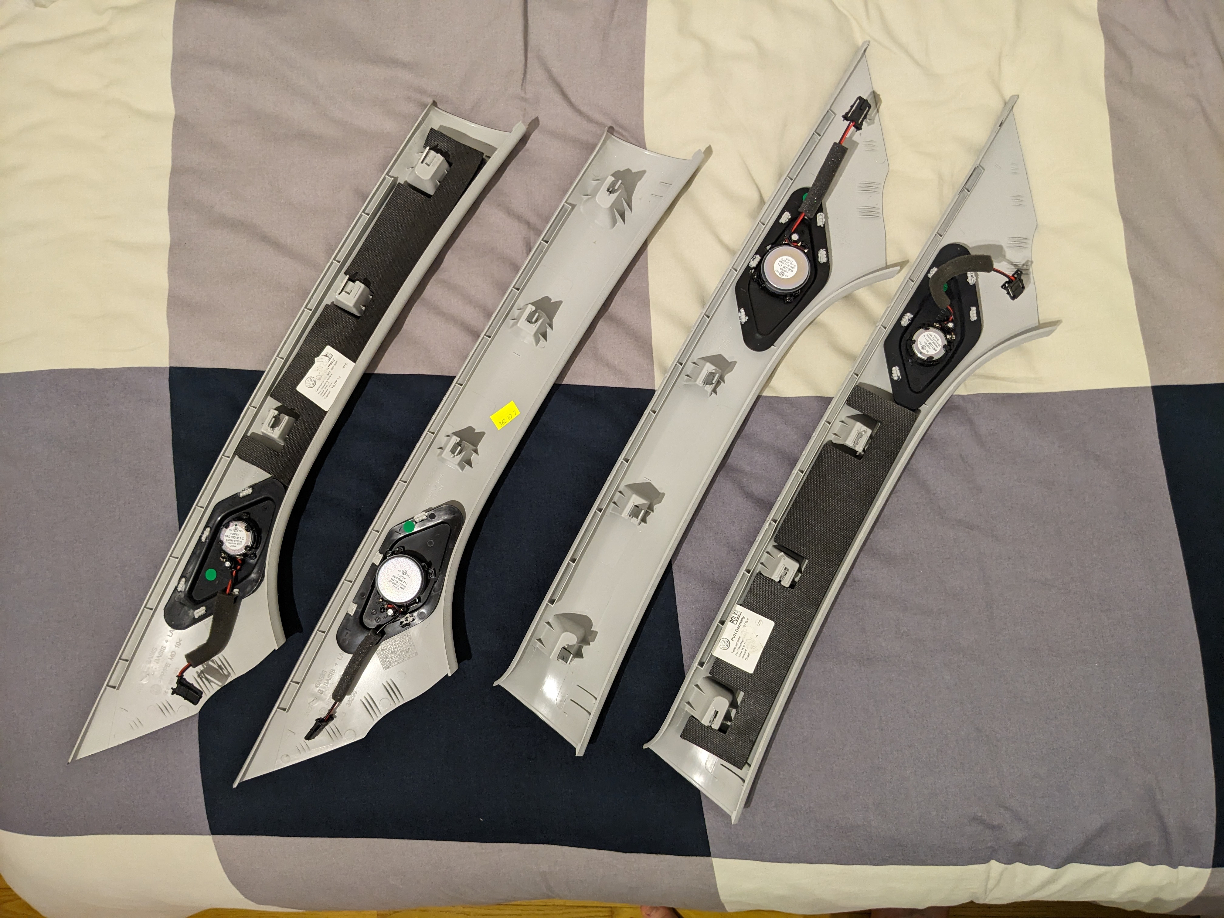

Hello all !
At the begening of 2025 I had to buy new "A" pillar trim because of broken clips support.
Those pillar were original from factory and the plastic was quite brittle and broke very easely.
So I went to my dealership and bought two new A pillar part. Quite expensive one.
And today, during cleaning I decided to check the part, I noticed one thing: the foam
On the new parts: there is no foam.
Part number of the original part of my car are:
-6C6867233B Y20
and
-6C6867234B Y20
and the new one are:
-6C6867233H Y20
and
-6C6867234H Y20
So a revision yes, speeker is bigger and with lower internal resistance (4Ohms vs 8Ohms).
New part looks good but the assy that maintain the speaker is rattling (bad plastic solder I suppose).
What's wrong with this brand ?
Also, what's I don't unterstand is that, Parthaus is also selling those part, same part number as me (H revision) and those parts have the foam installed.

Well over a 15 years ago I worked for a small software company that did the part procurement/tender process for VW. Tenders would go out to several companies looking for the cheapest production cost. I actually saw the result of this process when buying 2 rear frame rails for a mk1/citi golf. The difference in quality between the 2 parts shows how VW cheaps out on the parts as the cars age and how some manufacturing partners really do a rubbish job once they get the contract.
If VW has to stock parts for discontinued models you know they're going to stock the cheapest part they can get.
Those are probably from 2 different suppliers and one of them didn't bother to fit or include the foam.
Can you even remove that foam without damaging it and transfer to the new part?
Otherwise you should just be able to buy similar foam sheet and cut to size/shape.
Epoxy or hot glue will fix the loose plastic. Still an unacceptable thing to be doing to a new part though, but is what it is.
Interesting about the speaker though. I wonder why those were changed for 4ohm. Almost like the tweeter is swapped for a small mid-range which also looks to be mounted lower. Could make a big difference to the sound. How deep/tall is that new speaker compared to the old one?

2226 wrote: Sun Aug 10, 2025 10:02 pm Well over a 15 years ago I worked for a small software company that did the part procurement/tender process for VW. Tenders would go out to several companies looking for the cheapest production cost. I actually saw the result of this process when buying 2 rear frame rails for a mk1/citi golf. The difference in quality between the 2 parts shows how VW cheaps out on the parts as the cars age and how some manufacturing partners really do a rubbish job once they get the contract.
Thanks you for your very interesting feedback. This world is driving me crazy.
From what I know, those part are coming from the same supplier.
The same brand is quoted on the plastic mould.
The only think I noted is this:
6C6 for the original one
6R6 for the new one "H' revision
EDIT: I tried with iso alchool: it's a mess.
The chemical reaction dissovls the foam in a total mess.
Man, those two part cost 150 euros.....And if there is foam is not for nothing.
And unfortnutallery, it's impossible to remove like that. Maybe I should try with isopropylic alchool to remove the glue.
Or try to buy new one on Part Haus (I will be sure there is foam, according to their pictures) or my dealership but there, I will be not 100% guarenteed to receive part with foam.

IPA with mess that foam up. That foam should be for noise isolation. Doubt that'll be there for rattle or vibration prevention since the foam probably weighs nothing. I'd just buy some open-cell foam and cut to shape and glue that in. Open cell foam better at noise blocking and that area shouldn't have any fluids going through it so closed-cell foam not needed.
Most car audio places or hardware should have some decent open cell foam.
But at those prices, if they can get a replacement then even better.

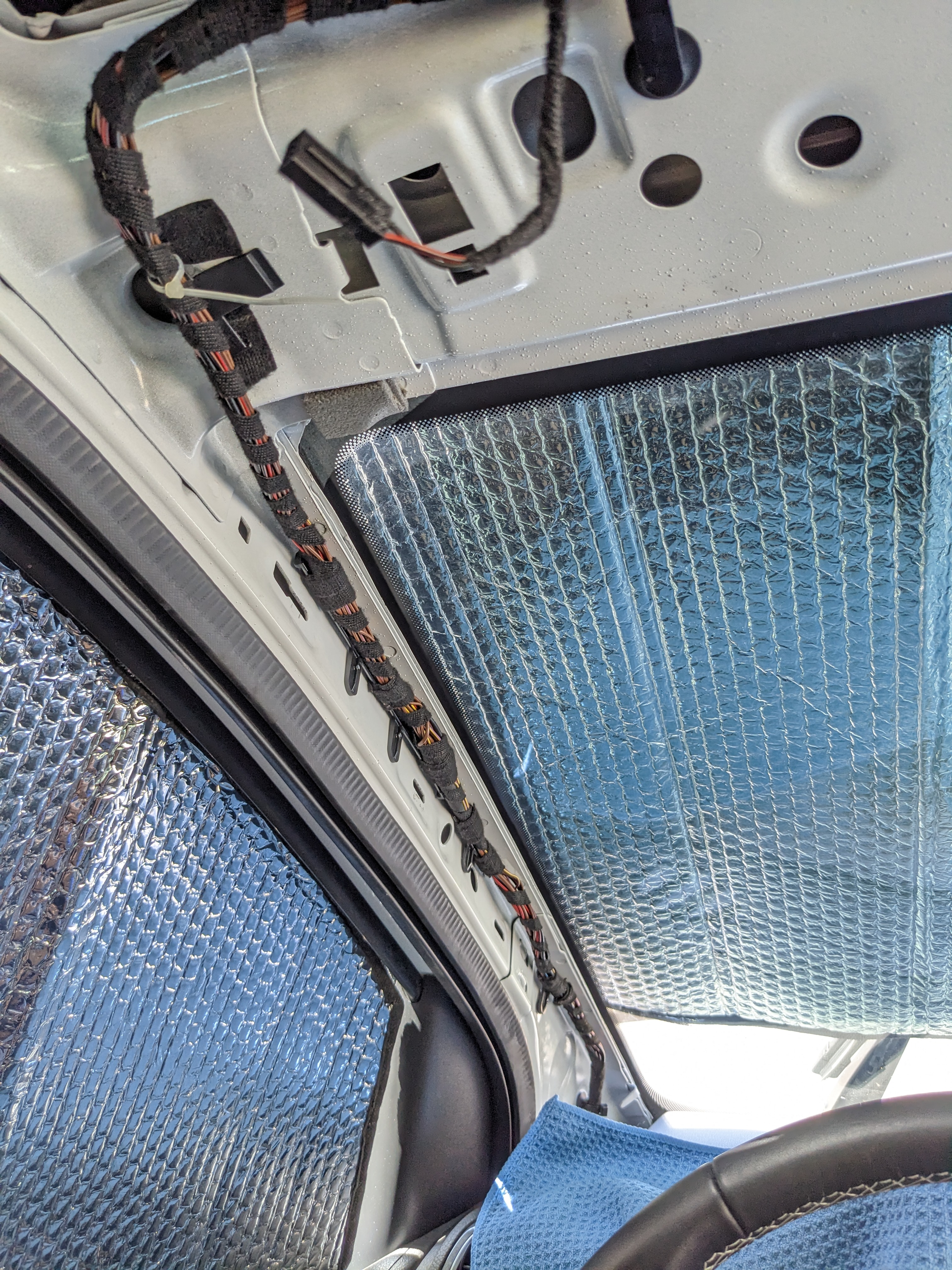

Le_Combattant
Posts: 514
Location: France
Re: VW part reduction cost ?
Post by Le_Combattant »
2226 wrote: Mon Aug 11, 2025 2:37 pm
iichel wrote: Mon Aug 11, 2025 12:49 pm 233B
4X1 Side airbag in front
6NW Unsplit molded headliner
4X0 Without side airbag
6NA Unsplit molded headliner
0A2 4 doors
233H
8RA Without speakers
A8G Sports comfort equipment
L0R Right-hand drive
8RL 6 speakers (passive)
8RE 4 speakers (passive)
Perhaps the one with foam is for airbags in the a pillar?
Interesting. I have 4X1, 8RL and L0R. I could pull the pillar trim to confirm... but it's a lazy Monday.
The A pillar I removed are from factory (date match with the car production) and nop, she is not equiped with airbag in the A pillar as you can see:
