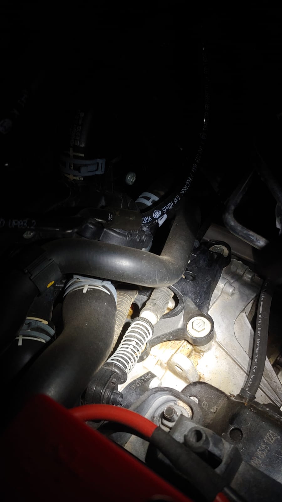

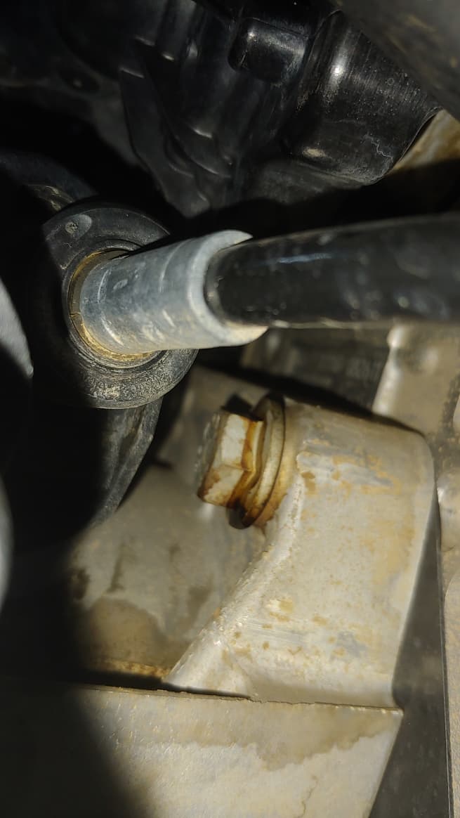

Was rummaging around the engine bay just a moment ago trying to figure out what brake master this car is fitted with (22.2mm or 23.81mm?), but then I looked at the top of the gearbox and found this:
Not so clear, I know. Don't have the proper lighting right now.
Can you see the oil?
The top rear part of the gearbox is wet. That bolt has oil on it and there's a bit pooled below the shift cable bracket.
This is on a CJZD.
Where could that be coming from in that area?
The water pump sits above that. I can't see any trail for where the oil is coming from.
Can't pull things off the car this weekend either, I need the vehicle on both days.

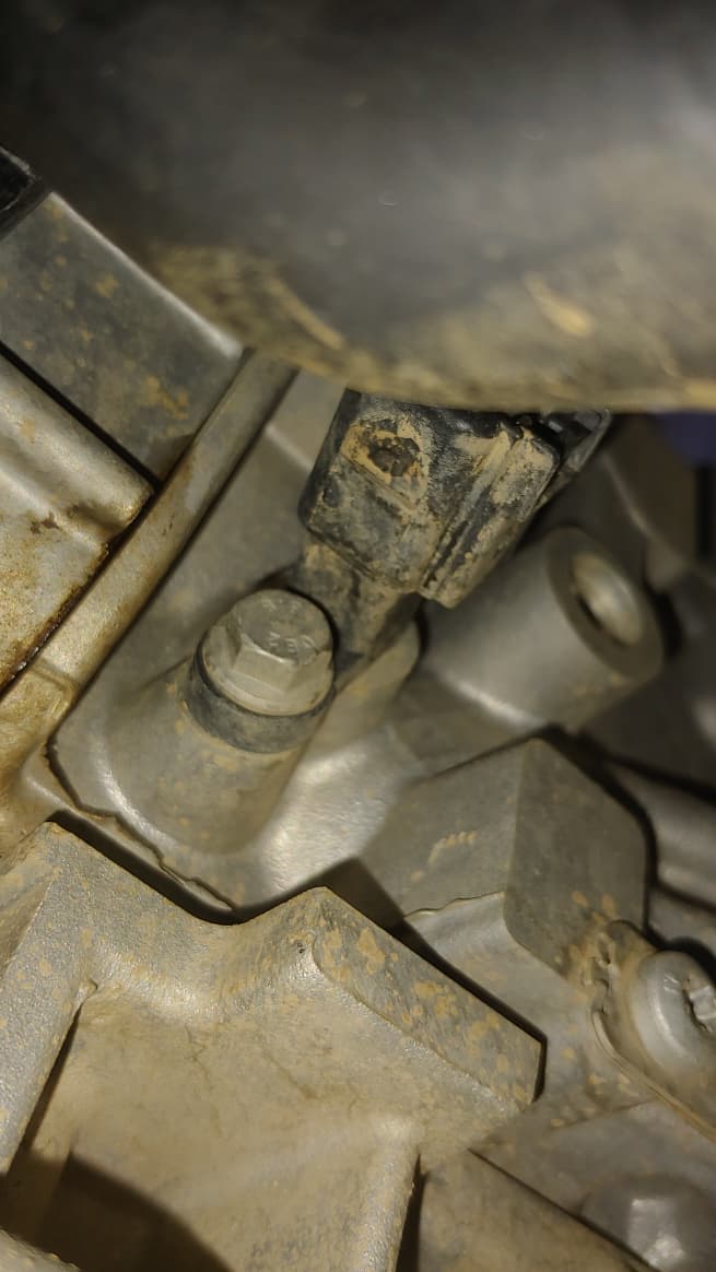

Some more photos I managed to get.
Bolt just below water pump.
Don't see a leak from above the bolt. Everything seems dry. Except in upper right of corner there is some sort of stain.

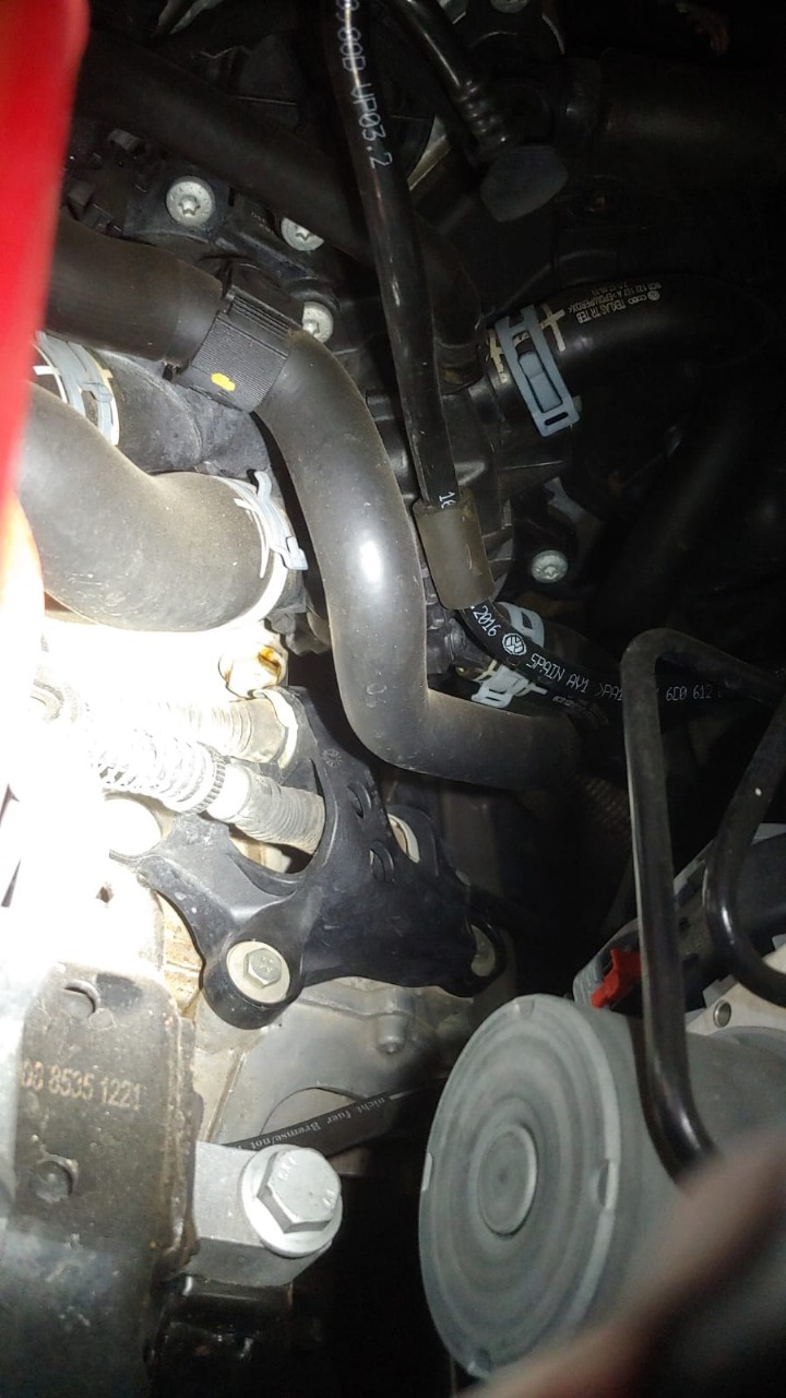

From back of engine. The oil boiled off this morning. Not sure if this blew down the back edge of the gearbox of whether it's coming from there.

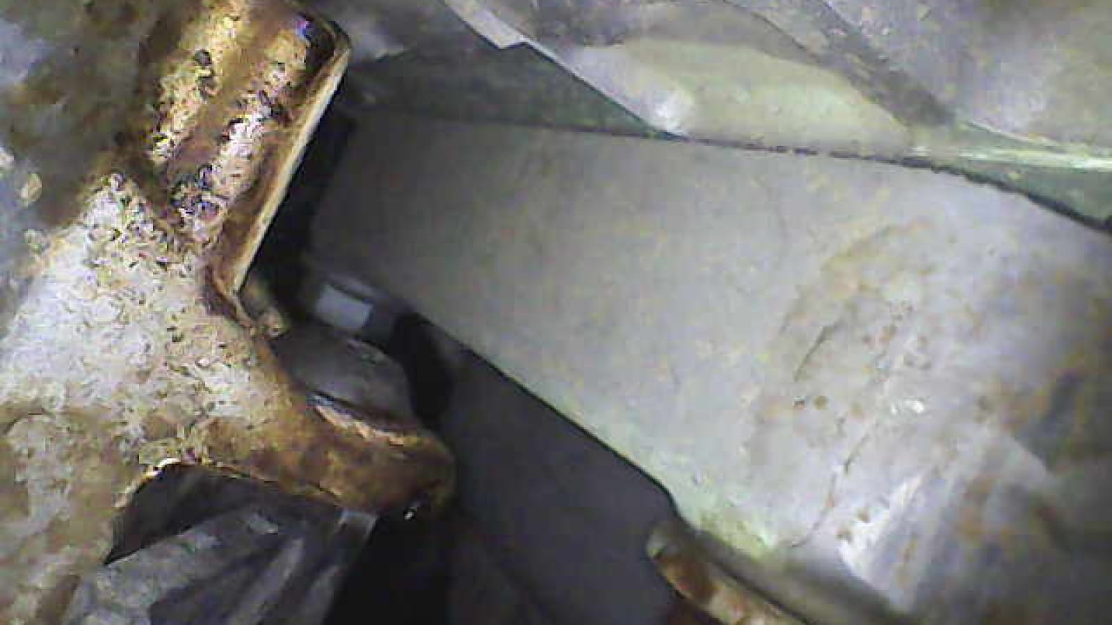

I would've responded sooner, but I was waiting for my el-cheapo Temu-special borescope to arrive. Actually fairly decent for the price.
Took this pic tonight:
Surface on right is gearbox top.
So yeah it's a water pump leak. Funny colour though. I swear it looks and feels like oil. Surely this should still maintain a coolant colour? I guess it cooks and discolours after leaving the pump. Hopefully nothing else causing it to discolour. The coolant in the overflow tank is still pink. Level has gone down, but not much.
I'll have to ask VW for a price on this part and new belt as well.
