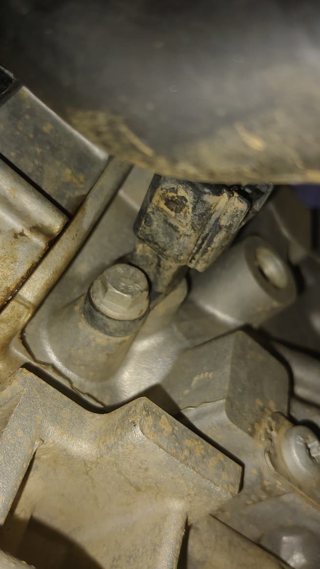

Was rummaging around the engine bay just a moment ago trying to figure out what brake master this car is fitted with (22.2mm or 23.81mm?), but then I looked at the top of the gearbox and found this:
Not so clear, I know. Don't have the proper lighting right now.
Can you see the oil?
The top rear part of the gearbox is wet. That bolt has oil on it and there's a bit pooled below the shift cable bracket.
This is on a CJZD.
Where could that be coming from in that area?
The water pump sits above that. I can't see any trail for where the oil is coming from.
Can't pull things off the car this weekend either, I need the vehicle on both days.

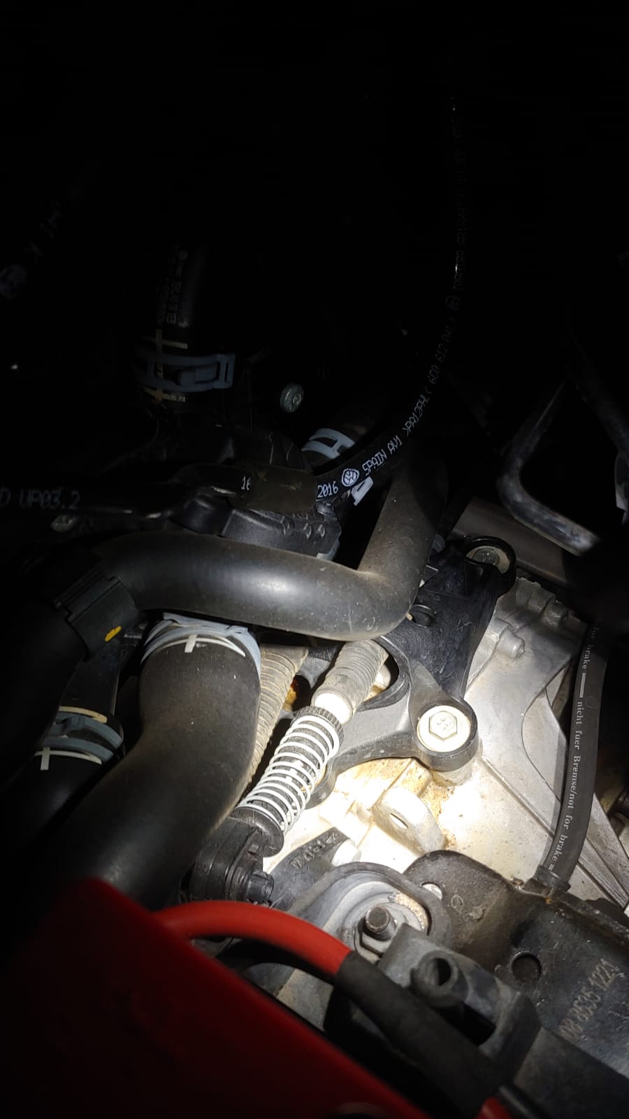

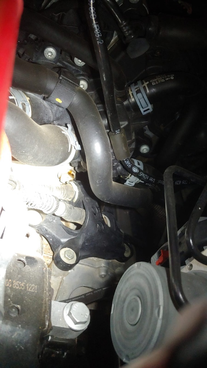

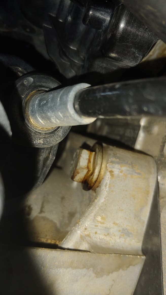

Some more photos I managed to get.
Bolt just below water pump.
Don't see a leak from above the bolt. Everything seems dry. Except in upper right of corner there is some sort of stain.
From back of engine. The oil boiled off this morning. Not sure if this blew down the back edge of the gearbox of whether it's coming from there.

Are you sure it's oil? It sounds like a typical water pump leak.
Hmm... oil doesn't evaporate easily...
Now you'll have to keep an eye on it for a while, which I'm absolutely sure you will.😄

Mine looked exactly the same last week, garage found that the water pump was leaking.....so Ciclo could be spot on (again...!). Worth keeping an eye on the coolant level in the expansion tank. The VW part was expensive but the garage (we've used them for over 30 years and trust them) say that the cheaper versions can come with their own problems.

I'd also put my money on a slightly leaky waterpump

Water pump on this engine are "well known" to leak.
By the past, some engine batch (EA211) were known to have defective water pump with early failure.
In your case, it's a just a very very small leak.
VW part's price is around 230 euros here is France. Sounds expensive, but It will peace of mind to replace it by VW brand than other cheap chiness no name product to re-do the job 3 months later.

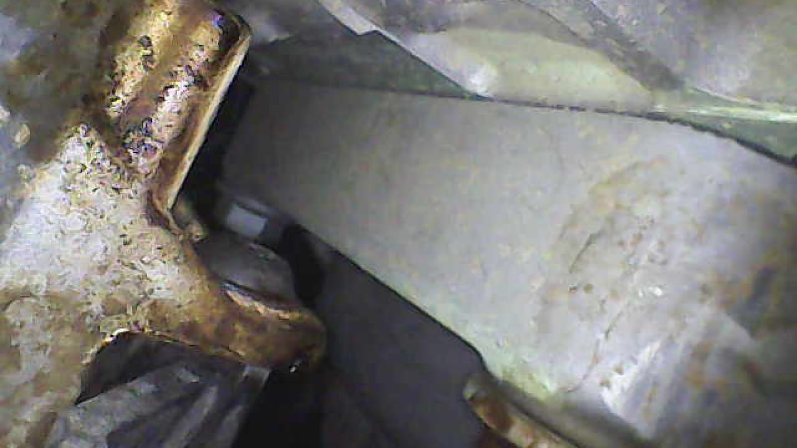

I would've responded sooner, but I was waiting for my el-cheapo Temu-special borescope to arrive. Actually fairly decent for the price.
Took this pic tonight:
Surface on right is gearbox top.
So yeah it's a water pump leak. Funny colour though. I swear it looks and feels like oil. Surely this should still maintain a coolant colour? I guess it cooks and discolours after leaving the pump. Hopefully nothing else causing it to discolour. The coolant in the overflow tank is still pink. Level has gone down, but not much.
