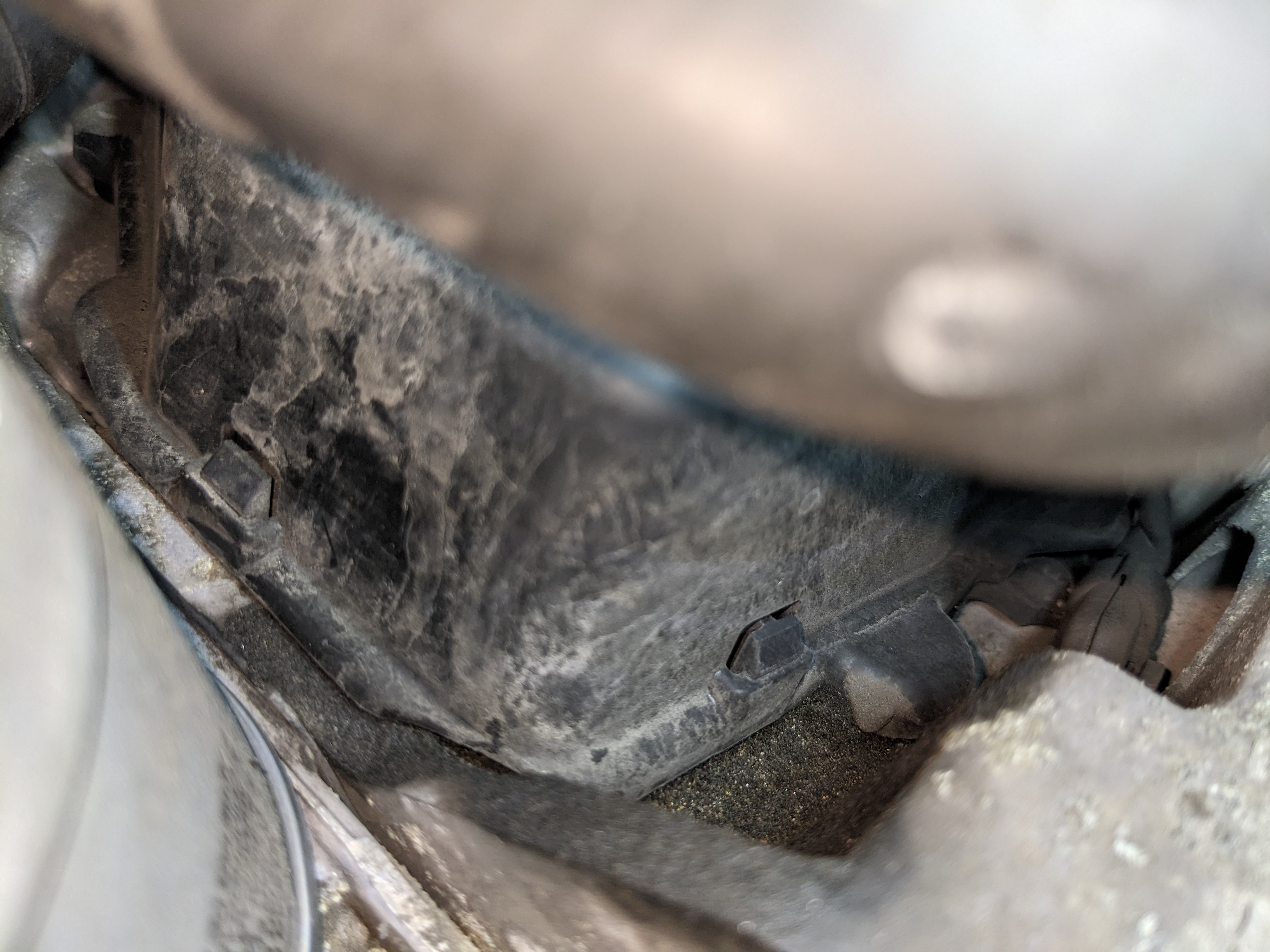

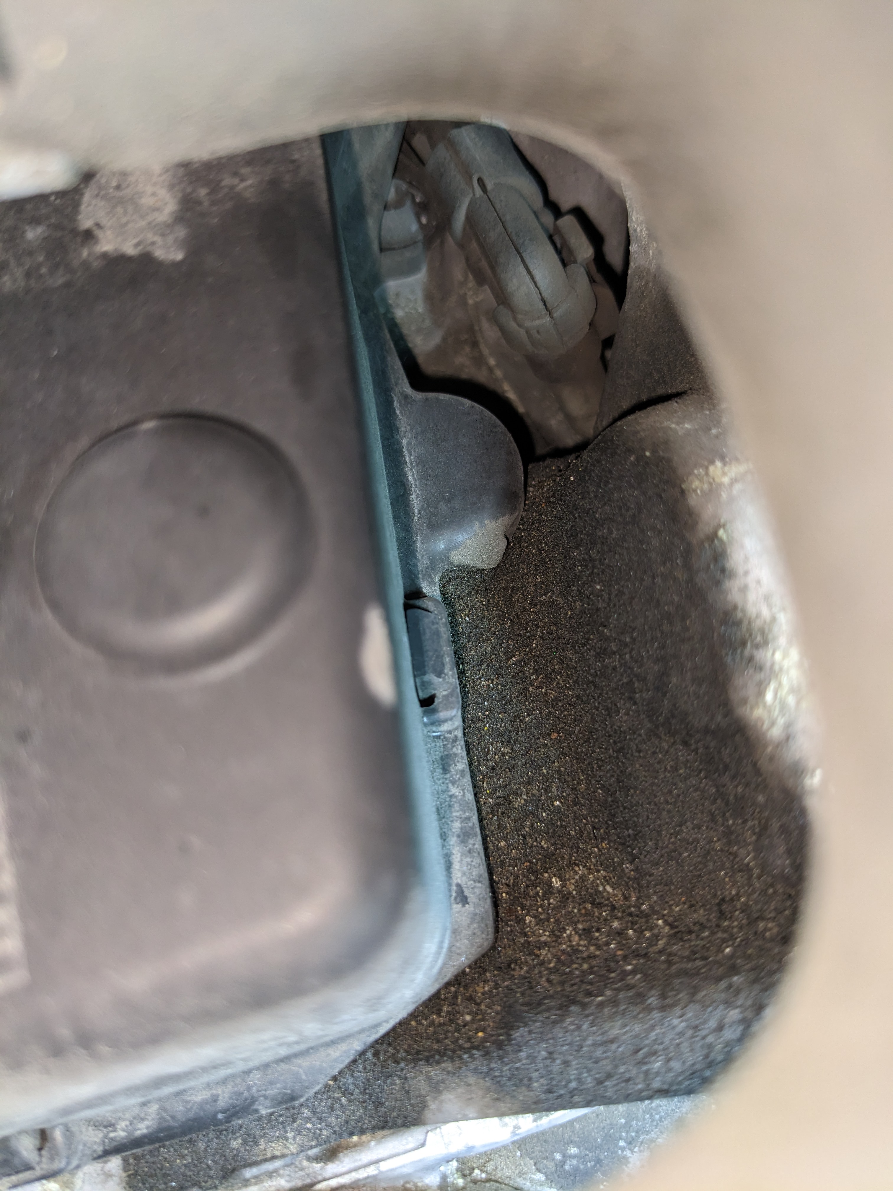

So I decided to check mine and found this:
Capture d’écran 2025-09-10 172213.jpg (142.38 KiB) Viewed 1120 times
From the small area I could see through the bonnet, it looks quite ‘thick’ visually.

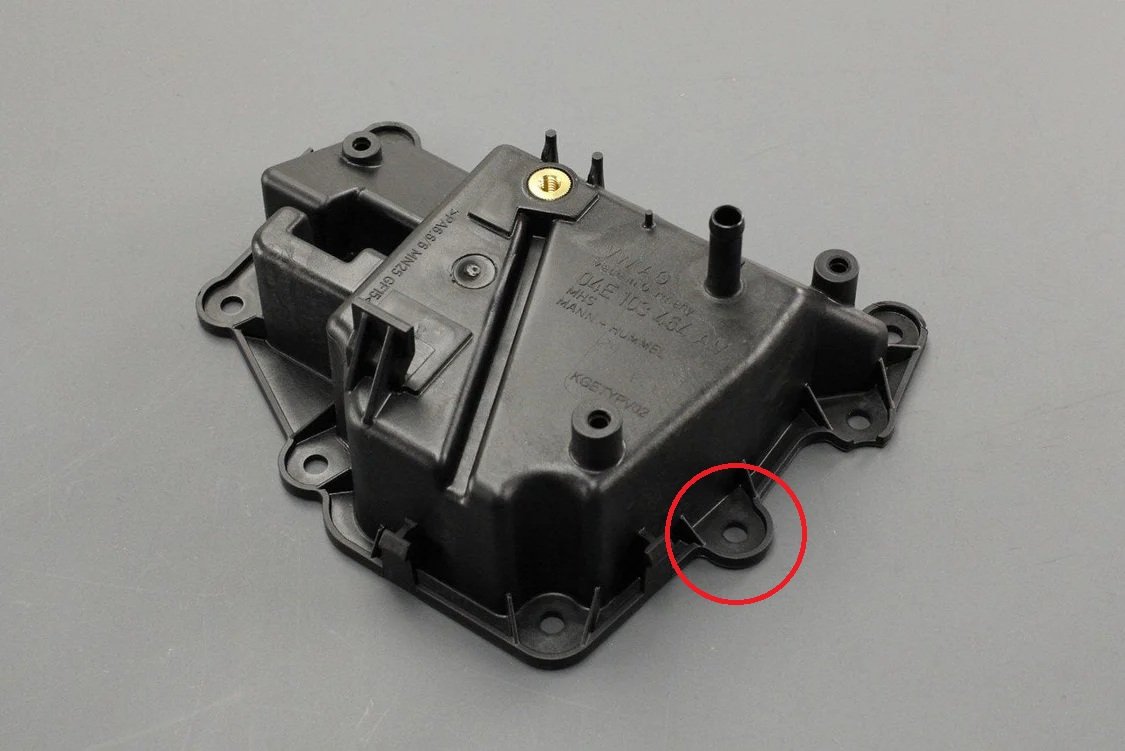

To give you an idea, the plastic semi-circle to the left of the socket corresponds to this:
So somewhere I have a leak. Nevertheless, I did the test by removing the oil cap from my block (engine warm, idling), and I have a ‘moderate’ suction effect (difficult to judge). In any case, when unscrewed, it does not fall out and remains sucked in by the vacuum.
Tomorrow I will see If I could go under the engine bay and getting a better view.
What do ou think ?

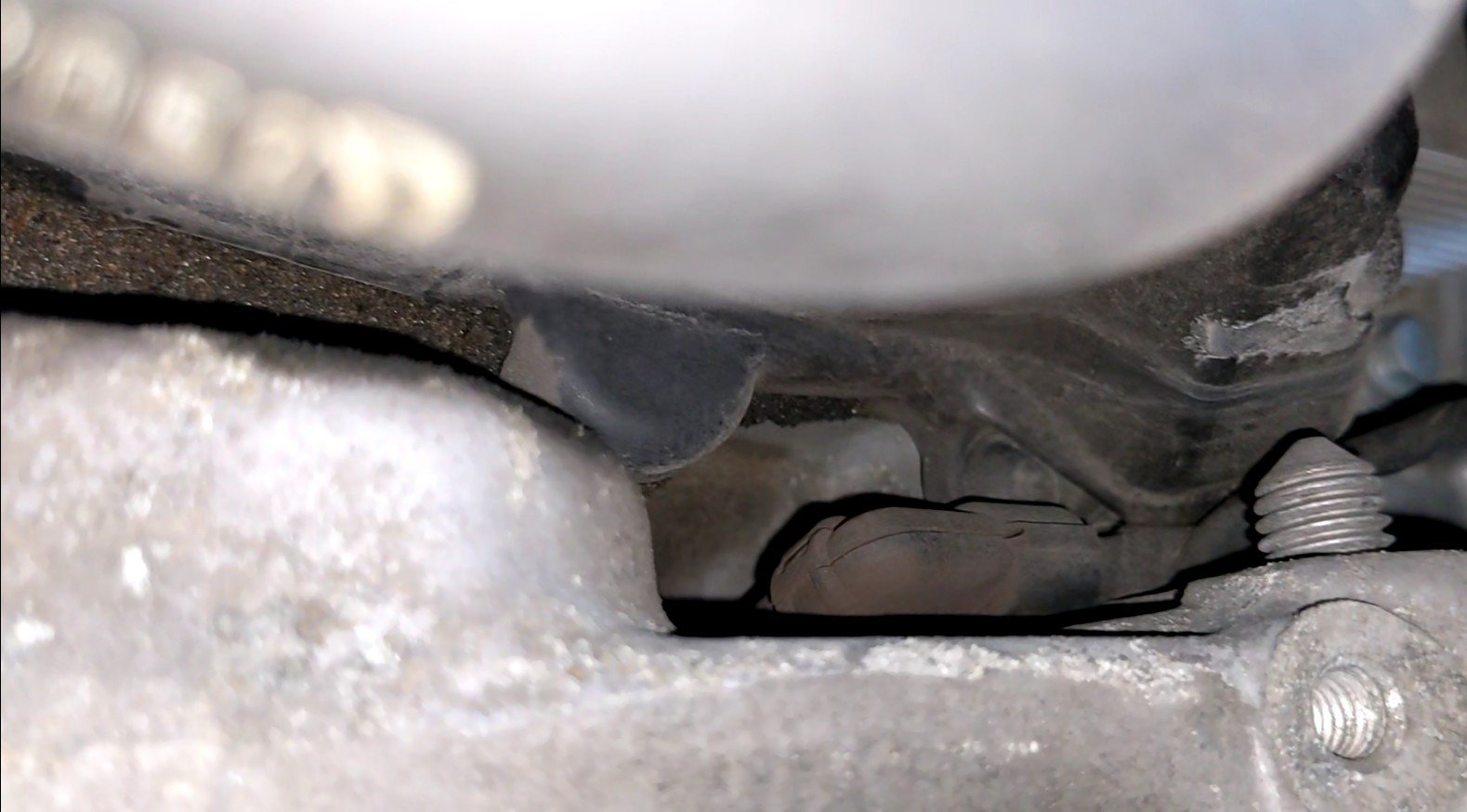

But yeah, mine is leaky as well:

That leak also looks minor. It's misting out of there. Looks more like road dirt. I have oil running past the filter.
As for it happening at low mileage... modern VW. Is what it is. :D

2226 wrote: Thu Sep 11, 2025 11:38 am That leak also looks minor. It's misting out of there. Looks more like road dirt. I have oil running past the filter.
For sure it's oil :shock:
I get my hand and grab the dirt, it's very oily.

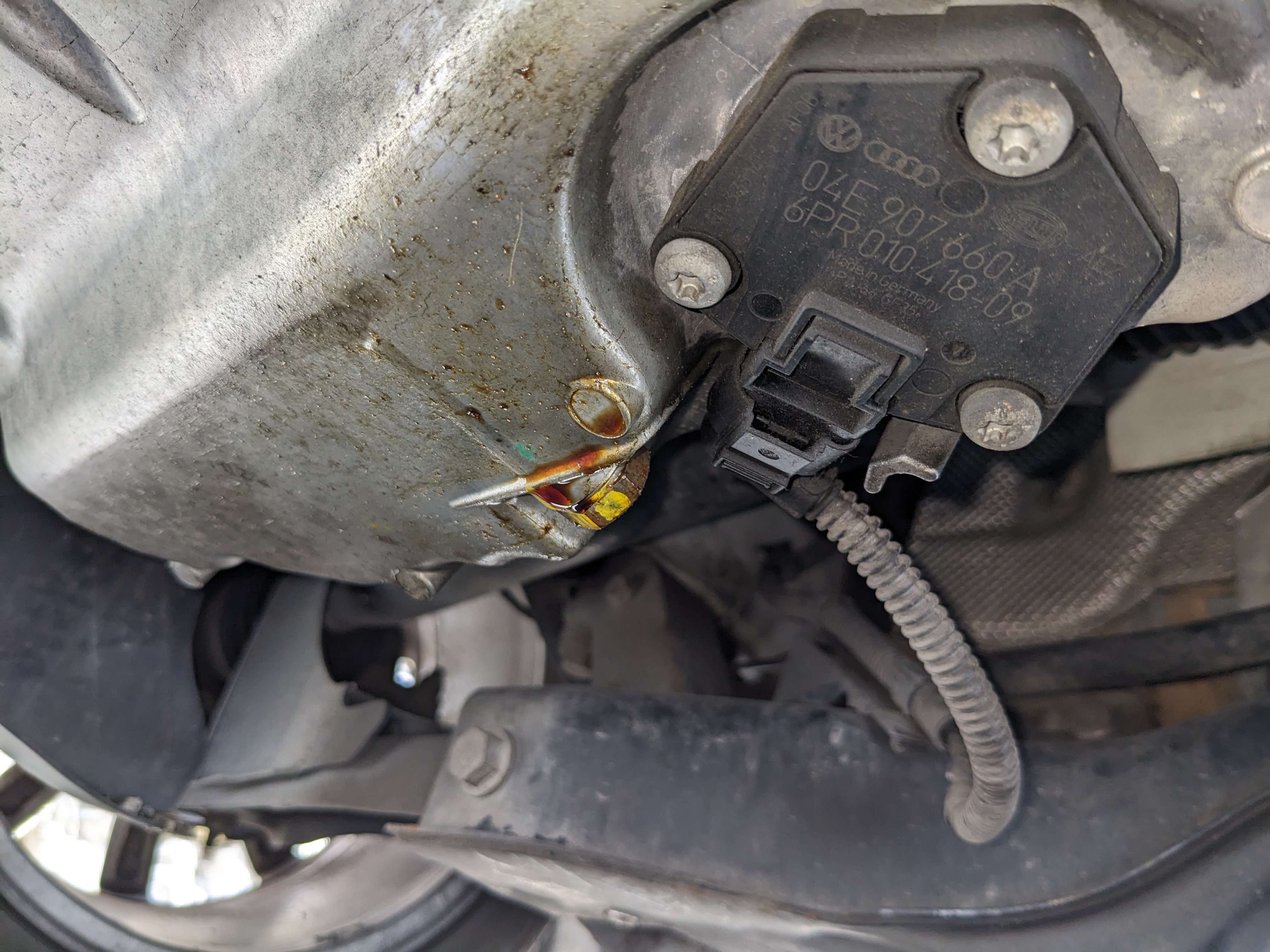

But now, I have to deal with my damaged oil pan and a nice leaks (because of the damaged threads):
2226
Posts: 561
Re: Oil separator leaking ?
Post by 2226 »
Fun times. :D
Look at that ... your oil sensor is connected! I still haven't figured out why 2014+ 1.2TSI down here have those sensors but not connected. VW forcing engine rebuilds. :mrgreen:

2226 wrote: Thu Sep 11, 2025 3:52 pm Fun times. :D
So, you have the sensor but not the wiring ?
2226
Posts: 561
Post by 2226 »
Yes.
Confirmed on a few other 6C as well. Sensor fitted, no wiring.
At one point I thought the plug might just have been ripped off my something on the road, but in fact there is no wiring to it.
I have no idea why VW did this. Probably cutting costs. Engines were complete, but cut the wiring.
Maybe too many people complaining too often about low oil level. :mrgreen:
