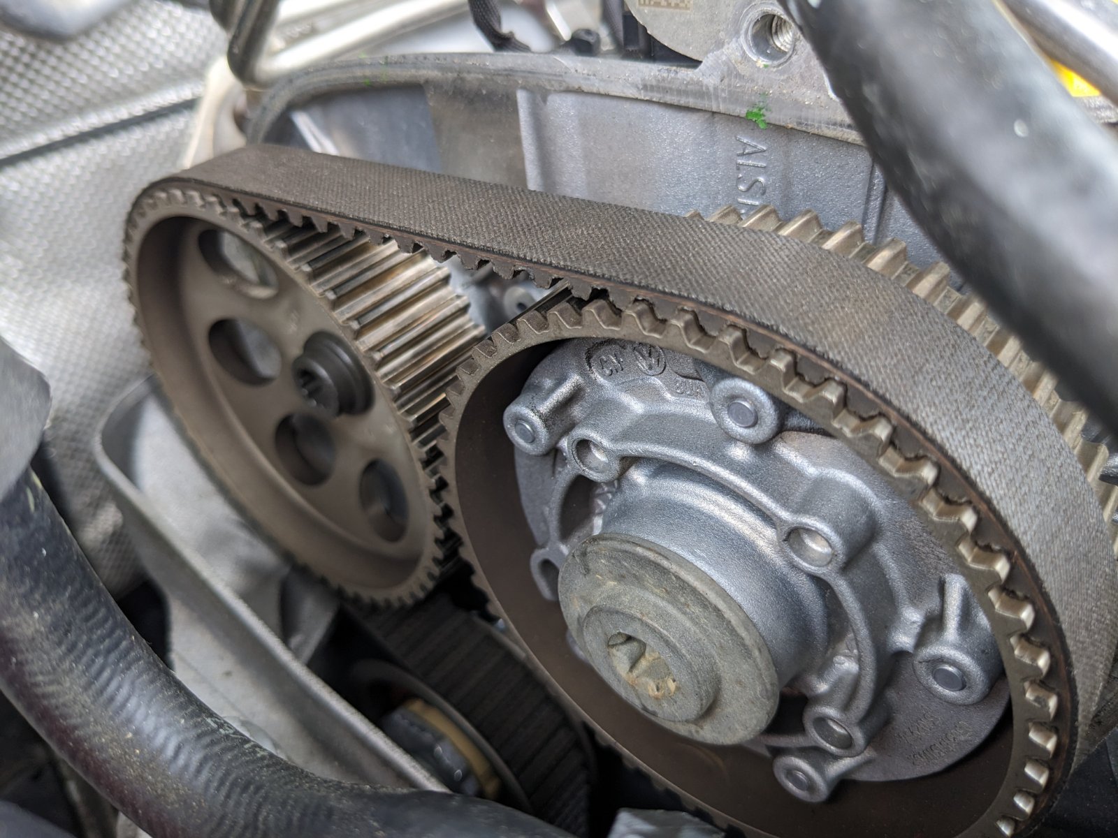

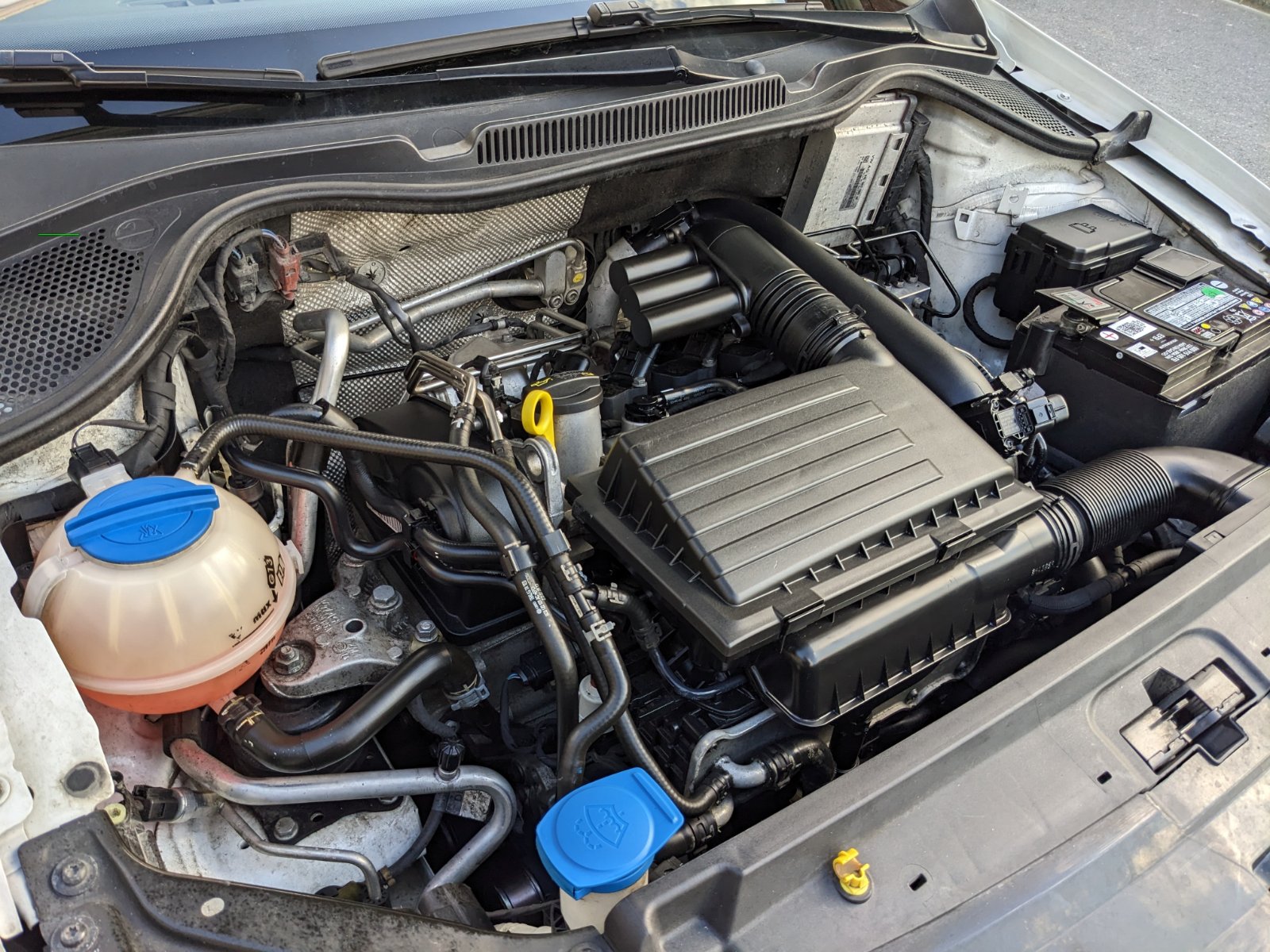

Here is a photo taken last year:
The EA211 belts are reinforced with fibreglass, which makes them particularly resistant.

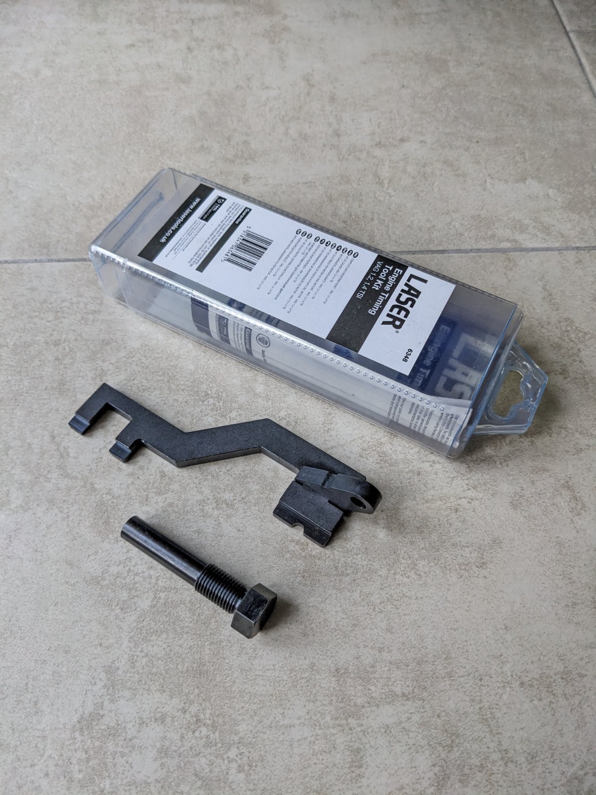

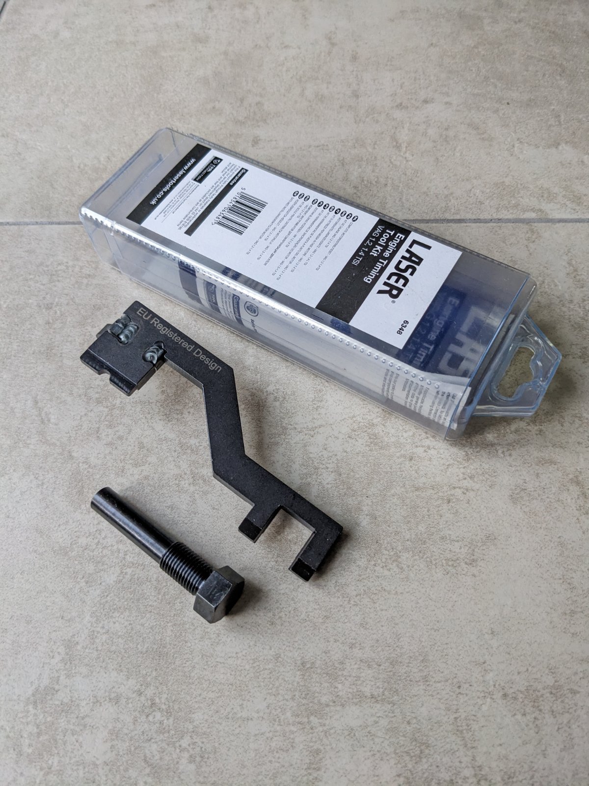

At the time, I purchased the T10340 and T10494 combo from LaserTools. It seemed to be the best option in terms of quality.

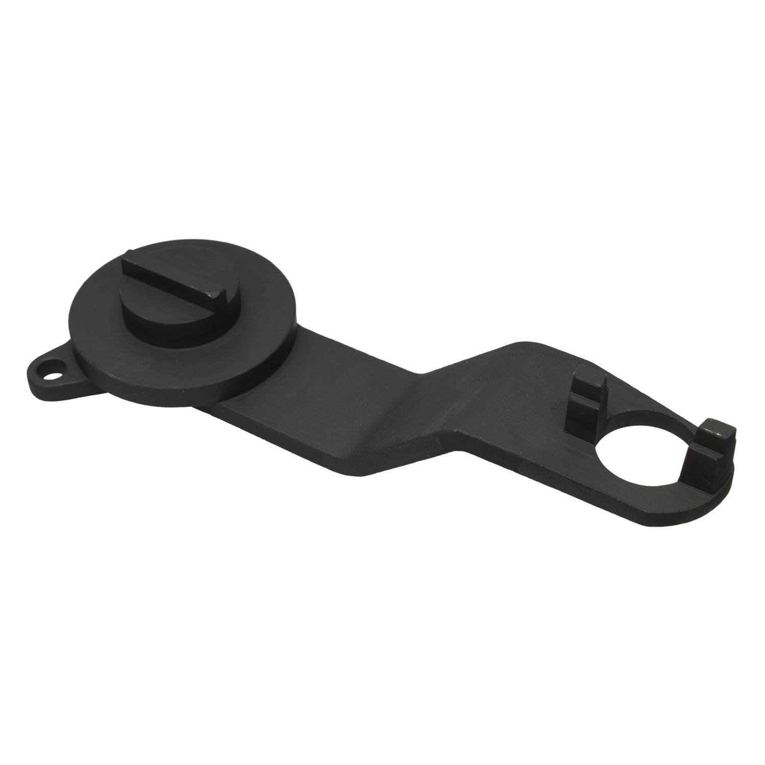

In general, the official tool looks like this:
! NOTE !: Only for EA211 1.2 TSI CJZC/CJZD

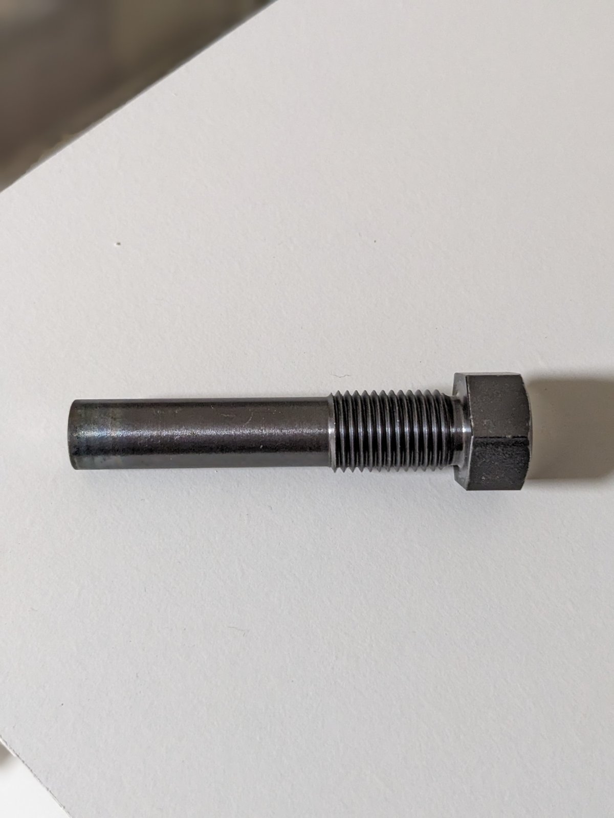

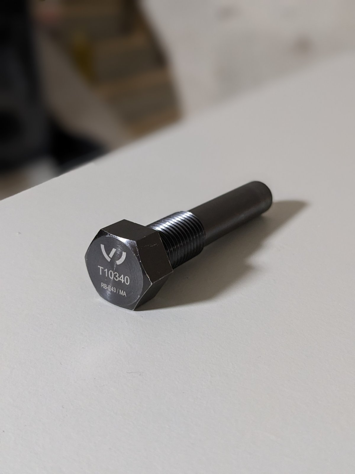

Also, concerning the locking tools, I found a spanish resseler few days ago, selling an official T10340 crankshaft locking tool.
For the price, it was worth the try as the parts looks almost brand new.
PXL_20260213_115123638.PORTRAIT (1).jpg (99.85 KiB) Viewed 30689 times
PXL_20260213_115146788.PORTRAIT (1).jpg (151.18 KiB) Viewed 30689 times

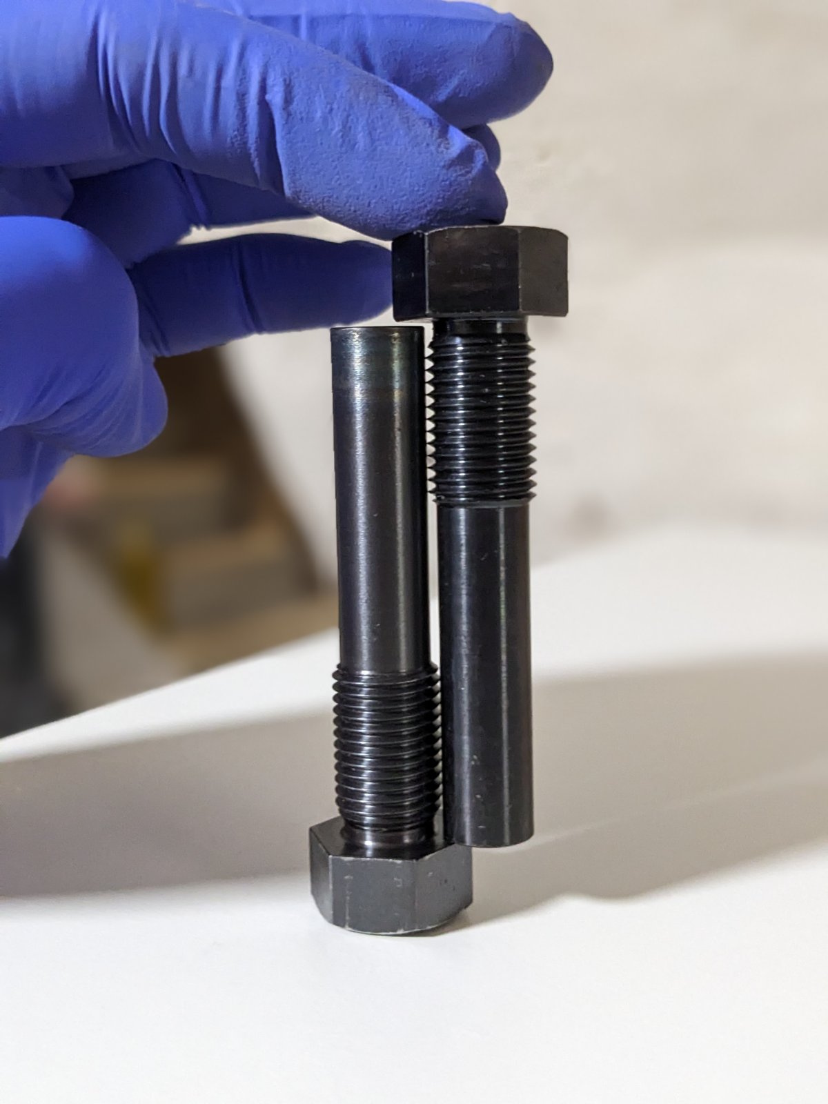

But I have some concerns about the lenght...which is a major value to lock correctly the crankshaft for the TDC position.

On the left, the VW official tool. On the right, the LaserTools.

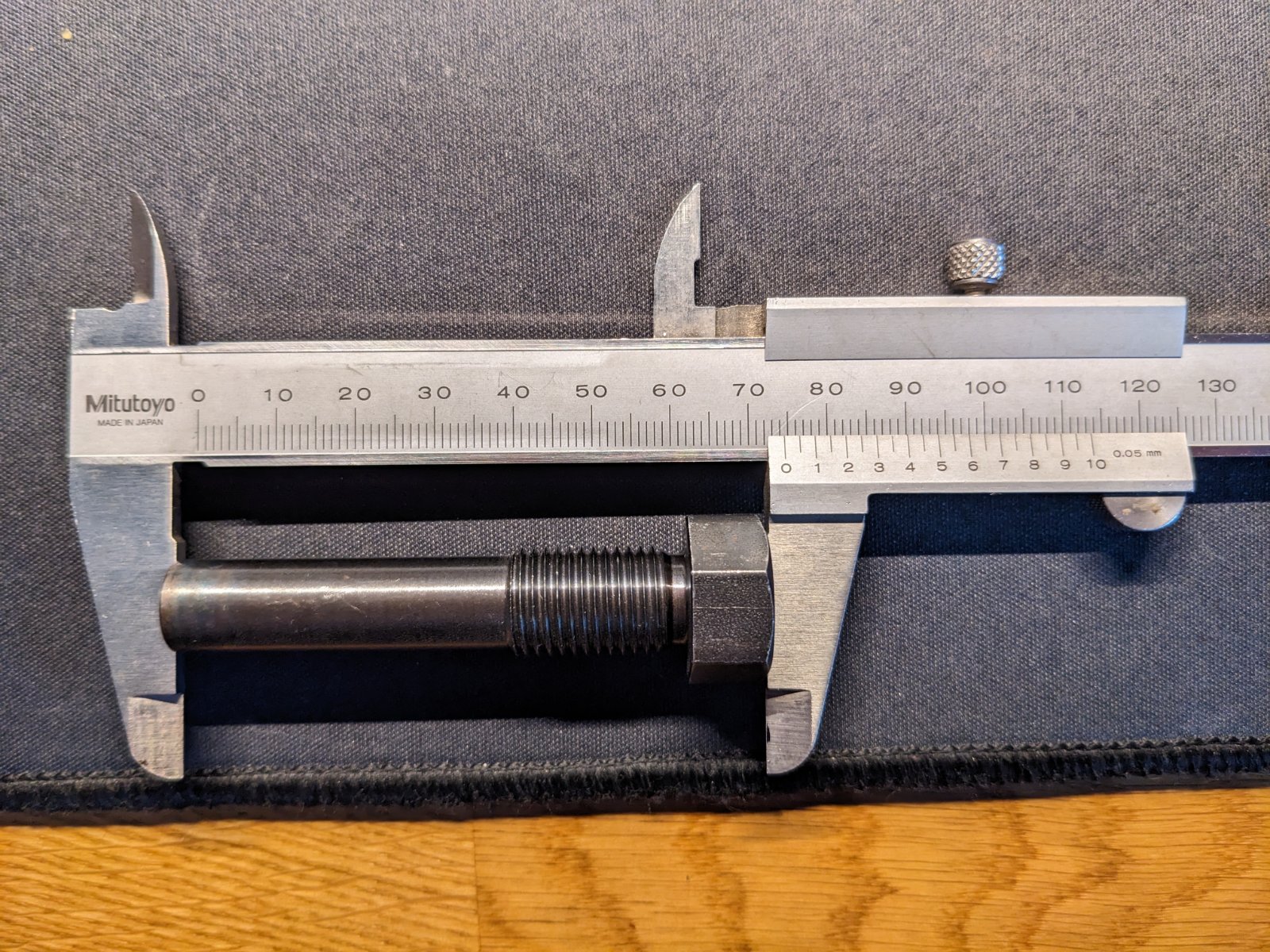

For some reasons, my T10340 is only 74.60 mm long and not 75 as it should be.
Also, the lenght between the bottom of the head of the bolt, to the opposite side, is only 64.50 mm.
The LaserTool measures 75.20 mm.
And the height under the screw head is 65.05 mm.
An other guy take some measure on it's own official VW T10340 and he founded 74.80mm, but it's one is a little bit worn.
So, how much should I be wary?
Posts: 6093
Re: EA211 timing belt
I'd trust the used genuine bolt although there is probably enough/spare space for the slightly longer bolt to screw into without "bottoming out".
