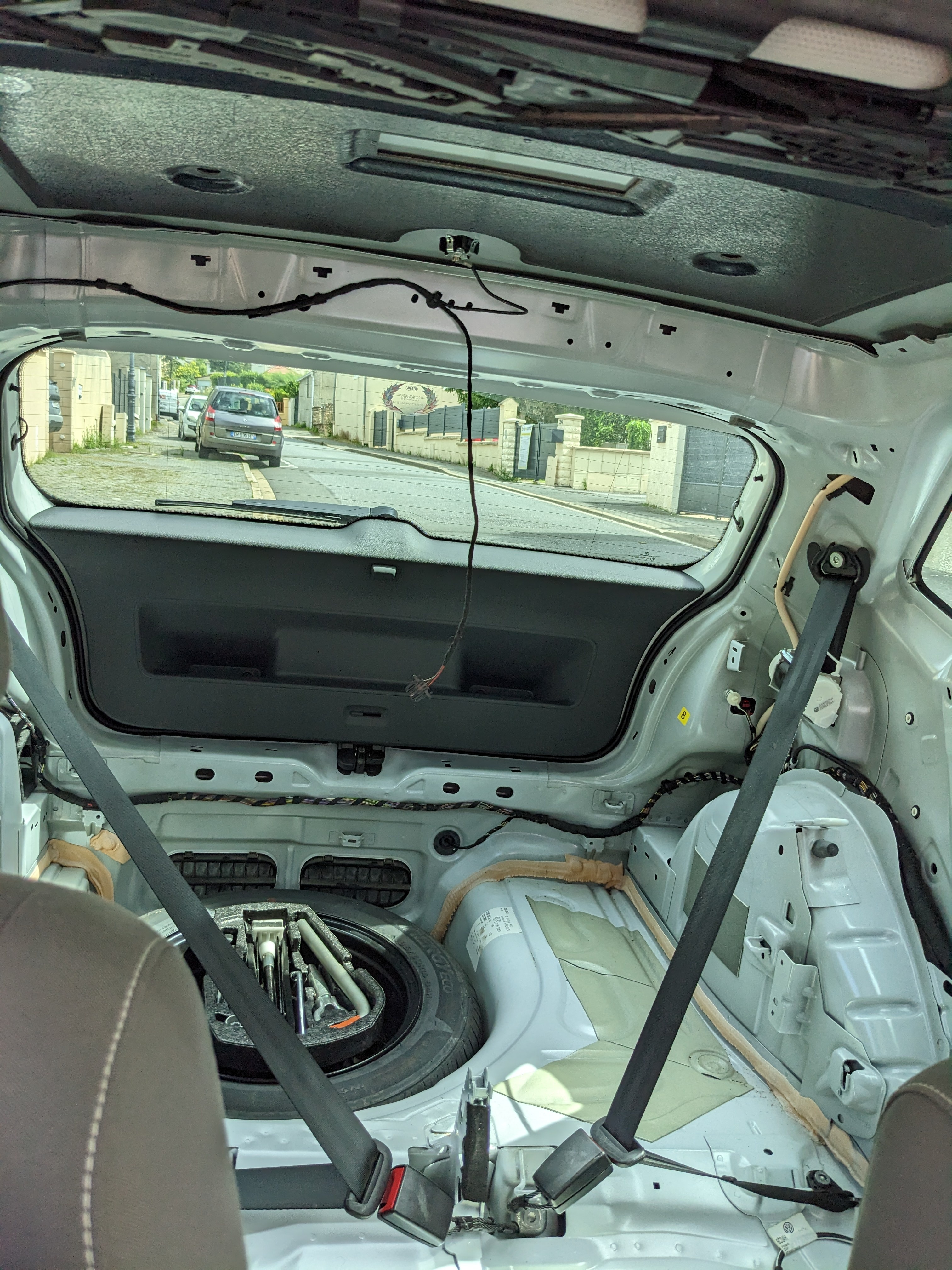

I think the most complicated part is the side of the trunk door (it seems very narrow).
Posts: 9037
Re: Polo 6C: wire harness damaged (boot)
Yes, the curve at the bottom (in the image) might be the trickiest part, be patient, go back and forth little by little. Easy for you!👍

But, I have a question, how are connected the rear windows heater (they is two black solid wire on each side) ?
Only the side lower trim of the trunk need to come out or also the C pillar ?
I have only one photo of this area, but it's hidded by the belt.
Posts: 9037

ciclo wrote: Thu Feb 19, 2026 7:58 pm Imageenlaces permanentes de imágenes
More images here: :arrow: viewtopic.php?p=608321#p608321
Okey so a little bit of a mess...hmm I will have to way with temporary repair until the nice and warm days will be back.
Posts: 9037
No, it's easier than it looks in the picture. The apparent mess in this 'old image' is because my 6R is overloaded with non-original wiring harnesses. :lol:
