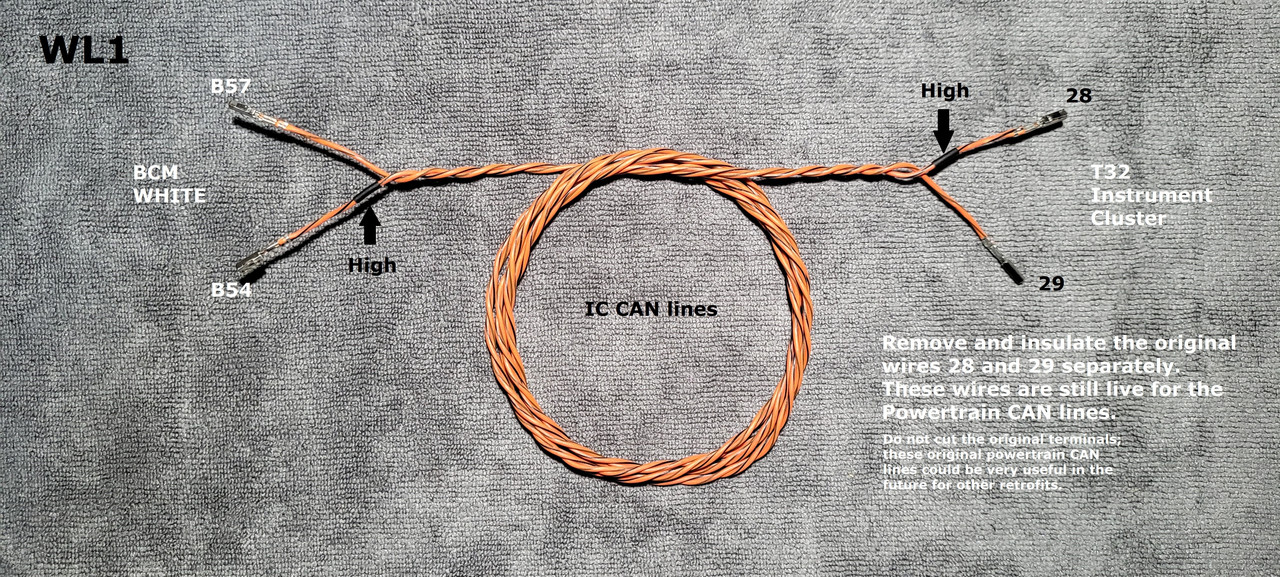

Hello ciclo,
Managed to find BCM Max 7E0937090C, I think the WL1 have to be done for it also, because there are the same symptoms like 7H0937090B. I succeeded to adapt it and adapt the remote control key I will paste the autoscan with it.

Yes, of course, you need to install WL1, etc.

Hello ciclo,
Thank you for the help with the WL1 scheme!

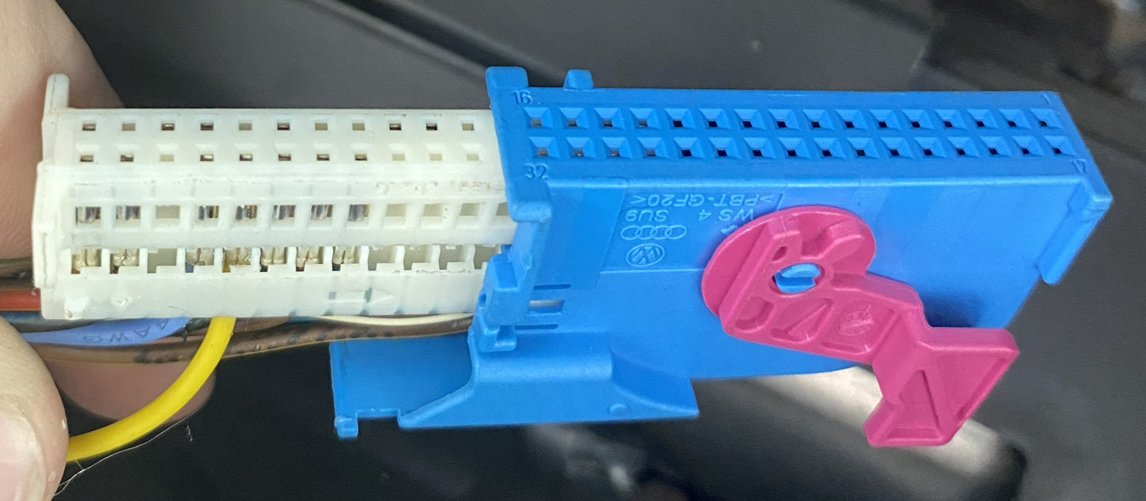

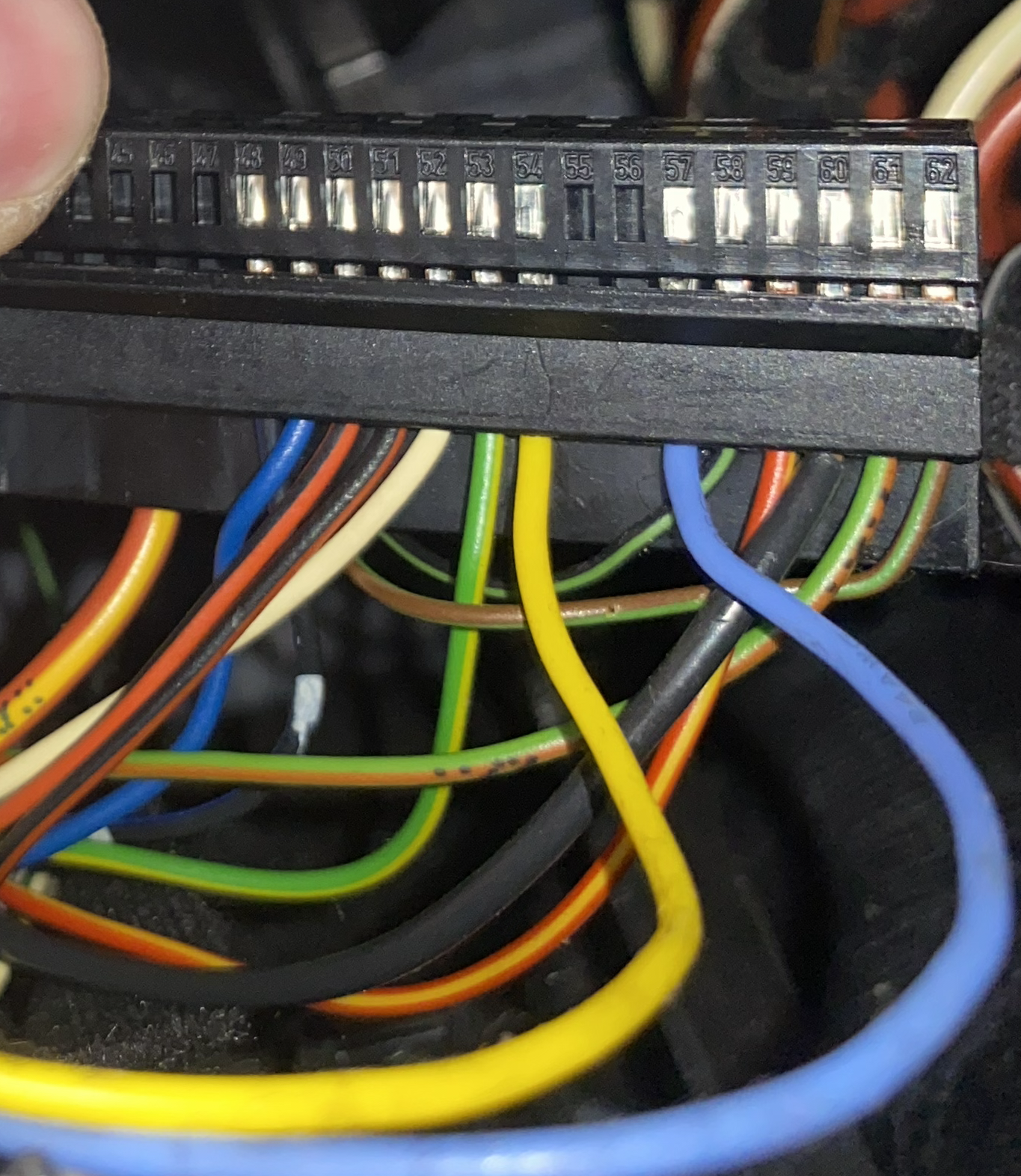

I managed to install the WL1 wiring and the BCM Max 7E0937090C. I used pins from Aliexpress because here in Bulgaria you cannot find such pins new. They look a little different from the original ones but they fits well and everything works as expected now (the window regulators buttons now are working :mrgreen:). Also, I used cables from Aliexpress and they look soft and inside the wires are white (not copper colored if I can say that :D), but also I think they do the work for the CAN signals.
I do not know how you guys manage to work with the pins placement in the sockets at the place above the pedals (BCM sockets), I am reaching well with my right hand, but i hardly access with my left one, most of the time I worked with one hand :lol:.

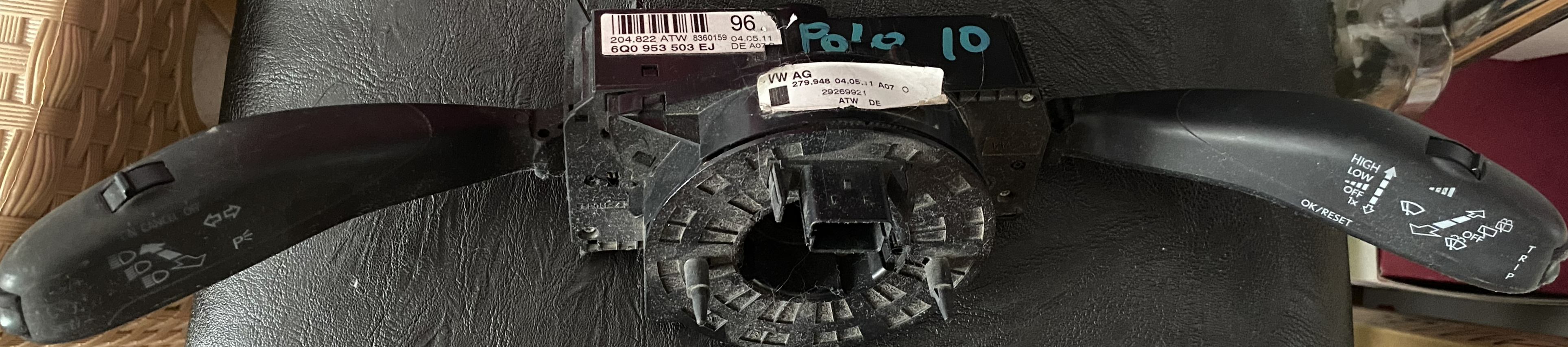

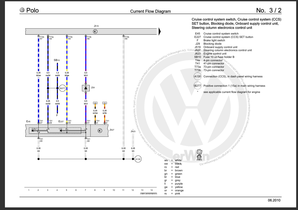

The next thing to retrofit before the Auto lights is the trip computer and cruise control. The question is that I have stalks from 6R:
I wonder if I can install stalks from 6C, but I suppose I can't because I couldn't find such with trip buttons on the right stalk? If I cannot install stalks from 6C, can I at least use the clock spring from my car? Also, I think I must follow the diagram from 2010 not from 2017:

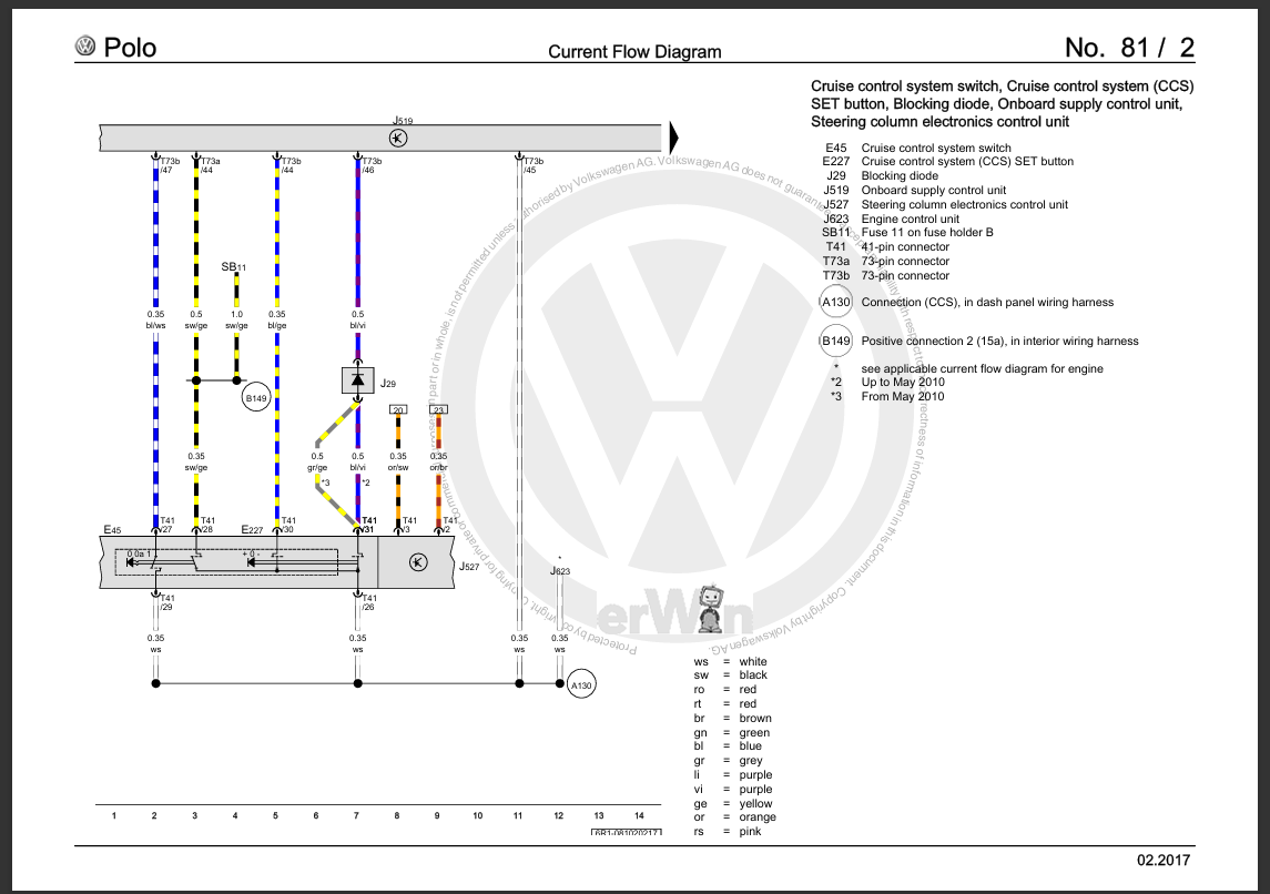

2017 for reference:
Screenshot 2026-05-24 121001.png (164.22 KiB) Viewed 5603 times
Both schemas look pretty similar to me, I do not understand what 20, and 23 stands for where T41/2 and T41/3 are going, also I am not sure that B149 and B277 from both stands for, I will be glad if you can answer on those questions.
Thank you once again for your help!

The 6C levers/stalks cannot be used on the 6R; they are electronically different.
You can and should use the steering slip ring with G85 sensor (clock spring... wtf... 🤷‍♂️?🤭) from your 6R.
The diagrams are the same, the legend on the right identifies the components.
- The orange wires are already present in your car with ESP. (powertrain CAN Bus).
- Connection (Bxxx) is the +15 positive signal from the fuse box. You have to feed pin T41/28 with this new wire.

Hello ciclo,
Yes, it is slip ring sorry, my bad. Typing without thinking :D.
I have to place a new wire from T41/28 to the SB10 in that case? And if any case, there is a wire already there (for something else) I need to splice that wire and attach the 28 pin wire to it, if I understand you right?
Posts: 8975
Re: ivanv's Polo 6R 1.6TDI 75hp 2010 Introduction + Retrofit journey
Yes.👍
