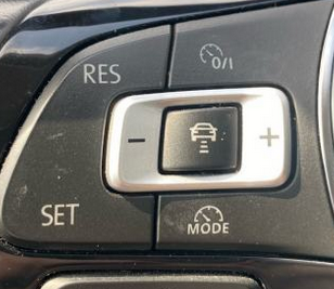

Im looking at buying a 2022 (or newer) polo 1,0 tsi manual. Unfortunatly im a bit of a feature geek and really want adaptive cruise control, however im finding it difficult to tell from photos which cars have it.
Ive noticed that there are atleast 2 different steering wheel button layouts (left middle button: CNCL or Car with lines) on cars that sellers claim have ACC.
Does anyone know there is a connection between button layout and the car having ACC or not? or are there any other easy ways to tell from photots?

The middle button on the L/H side of the steering wheel should have the diagram of a car and the horizontal lines if a car has ACC.
