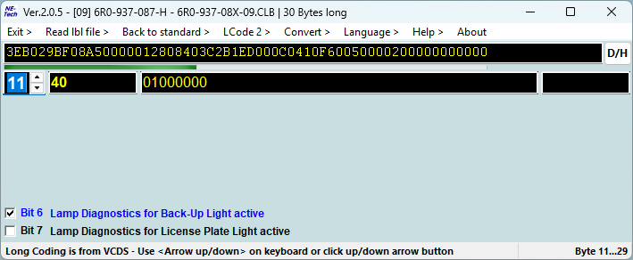

For the reverse/backup light, test to enabling Byte11 Bit4 BCM, clear DTCs, and rescan to see if the fault returns (it will depend on your BCM software).

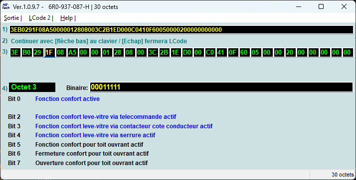

In french sorry but its enabled on my side Bit 2 Comfort function for power windows via remote control active
5 6 7 is for the sunroof

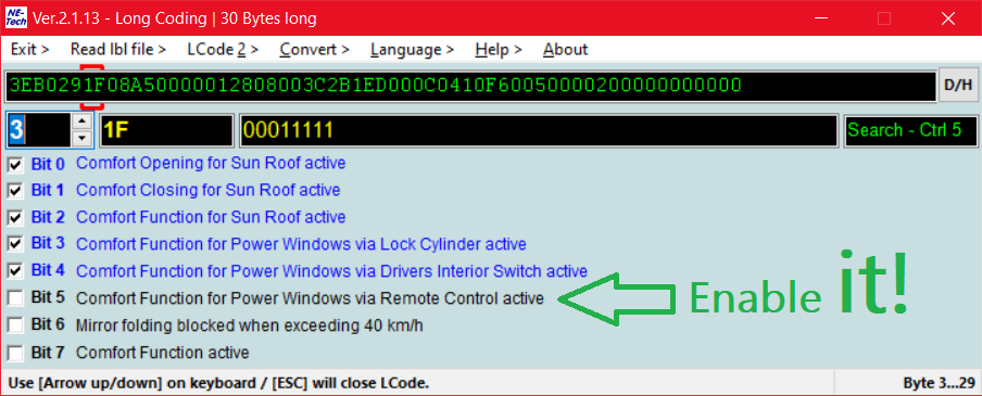

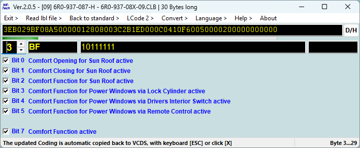

Okay, code the hexadecimal to 3F, the binary should look like this: 00111111.
Your VCDS is misleading you...🤭

Ohhhh ok… i’ll try tomorrow, this is strange do you know why?
Also do you know where I can put VCDS in English mode :?
Posts: 9037
Re: Can't roll the windows up or down with keyfob anymore
Whoever transcribed the bit definitions for the VCDS label in French was having a bad day...
If it's the original, you just need to download the program from ross-tech, otherwise, you'll have to search in other forums dedicated to these matters.🤷‍♂️

i can confirm that i wanna kill the guy who made the translation on VCDS for the french ppl :lol: :lol:
anyway, i download VCDS in english and tadaaaa everything is working now, i can now roll my windows with the key like before !
About the reverse light, i tried but... nothing on bit4, tried bit6 but still have the DTC about that. Nothing to worry tbh it's going to stay like that :wink:
Thx Ciclo again !!

Real image from right now...
...I'm not kidding, well, the Alien is just a logo.
