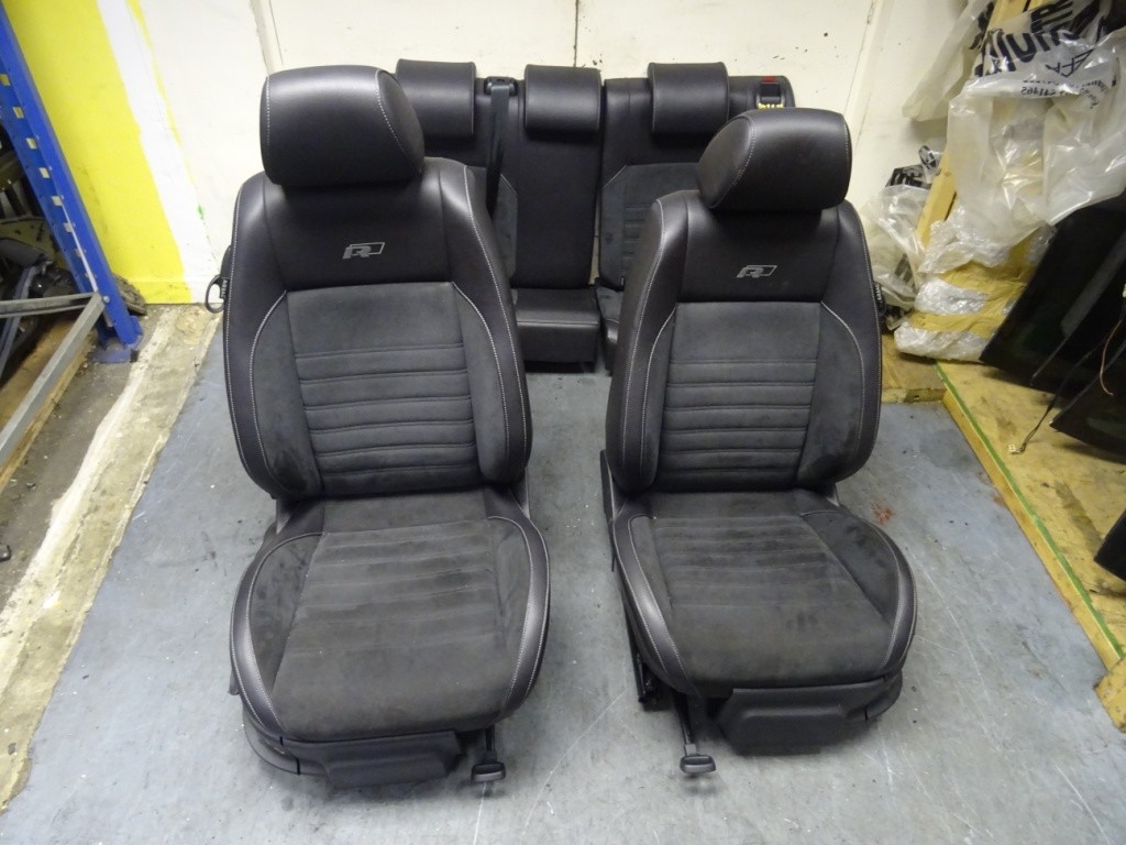

Hello,
I have managed to track down and purchase the elusive R Line leather interior with door cards for my car :D
This means I will be retrofitting heated seats next week after I pick them up, just in time for winter.
I was looking at the wiring diagram in ciclos post about heated seats but it makes no sense to me. I will be using the Kufatec loom. Which wire goes where :?: :?:
If someone could just draw on the diagram what to plug into where, i will be forever happy.
