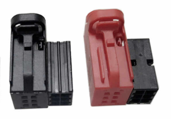

My car had 7 switches in dashboard. 4 Dummy buttons and 3 factory fitted switches namely ESP, Defogger and Hazard
It was sore to look at these dummy switches. So wanted to change them to actual switches namely - Left Heated Seat, Parktronic, Auto On Off and Right Heated Seat and make them illuminate like rest.
Got 3 switches from NL from used car dealer and 1 brand new from Russia. Procured housing but they were not for individual with suffix A,B. So only inside connector could go in switches.
Here is how the pins are arranged.
1 - 4
2 - 5
3 - 6
Above connector has flat and groove pattern on top and bottom.
viewtopic.php?f=56&t=64354&start=15#p540747 though mentioned which button needs to be fed power, I somehow stored pin 3 and pin 6 in my memory and kept on checking. I removed all wire connectors from the 4D0971636 except wire at 3 and 6.
To get desired output ie illumination, took one switch at a time and inserted connector and :
1. Checked if it illuminated. (Pin 3 +ve and Pin 6 -ve)
2. Reversed polarity and checked (Pin 3 -ve and Pin 6 -ve)
3. Reversed connector and checked (Pin 1 +ve and Pin 4 -ve)
4. Reversed polarity and checked. (Pin 1-ve and Pin 4 +ve)
To check all are working, I just checked if they illuminate but did not note down pins and polarity.
So ended up doing this exercise few times
This connector slides in plastic housing with notch displayed. Factory fittings has grooves on top.
However in reality it goes upside down.
So if you get pin configuration right and then insert in cover to latch in switches, then all connections have become wrong
Anyway with enough playing like kid figured the pins.
1 - 4
2 - 5
3 - 6

Compartment at the passenger side.
This is quite straight forward, however it needs force to pull/push the plastic parts.
Here is how it looks after original panel is removed. Here is after it is replaced with one which has compartment Part Number is : 6R1863482 -- which is for LHD
