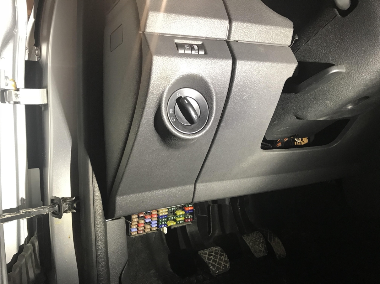

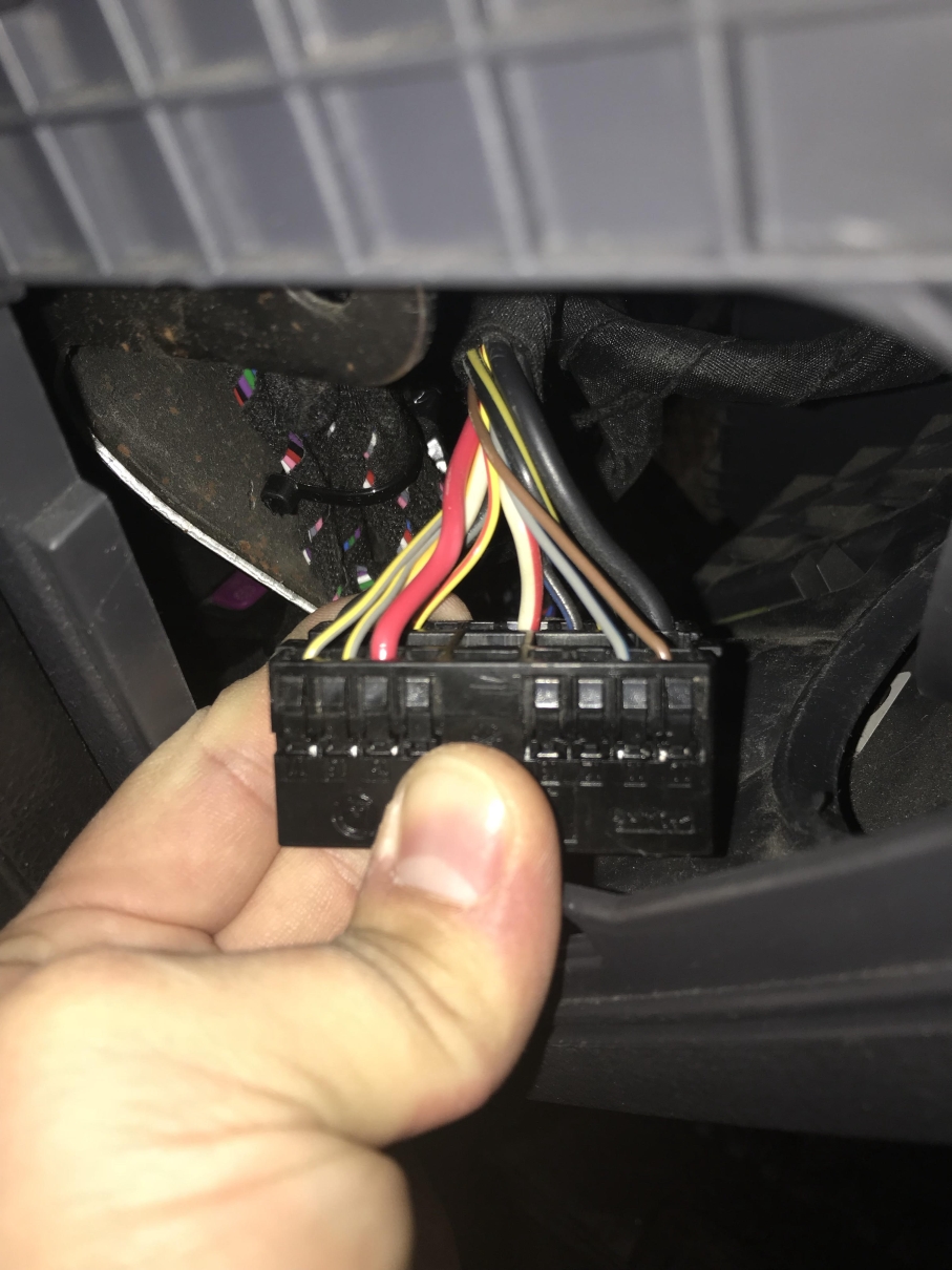

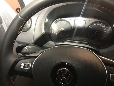

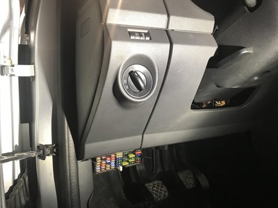

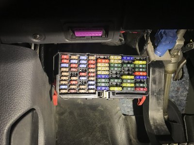

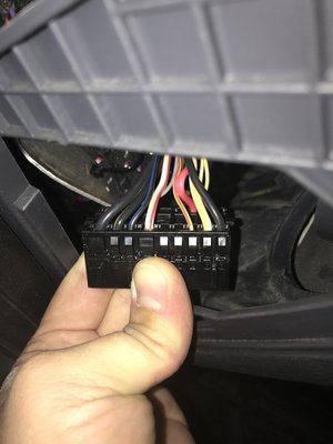

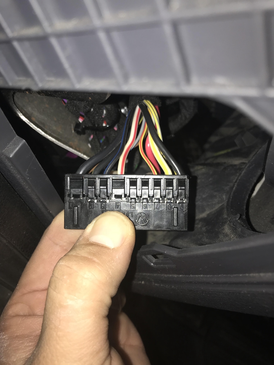

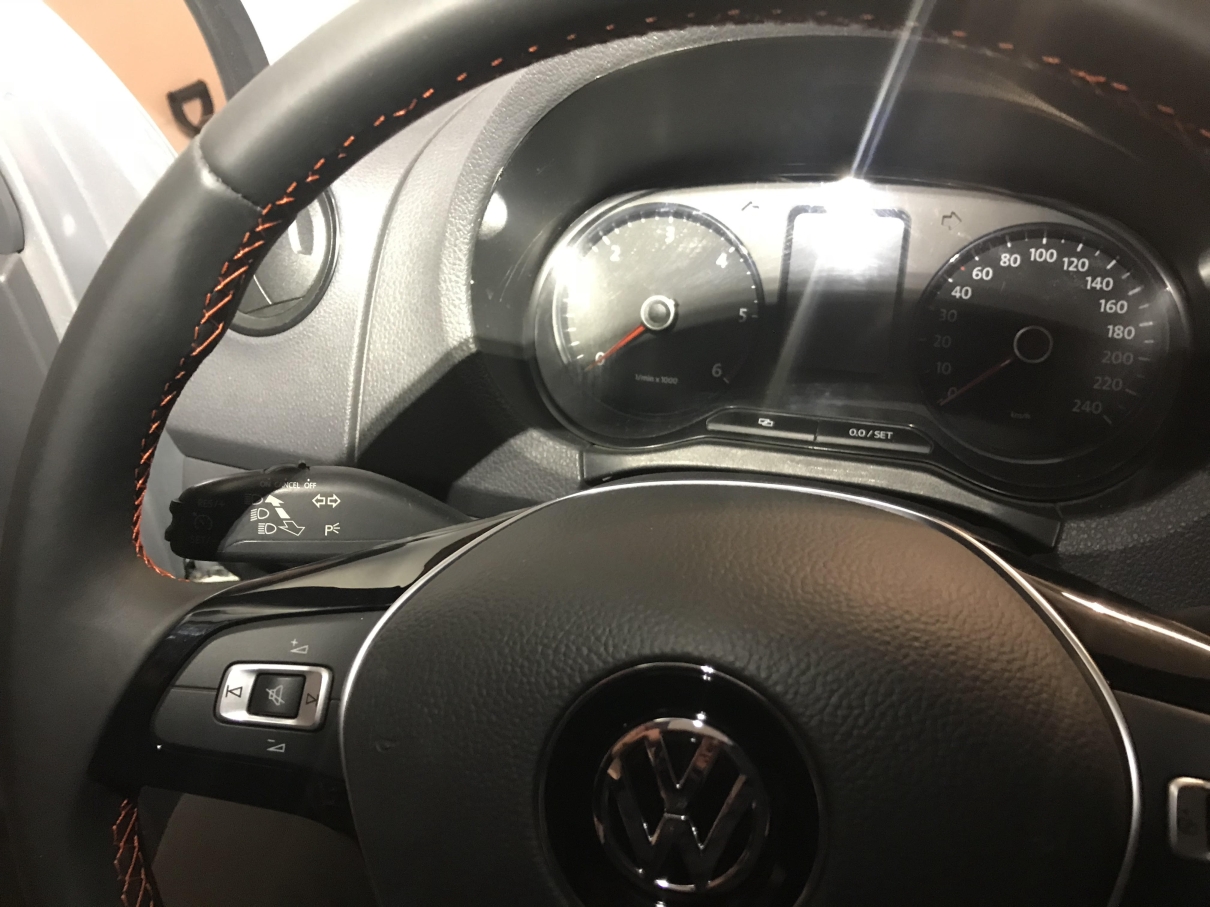

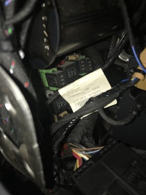

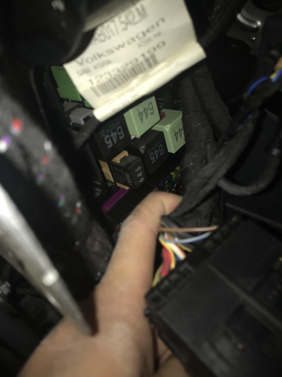

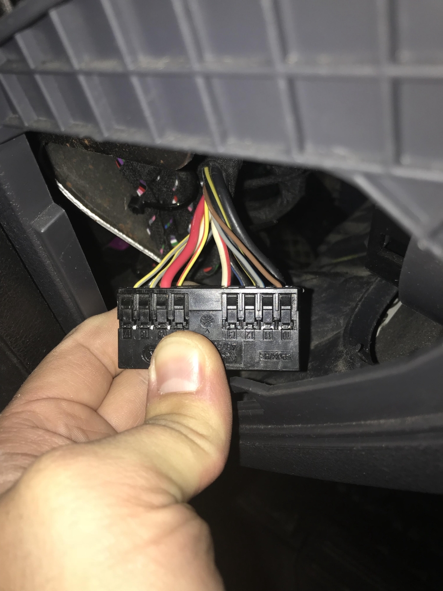

I have taken the photos. The BCM is a little hiden, on the lateral of left side pillar. The part nummer of cruise control/signal lever is 6Q0953513AM9B9
- Posts: 8836
Re: Amarok Oem Bixenon retrofit
Thank you very much for all these images.
- T17 connector reveals that your Amarok is prior to January 2013.
- Your fuse box is 72 positions/fuses -June 2012 to January 2013-. From January 2013 the fuse box is 68 positions/fuses.
I apologize for my comments about it ...
Yes, your Climatic will work with the newest BCM.

To summarize and as I mentioned, those diagrams are not correct for your Amarok.georgenis wrote: Wed Feb 07, 2018 9:41 am I have the electrical wiring of my car. It is from Vw service special for my car.
https://drive.google.com/open?id=1LD1nu ... GEDACyyU7P
Well, I have researched a little more thoroughly and the F and G modules for DRLs are interchangeable. It was hard to find it.georgenis wrote: Thu Feb 08, 2018 6:24 am The 4G0907697G modue are also in Golf 7 Bixenon Led Afs headlights (I'm sure of that because I have changed one in my car). Maybe You can compare the wiring to see if they will work. I don't want to invest much money in something that will not work for sure. If I buy the BCM, I cannot return it. Second-hand I didn't find it.
The newest BCM will work with my "Climatic" air conditionning?
)Yes, your Climatic will work with the newest BCM.
