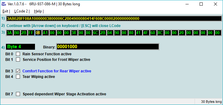

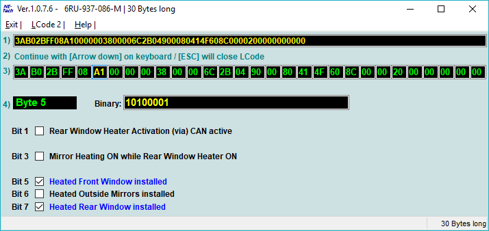

So I think I'll correct myself and say it is compatible, but the coding wasn't very successful. Perhaps this will work:
3AB02BFF08A10000013800006C2B26900080414F608C000020A000000000
This way, the RLS is installed (byte 8 to 01) and the rain sensor and automatic wipers are activated.
I suppose you could enable the light sensor function as well (byte 13 from 2B to AB), but I doubt it will add any functionality.

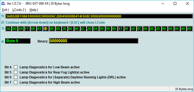

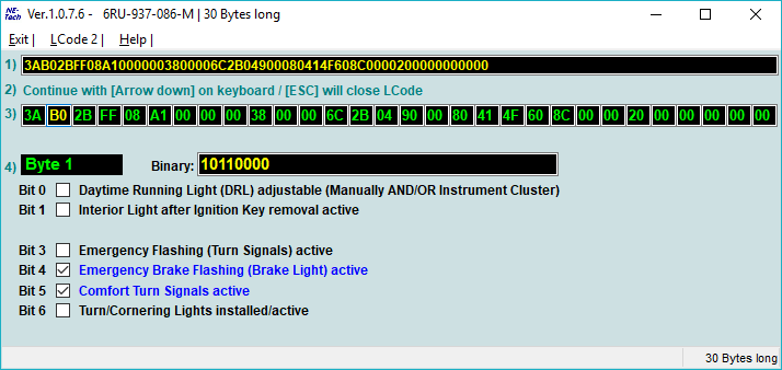

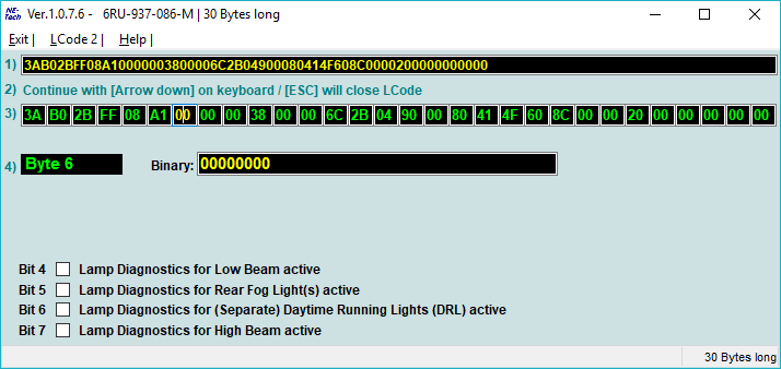

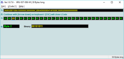

Re: Polo 2015/16 Auto-dimming mirror - RLS - Long Coding

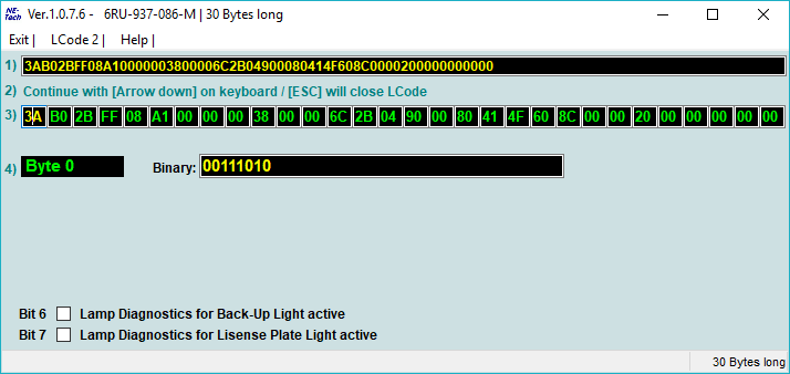

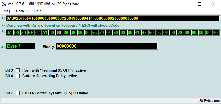

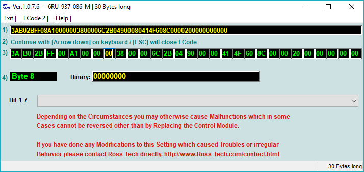

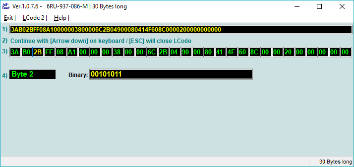

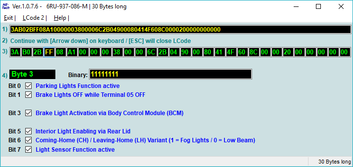

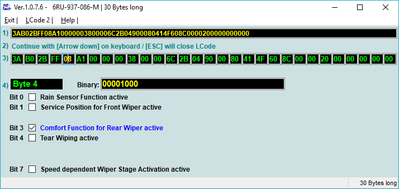

When I looked at VCDS today, long coding position that you suggested is different than what is shown by VCDS helper. RLS is at byte 4 position and byte 8 position shows error. Now, I'm confused and want your opinion before proceeding with making changes.
Scan report
here are the vcds helper screenshots.

more screenshots...

iichel - can you please advise me?
- Posts: 6685
this is not making any sense to me. the info in the label does not match the label itself. is your VCDS a clone?

do thisiichel wrote: Thu Aug 30, 2018 2:48 pm So I think I'll correct myself and say it is compatible, but the coding wasn't very successful. Perhaps this will work:
