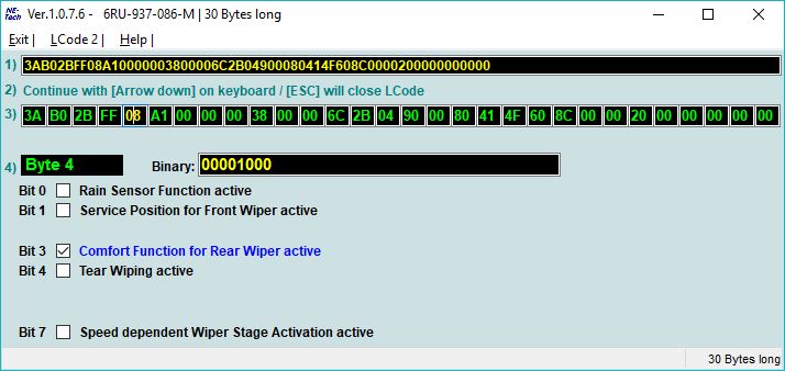

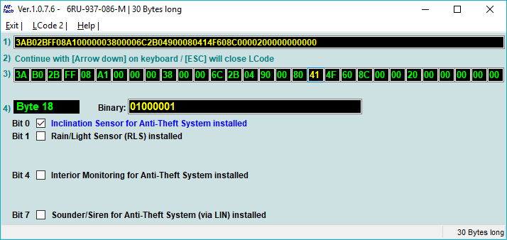

So I think I'll correct myself and say it is compatible, but the coding wasn't very successful. Perhaps this will work:
3AB02BFF08A10000013800006C2B26900080414F608C000020A000000000
This way, the RLS is installed (byte 8 to 01) and the rain sensor and automatic wipers are activated.
I suppose you could enable the light sensor function as well (byte 13 from 2B to AB), but I doubt it will add any functionality.

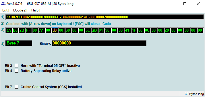

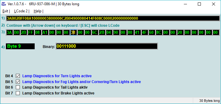

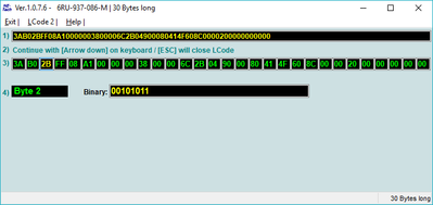

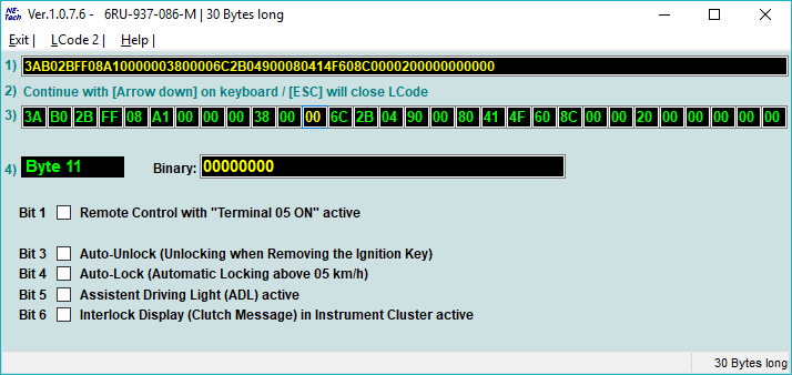

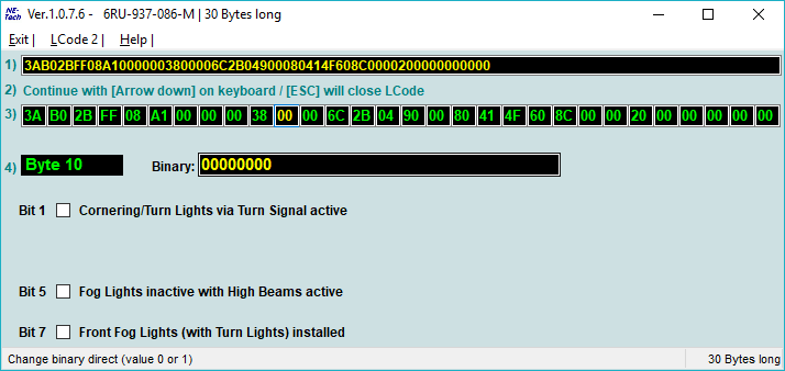

TDITorque
Posts: 18
Joined: Fri Jun 01, 2018 1:32 pm
Drives: Polo TDI 1.5 (2015)
Location: Mumbai - India
Re: Polo 2015/16 Auto-dimming mirror - RLS - Long Coding
Post by TDITorque »

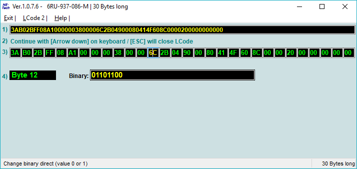

Last time while enabling RLS using VCDS Long Code Helper, somehow long code got changed to B02B7F09A1000000380000642B04900080414F6080000020000000000000 and all body control electricals (horn, window up-downs, steering controls) stopped working. I am still puzzled as to how long code changed so drastically (I used long code helper and didn't tweak much).
When I tried restoring the older long code saved in earlier scan report, VCDS says Coding Accepted but the entered code was not reflecting. Do you know what could be the reason behind that? I do not want to get into same trouble again and want to take experts advise before reattempting it.
Many thanks for your prompt replies!
Posts: 6687
Could you please try the coding I provided and tell the results?

TDITorque
Posts: 18
Post by TDITorque »

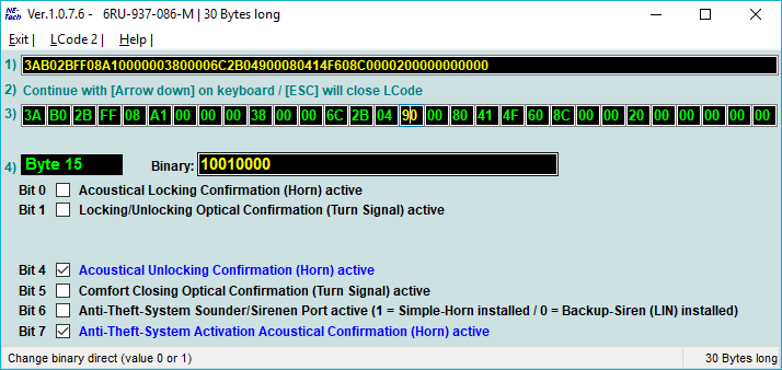

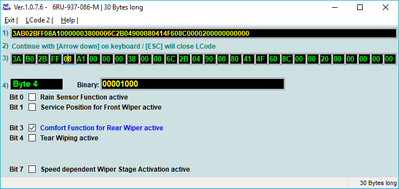

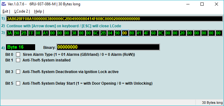

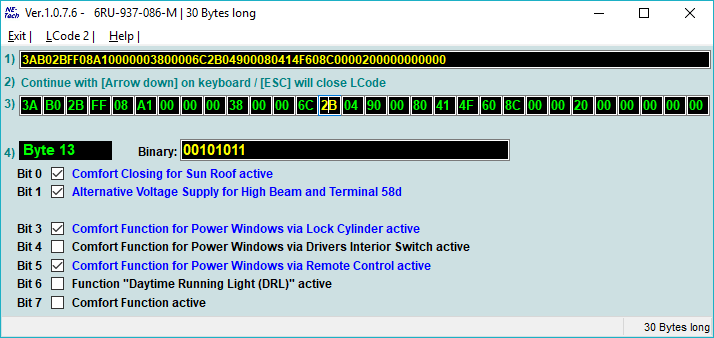

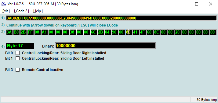

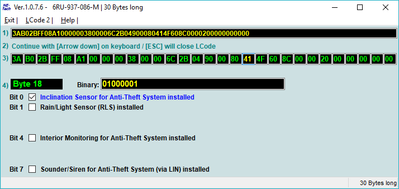

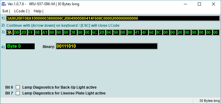

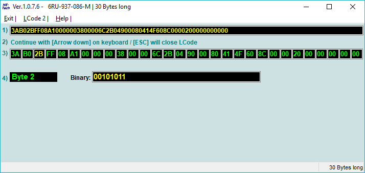

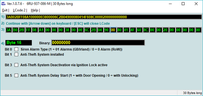

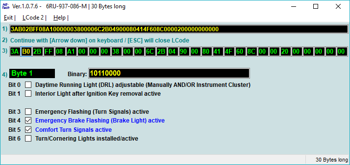

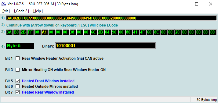

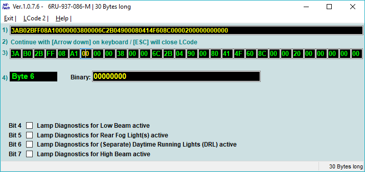

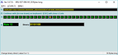

When I looked at VCDS today, long coding position that you suggested is different than what is shown by VCDS helper. RLS is at byte 4 position and byte 8 position shows error. Now, I'm confused and want your opinion before proceeding with making changes.

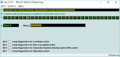

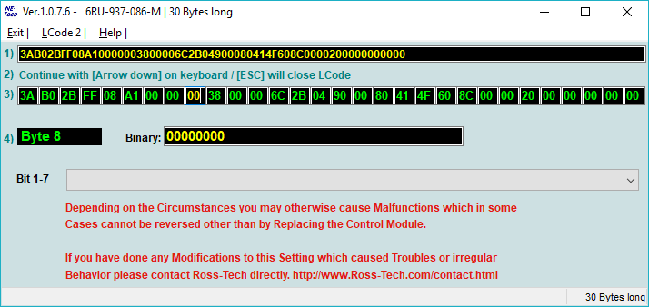

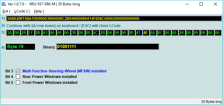

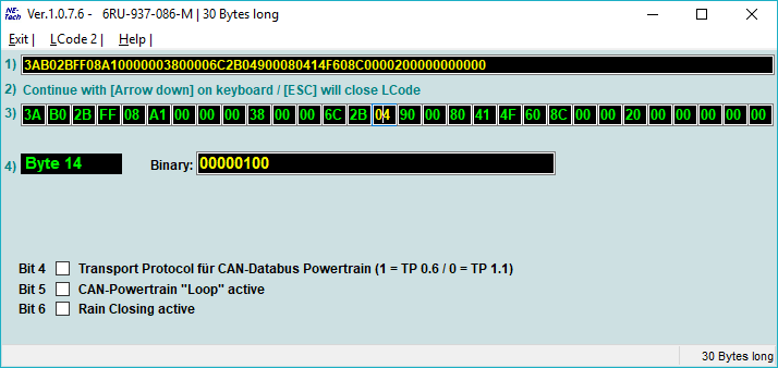

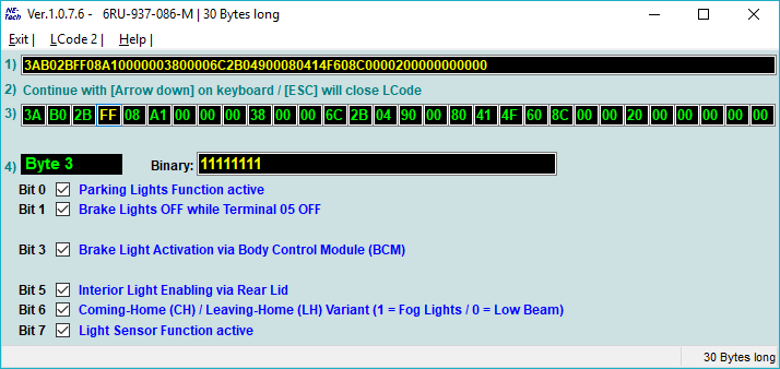

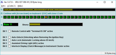

here are the vcds helper screenshots.

more screenshots...

iichel - can you please advise me?
Posts: 6687
this is not making any sense to me. the info in the label does not match the label itself. is your VCDS a clone?
TDITorque
Posts: 18
Post by TDITorque »
I'm using a cable bought from AliExpress. Do you think its cable issue or something is wrong with my BCM?
Posts: 6687
iichel wrote: Thu Aug 30, 2018 2:48 pm So I think I'll correct myself and say it is compatible, but the coding wasn't very successful. Perhaps this will work:
do this
TDITorque
Posts: 18
Post by TDITorque »
I tried updating the long code with 3AB02BFF08A10000013800006C2B26900080414F608C000020A000000000 and it got saved.
but when i viewed it again it was saved as - B02B7F09A1000000380000642B04900080414F6080000020000000000000 - strange!!
Needless to say everything (horn, window up-downs, steering controls etc) stopped working immediately after making the changes. :cry: :cry:
Posts: 6687
throw away this cable and buy a proper one
