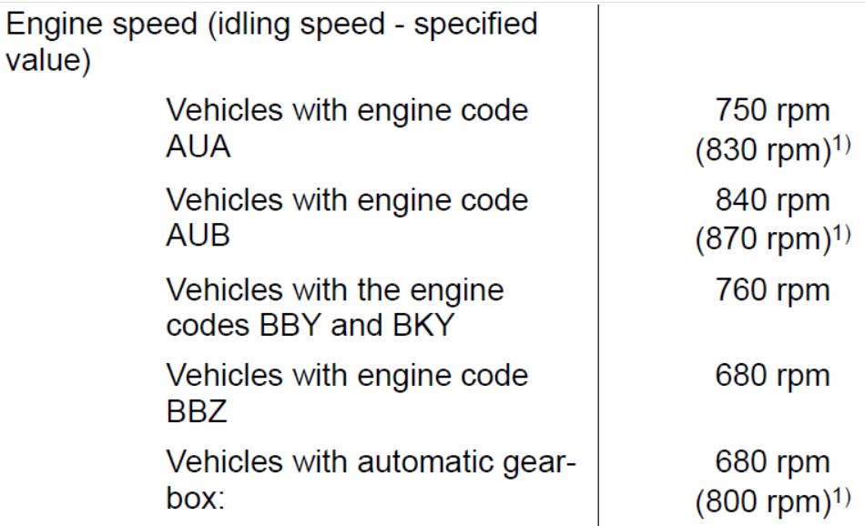

I guess it varies a little with engine type,ours is an AUB,this picture taken today.
This is a link to a thread on the skoda forum - I have not read it all but Wino posted this list of engine codes and idle speeds,assuming they are similar to polo specs.
https://www.briskoda.net/forums/topic/4 ... ridle-rpm/

Ah, my BBY is an auto box which might explain the slightly lower tickover.

I would imagine that a lower idle speed on an Auto is quite desirable - cuts down on the 'Thump' and 'Creep' when drive is selected.
