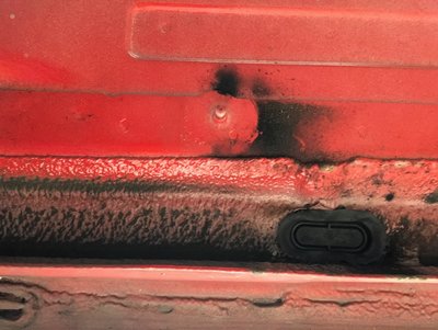

Post by Lester »
I removed the underbody trim to check if the welded nut will be exposed but unfortunately, it's not there.
underbody
underbody
I am now thinking of cutting open the carpet and cut a hole with a hole saw so I can hold the welded nut with pliers and remove the bolt. If you have a better idea than this, please let me know. Thanks.
