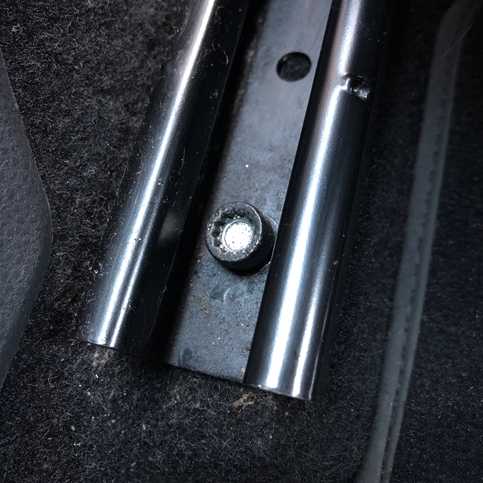

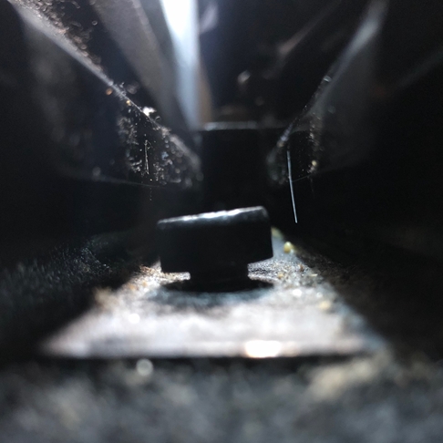

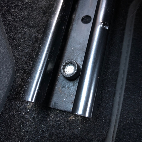

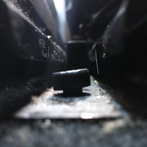

There are four 10mm triple square bolts holding the front seat.
Starting from the back, I have successfully removed the one on the right. It has thread locker so it was very tight.
I could make a few turns loosening the left bolt but it suddenly got very tight. At this point, I felt that there was a problem. I switched to a breaker bar and after turning, it seems like the bolt snapped. Now, I cannot tighten or loosen it. It will just keep on spinning.
I don't think there is a nut holding it underneath so I'm not sure what is. I used a flat screwdriver to pry it upwards and at the same time loosen it but it does not work. Anyone had the same experience removing front seat bolts. Any tricks or suggestions that I can try? Thank you.

I looked at the Polo floor assembly and I think I now know what happened.
The triple square bolt goes to a welded nut in the seat support where the seats are bolted.
It appears that this welded nut came off leaving me with a spinning screw. I won't be able to remove it unless I find a way to hold that nut.

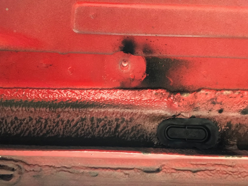

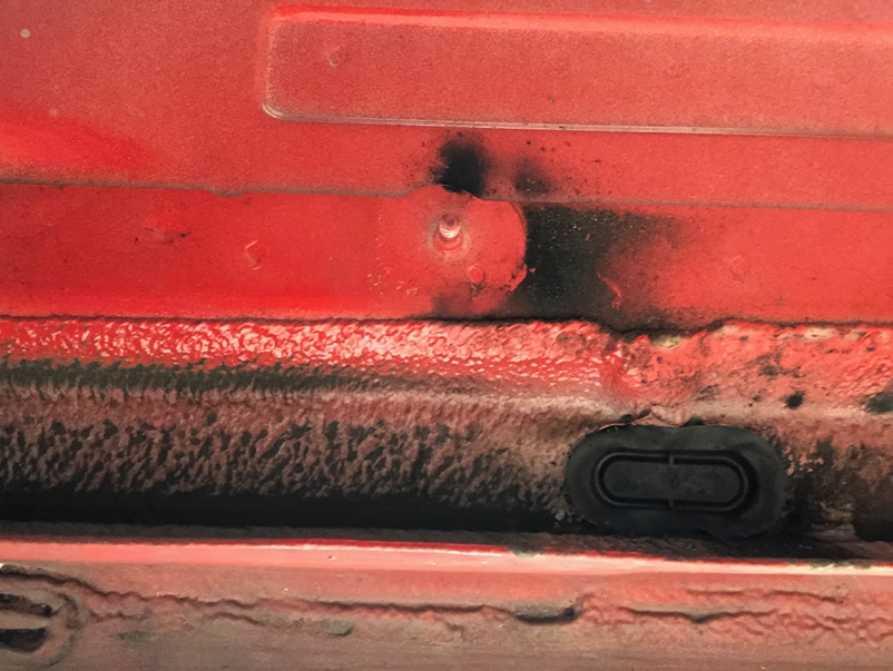

Re: Loose Bolt While Removing Passenger Front Seat
I removed the underbody trim to check if the welded nut will be exposed but unfortunately, it's not there.
I am now thinking of cutting open the carpet and cut a hole with a hole saw so I can hold the welded nut with pliers and remove the bolt. If you have a better idea than this, please let me know. Thanks.
