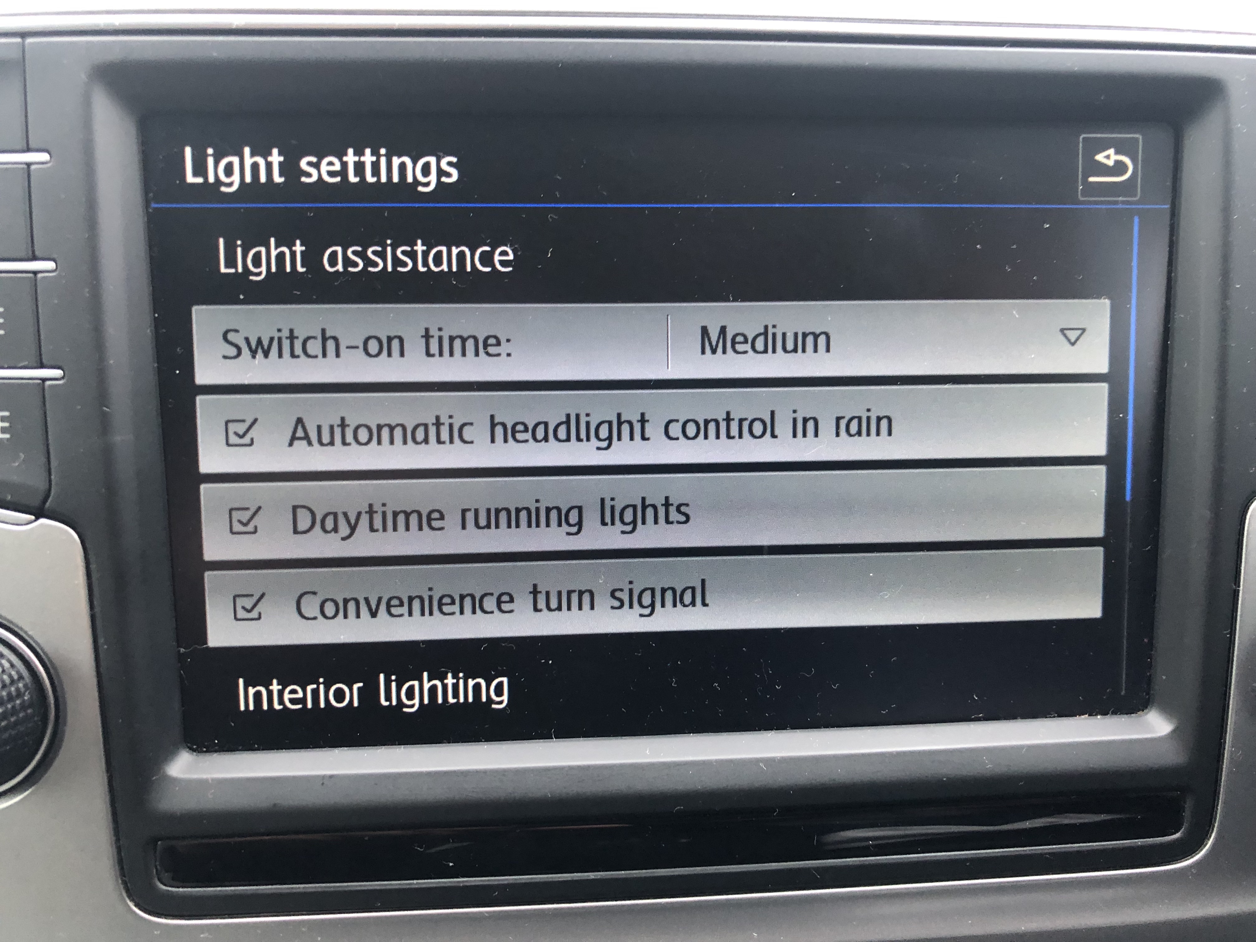

to enable the drl menu that enables or disables the drl lights the following needs to be enabled:
Control unit: 09 Central Electrics:
Security Code (31347):
Adaptions:
Daytime running lights:
Tagfahrlicht Aktivierung durch BAP oder Bedienfolge moeglich: active
I disable the option and my drl lights turn off even with hndbrake down.
In car settings/light menu you well get this as seen on my polo:
Adaptions:

So you mean like each function setting has its own code assigned more like eg a room full of lockers with perhaps one thing in each and each having its own key to put it allegoricaly??
- Posts: 8974
Re: Drl menace reduction
With the security access of a unit you can modify the data.
These data have, the specific factory setting for the equipments installed in your car, and more data that are used in other level of equiments and that maybe also can be used for your car.
It's very simple once you use it.
