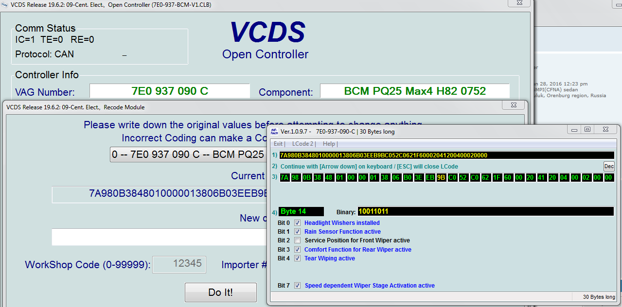

Good evening my friend, tell me please , today we have very rainy day here in Greece , so I found out that lights(on) washer system do not function.
In vag com no errors or faults , I made out put tests in address 09 in washer pump relay and everything looks ok .
Is it possible washers pump became out of service ? What else to look ?

Good morning my friend , the fluid level was max . Yes windshield washer system works perfect with lights on and of as always .
Stalks brand new. The problem is in headlights wisher system . They used to work only with lights on . Now with lights on works only windshield washer system .
Tell me is it possible to have differences between bcm high and bcm max in pin positions for headlight wisher system?
The matter that head light wisher system did not work, is something that I have not noticed until now .
Best regards
Vasilis

I have a suggestion. It is could be possible BCM has been reparametrised for headlights washer works not of each five windscreen washing but of each "long" windscreen" washing. I did that for mine.

Set the 42 adaptation channel of the 09 centr.electric to the value 1
Turn on the engine, switch on the headlights, pull the windscreen washer for at least 4 seconds.

firegrafik wrote: Fri Feb 21, 2020 8:28 am I have a suggestion. It is could be possible BCM has been reparametrised for headlights washer works not of each five windscreen washing but of each "long" windscreen" washing. I did that for mine.
It could be :lol: , but the value is 5 (as factory).
I made a log of the adaptation channels when I code it and loaded MKE in the Gateway. :wink:

Hello my friend, I did exactly what you told me, but nothing changes .
I put again the first value 5
What else must do to solve this problem.
Regards
Vasilis

It is not a matter related to adaptations or codifications, forget that.
Make memory and remember if you touched any electrical part related to the headlight wash pump when you made the headlight electrical installations or anything you did ...
Also check the condition of the pump and ducts.

Ok , I will do those checks , but tell me why I do not have false or errors in vag com ?
Posts: 8908
Re: Skoda Fabia VRS 2012. Auto lights retrofit OEM
Because the relay works and the pump cannot be diagnosed.
