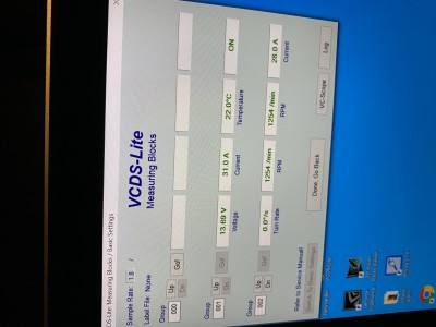

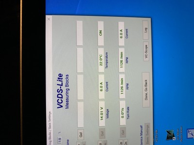

readins with wheel turned left and right and 2 other readings

only thing i noticed when i turned the wheel was the amps would go up? when fault light come on dash and gives a code in vcds couldnt clear it unless i switched engine off - then cleared it fine, the turning sterring wheel left or right fault light came on, wouldnt let me enter basic settings in vdcs - saying must register or something, so not sure how to get angle sensor readings

Current will go up as the pump will have to work harder the further you turn the wheel so that's normal
