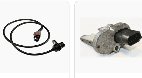

my sensor is like the right 1

just been reading too that there is 2 types of them sensors like mine, one is like mine which is black plastic one side and other side is clear, this was on my original rack, then there is a both black plastic sides one? which is for the twin vane racks? my old rack must have been a single vane, look like same connectors, if i fit the new angle sensor black both sides will i need a new pump to match or should it be ok?
ps come to think of it im sure i remember seeing 2 vanes on the shaft inside the sensor hole..

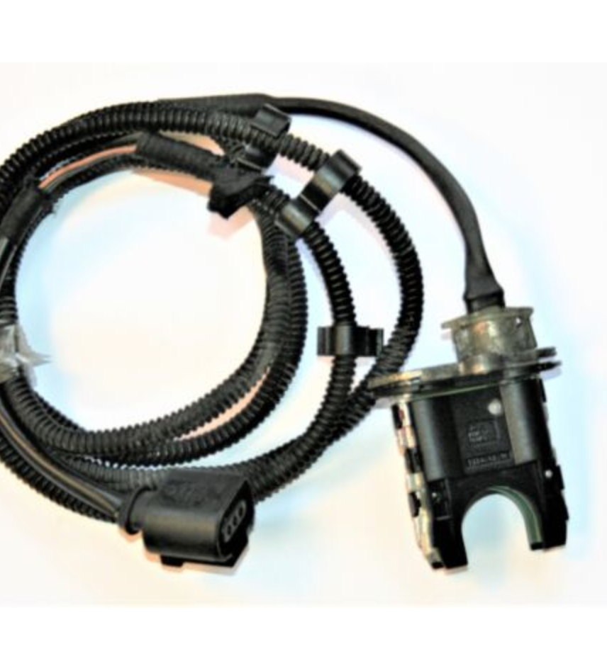

im thinking my rack needs this sensor?

cant see any numbers or make on rack might be under it which i cant get to unless i take it off. i took out the angle sensor and can confirm its got a single vane - the piece of metal that goes past the sensor when you turn the wheel, im still thinking it might need that double black both sides angle sensor?

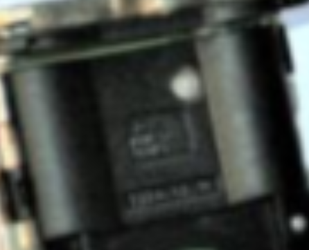

when taking the sensor out from the rack i noticed that inside where the sensor goes have like scored out slots - like where the correct sensor should go.. then looking at thave above sensor with doulble black sides it has the grooves on it to fit in the rack, the left hand fits but you have to force it it, maybe thats the sensor for the rack then?

changed the sensor to the correct one with the wires built into the angle sonsor with a plug on the end and fitted and light has stayed off, this angle sensor fitted very well as it was shaped to fit, the other one fitted but had to be forced in, when i got the steering rack it didnt have the sensor in it, they gave me the wrong one, so returned back there and they gave me the correct one, with the usual excuses, the sensor they gave me was cheeper than the correct one with the lead on it.. wonder why they gave me it..
